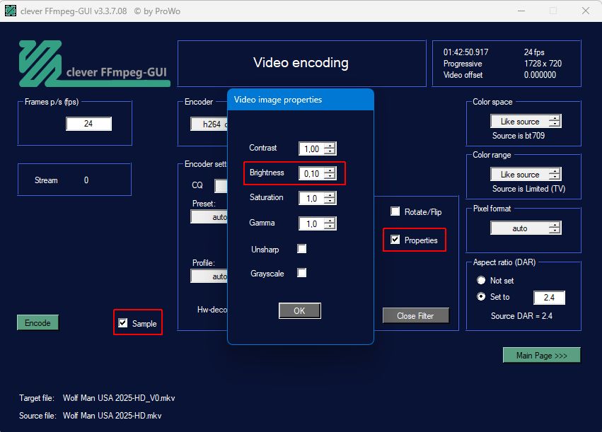

Use clever FFmpeg-GUI.
Increase brightness to 0.10 and encode a sample of 60 seconds to see the result.
You can also use the preview button.
[Attachment 85353 - Click to enlarge] -

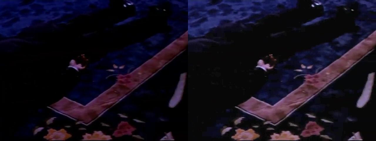

More artifacts than details there:
Tweak+Retinex:
=> imho: not worth the trouble for stuff that is also available on DVD
that would only be true when your source was losslessly compressed and just the gamma was a bit low,.. highly compressed, low resolution, the compressor will throw out stuff it assumes will not be shown anyways.So there shouldn't be any areas/pixels where it is pitch black with no details seen
Cu Selurusers currently on my ignore list: deadrats, Stears555, marcorocchini -
Yes, there hardly any detail in the dark areas to bring out. A gamma adjustment brings out a little detail in those dark areas but they are grossly distorted and artifacted by the compression.
[Attachment 85379 - Click to enlarge]
I think you're better off leaving them black. -
