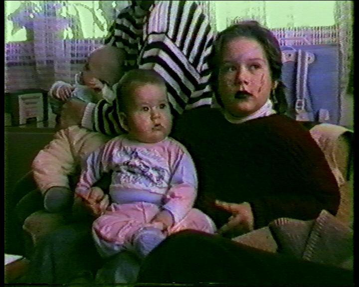

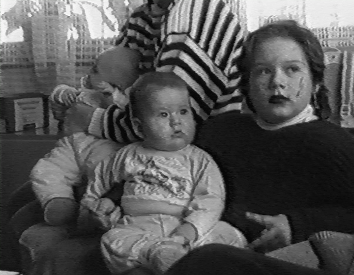

    Is there an automatic way that analyzes a video clip and kind of creates an automatic color correction preset? Something like a LUT.
    I have some clips with some wrong colors, for example:
    [Attachment 85324 - Click to enlarge]
    Just for fun, I loaded the image within Adobe Lightroom and tried to use the "Auto" mode to see what would happen, but the result was not really better.
    I also tried to set some white points manually, but this didn't also go well.
    These were just some quick and dirty tries to see if for video snapshots it would work as easy as for pictures.
    Now I'm wondering if there is some automatism to kind of get the colors right and the fine-tuning, if needed, I do manually.
    Any script/tool or that's a manual trial & error process all the way?
    Thanks.

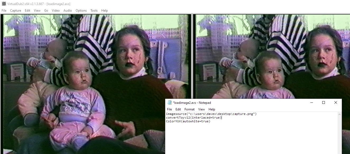

    ColorYUV with AutoWhte in an Avisynth script may be a starting place:

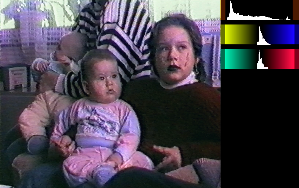

  4. It may be more pleasant to view it grayscale
    [Attachment 85334 - Click to enlarge]
    Manually you can try to align (center) the U,V channels to taste, observing the histogram:
    converttoYV16(interlaced=true)
    coloryuv(off_u=6.0,off_v=3.0)
    histogram("levels")
    [Attachment 85335 - Click to enlarge]

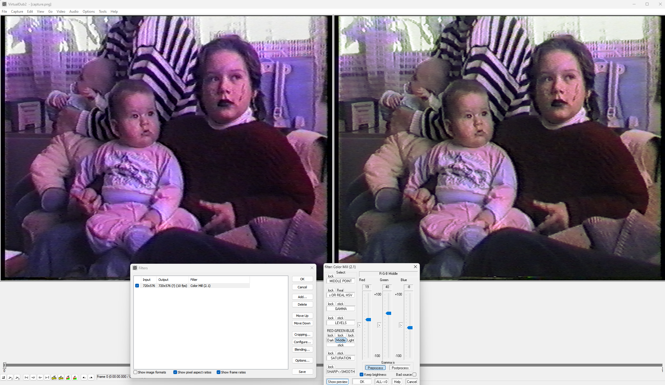

    Colormill in VDub. You can save these processing settings and load them quickly on later clips (together with anything else you've set up, eg cropping, resizing, export parameters).
    [Attachment 85340 - Click to enlarge]

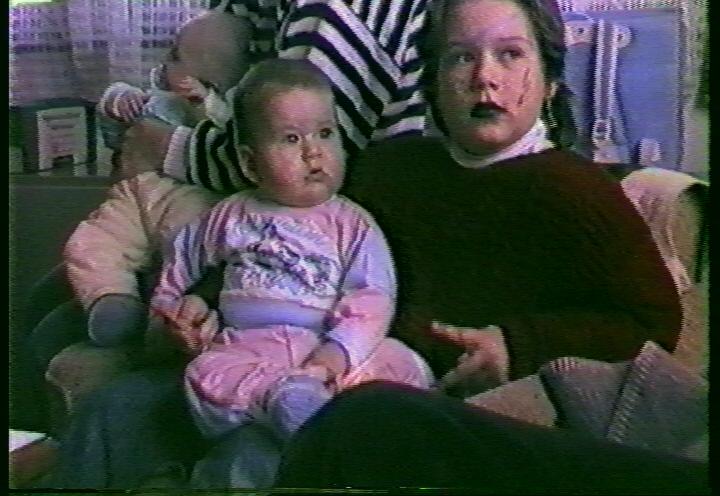

  6. Code:
    ImageSource("capture.png", start=0, end=23, fps=23.976)
    RGBAdjust(rb=-30, bb=-60)
    RGBAdjust(r=193.0/203.0, b=193.0/183.0)
    Blown out windows turn green though.
    [Attachment 85345 - Click to enlarge]
    Most auto whitebalance filters will be confused by the bright white windows at the top of the frame. Removing them helps a lot:
    ConvertToYV24()
    Crop(0,80,-0,-0)
    ColorYUV(autowhite=true)
    [Attachment 85346 - Click to enlarge]

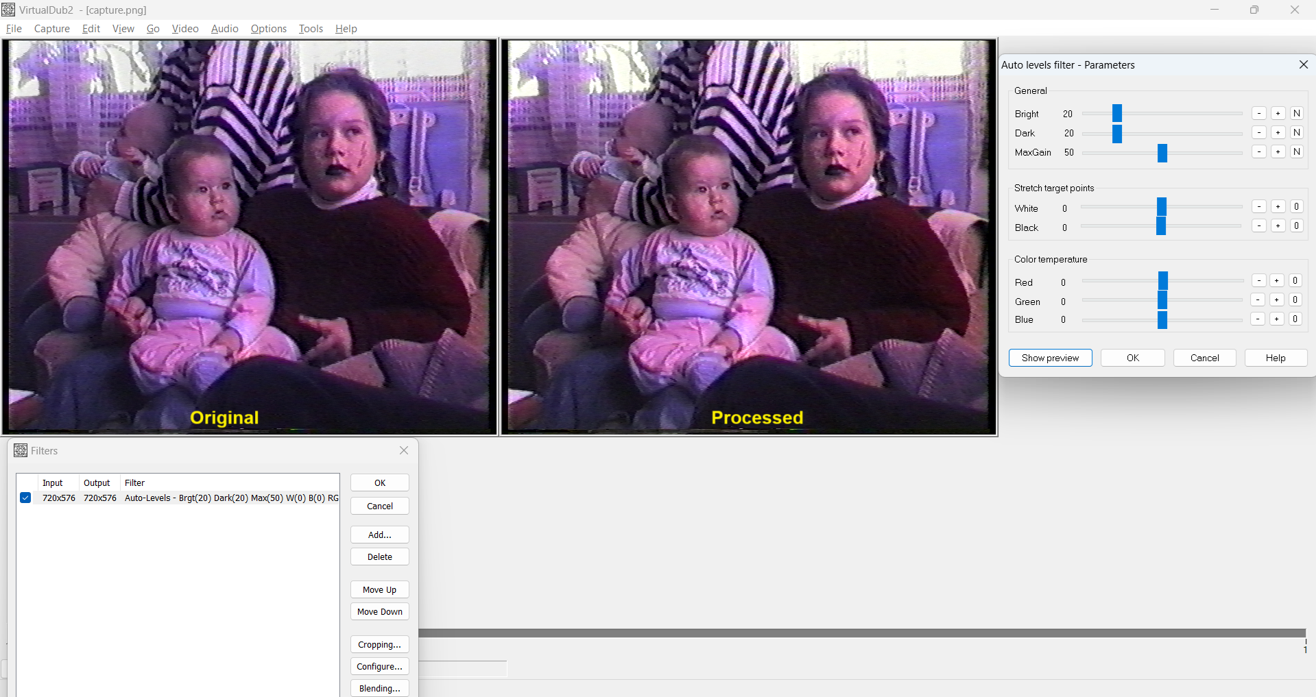

  7. DaVinci Resolve (free version) has the best color correction tools, and has an automatic color feature. But it may not be able to correctly guess the correct colors if there is some kind of weirdness going on with that tape. To try to get the most from the automatic feature, try Trick #1 in this video from Learn Color Grading. It yeilds slightly better results than the regular auto-color feature in Resolve.
  8. Image
