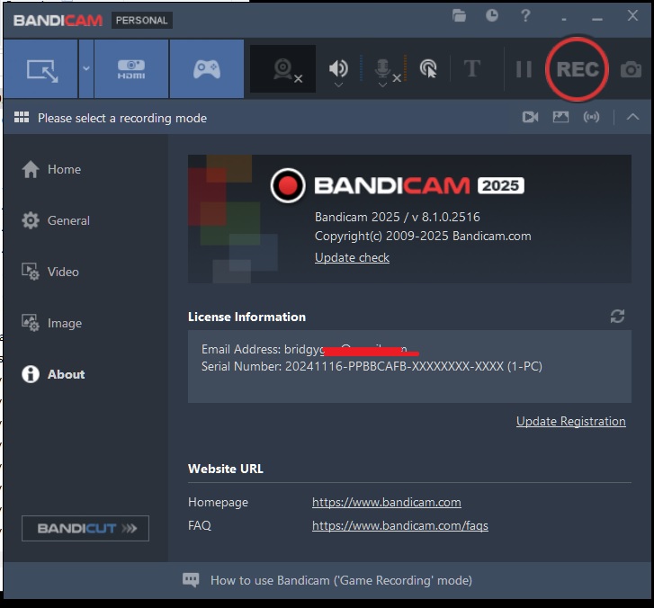

    Do you have the latest version of bandicam? I ask because their website says the latest version has fixed issues when recording h264 video.
    Aug 2024
    Sydney
    Haha, you asked the right question, i just installed it about 15 minutes ago, i don't recall getting the notification to update to the new version, i had Bandican open just before and noticed there was an update to version 2025, i was using the previous one which i only got a few months ago.
    I will now do an identical recording of one of those previous files that i did a few days ago and see if i get a different bitrate.
    Cheers.
    Note that there is no parrot sitting on my shoulder either, i had to buy the license to stop the watermarked 10 minute capture limit.
    [Attachment 86015 - Click to enlarge]
  9. The changelog on the website was pretty vague as to the issues, just that there were h264 issues fixed in the latest update. Whether they have all been fixed .. dunno.
    Plenty of parrots here ... but they are all where they belong, out in the garden. Mostly lorikeets. Corellas too .. the destructive blighters.

    Yeah not much info, anyway, i just recorded one of the original files again with the new Bandicam and i will note the bitrate, then do an Intelligent recode to HEVC in VRD and see what the HEVC bitrate will be, if the HEVC bitrate is not around 30 to 35% lower, or in fact the HEVC bitrate is similar to, or higher than the recorded AVC bitrate then i will know that it is still not correct.
    One thing to note tho, Bandicam is using it's own encoder to do it's recording from the screen, and being that it is software doing the recording then one might think that the stated video bitrate of the files would not be as accurate as it would be if it was recorded using a camera.
    That's how i see it.

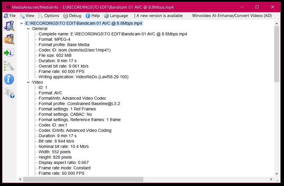

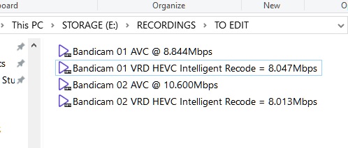

    Ok just finished the test, i did a recording of 2 different videos on my laptop screen, both recorded at 828h x 552w 4k/60p AVC with max bitrate of up to 30.0Mbps.
    1st recording was 8.844Mbps, VRD Intelligent recode to HEVC = 8.047Mbps.
    2nd recording was 10.600Mbps, VRD Intelligent recode to HEVC = 8.013Mbps.
    2 files with the VRD exports shown in Explorer screenshot.
    [Attachment 86020 - Click to enlarge]

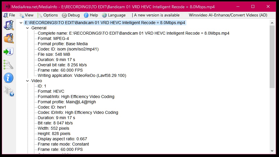

    MediaInfo of the recorded AVC file.
    [Attachment 86021 - Click to enlarge]
    MediaInfo of the VRD intelligent recode.
    [Attachment 86022 - Click to enlarge]

    They would not have this info in their website nor documentation i don't think, however i will send them an email and ask exactly how it is done, and i will explain to them the results of my VRD Intelligent recoding with rather different bitrate results that i normally get from a camera recording.
    Thing to note here, if i use a camera to record say 4k/60p HEVC and the video bitrate for that mode in the camera is 60.0Mbps, the video recorded is always at 60.0Mbps, even if it is a clear blue sunny day or a very overcast day, or even at night.
    With screen recording the software encoder can only record at a bitrate that represents the actual quality of the image being displayed on the screen.
    I can't record at anything higher than 1920x1080 because that is the resolution of my screen.

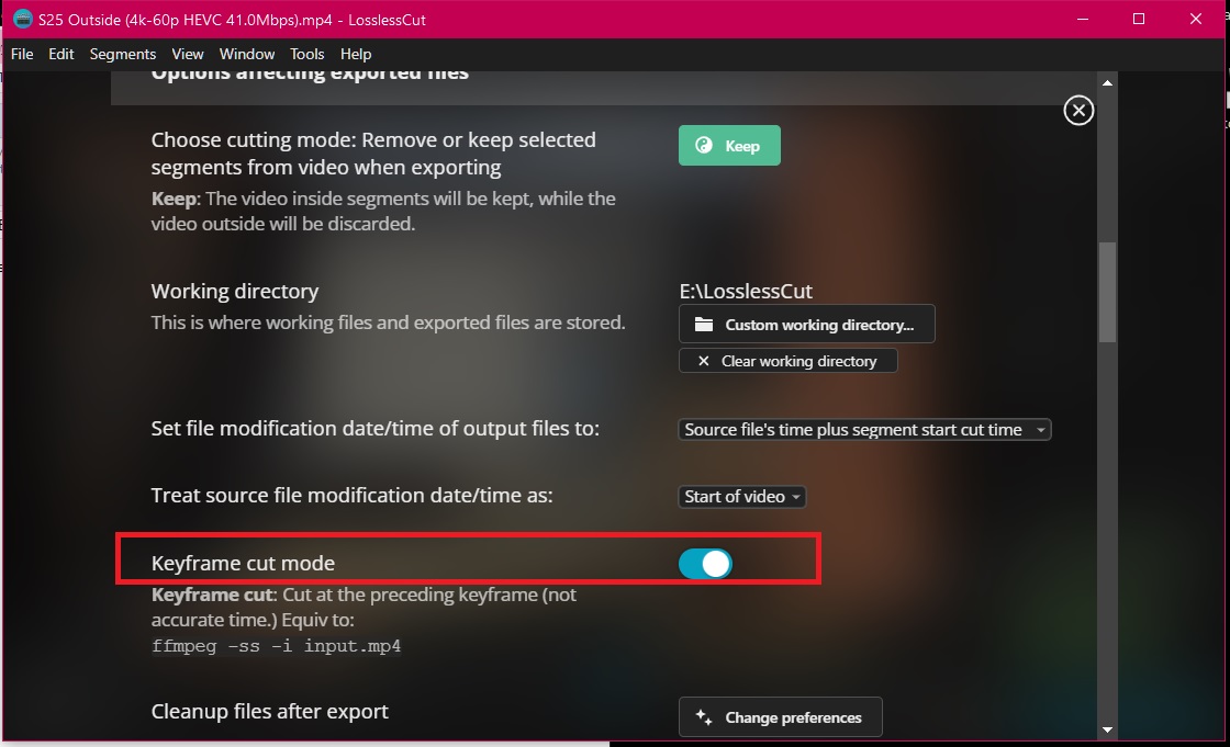

  25. Hello, everyone, again! So, this might sound a little random, even if we're on the right forum, but I was wondering if users who have both VideoReDo and LosslessCut can make another comparison test between the two...because I just realized something quite interesting.
    So, I was doing yet another rounds of random testing with these apps, and realized that the "Normal Cut" mode (which is activated when both the "Keyframe cut" and "Smart Cut" mode are unchecked) might actually be frame-accurate and lossless. I tried trimming a TV recording using VideoReDo, and as I was onto it, I copied all the timecodes, and ran them through LosslessCut on "Normal Cut" mode. I kid you not, the results were IDENTICAL! This was/is also true when just cutting out single parts from your video, like a musical performance, etc.
    Can somebody also give this another shot, and share their findings?

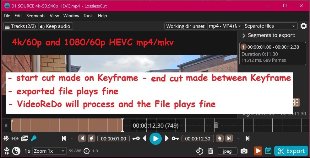

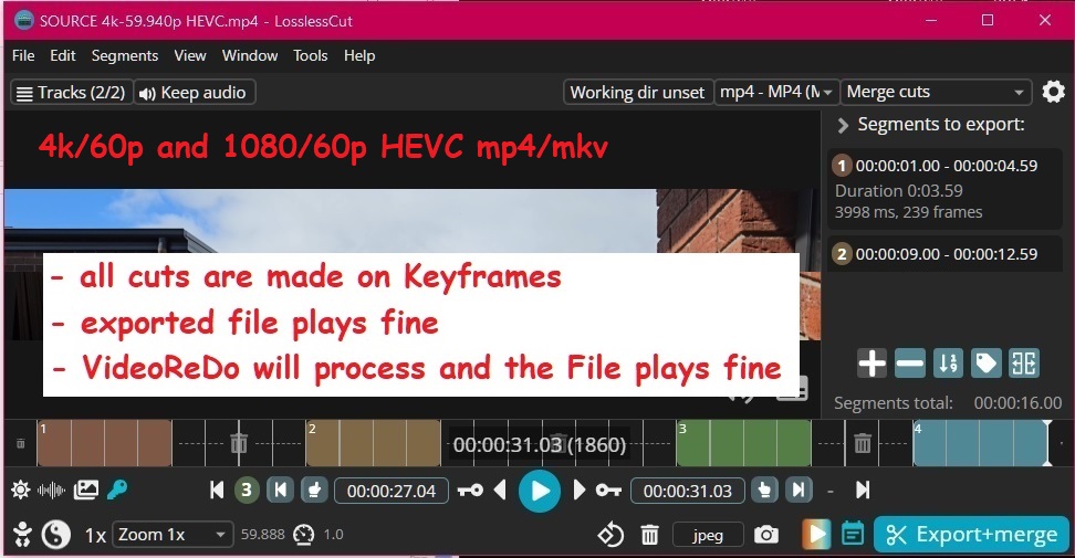

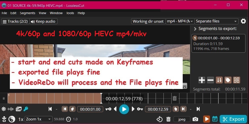

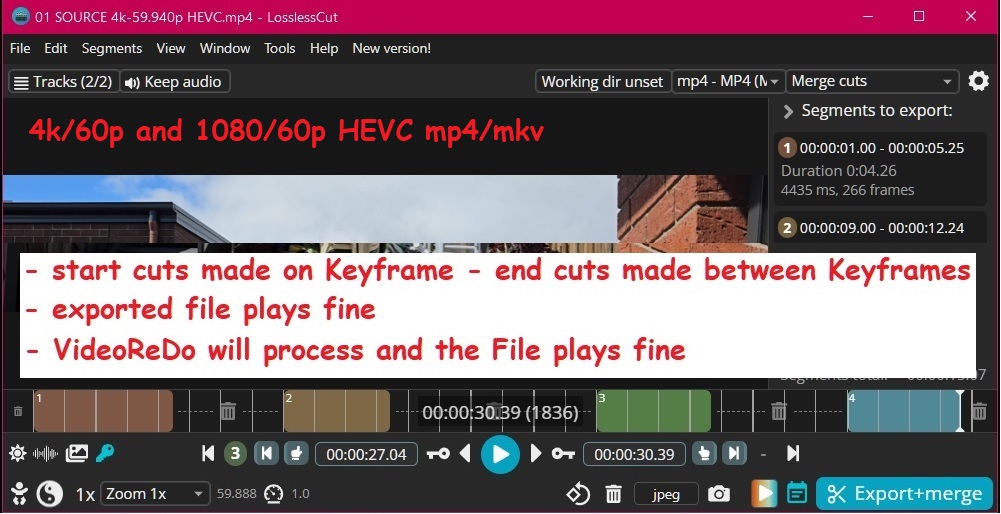

    I recently did a lot of testing with LosslessCut to see how it reacted when cutting bits from my 4k/60p HEVC camera files, i made cuts on Keyframes only, i did cuts between keyframes only, and i also did cuts on and between keyframes in single files, and i published screenshots with my results.
    This was in one of the other Threads dealing with VRD alternatives, disregard all posts relating to Tipard video editor as they are no longer relevant, turned out that software was a bit strange in the way that it worked.
    I also apologize for deleting my videos from my Youtube channel, i think that happened while attempting to move them from one channel to a new one dedicated to video editing software testing, but if i do find them somewhere i might upload them again.
    https://forum.videohelp.com/threads/416487-Alternatives-for-VideoReDo-TV-Suite-with-Test-Results
    I might give LosslessCut another go doing it the way that you describe in in your post.
    EDIT:
    I just did some more test cuts with LosslessCut using my 4k/60p HEVC camera files, and i just seem to have minor glitches when i have the Keyframe Cut Mode turned off, but i don't have any issues with that Mode turned on, as long as the start cut for each retained segment is done on a Keyframe, the end cut can be anywhere.
    VRD also handles those cut files too, so regardless if i lose VRD Pro or not in the future, when i use LosslessCut with my files, i will just keep the Keyframe Cut mode enabled just to avoid any issues.
    [Attachment 86066 - Click to enlarge]
    EDIT:
    Thanks for taking the time to do another test. Yeah, LosslessCut is known for not playing well with some HEVC files sometimes, so here's hoping this issue's thoroughly looked at, and taken care of. I've had no problems with HEVC files. However, the ones I worked with and tested on weren't 4K, just 1080p with 4:2:2 chroma.
    What about the accuracy, though? Were the cuts as accurate as VDRD?
    LosslessCut works fine with my 4k/60p HEVC Camera files, which is why i now use it to do my Cuts on my 4k/60p HEVC camera files because VRD has issues with the seeking on the timeline to locate my cut points, it is ok for cutting the start and/or end frames off, or maybe cutting a few frames between, but any more than that it just becomes too slow, sometimes it may even cash.
    Unfortunately Dan Rosen passed away before he could fix the few bugs that caused this lagging issue, as well as fixing the crash issue when exporting or saving the cut files, and i know this because i was a Beta tester for Dan with his development of 4k and the implementation of HEVC.
    The thing with LosslessCut is that it was not meant to be frame accurate unless your Cuts are made on Keyframes only, and if you disable the Keyframe cut mode i believed the developer does not guarantee accuracy, and this was the issue that i have when using that setting, so i just enable the Keyframe Cut Mode because it works for me.
    You may have seen these screenshots from my other Thread that i linked to, but using these 4 Cutting scenarios my files play perfectly, and VRD will import them and export to other formats.
    If i make a Cut between Keyframes at the start of any retained segment then that segment will be corrupt during playback.
    [Attachment 86083 - Click to enlarge]
    [Attachment 86084 - Click to enlarge]
    [Attachment 86085 - Click to enlarge]
    [Attachment 86086 - Click to enlarge]
    Accuracy seems to be spot on when i am doing my cuts as per the screenshots, now some people are very paranoid about frame cut accuracy so i guess that they will need to do their own testing, as for me, i am not a frame peeper (like a pixel peeper) as my cuts do not have to be so accurate that it will destroy my life, in my case because i record in 60p mode my LosslessCut sees my keyframes at every 1 second, or every 60 frames, and that is ok for me.
    I have tried many of these so called frame accurate cutting tools, some claim to also do the smart render joining as well, but i mostly had issues with the way that their Cut tool worked, to the point where i got frustrated, when i found LosslessCut i immediately got the same impression with the Cut tool on the timeline so i discarded it, luckily for me i read some documentation about it so i re-installed it and after another test drive of the cutting tool i ended up getting use to it, and it has now become my go to Cut and Smart Render tool.
