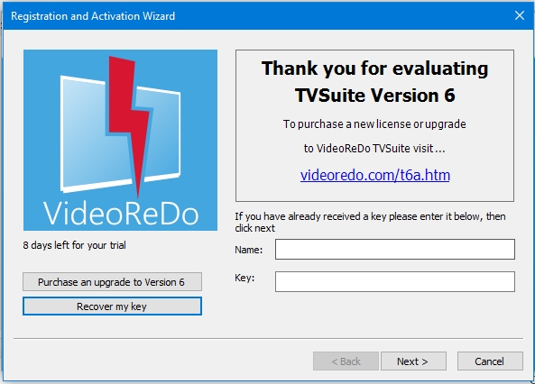

    - how to use my update code to enable V6

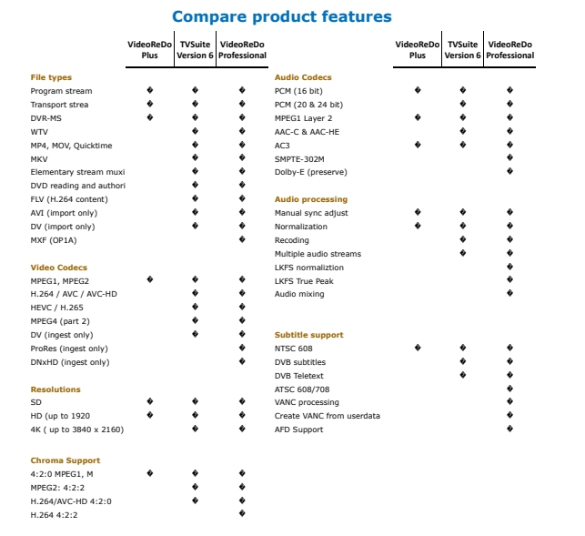

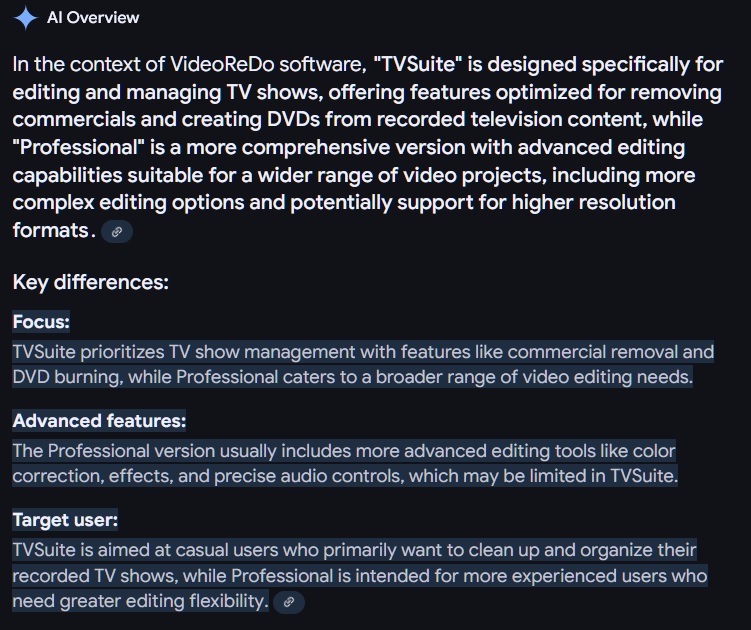

    I have been in a private conversation with Marayong regarding the differences between VRD TV Suite v6 and VRD Professional, and after doing a google search i just found this short overview (see screenshot) but it does not really explain it in more detail.
    I was hoping that someone here could offer a more informed overview, however i realize that most, if not all TV Suite users would not know the differences because they had never used the VRD Pro version to compare, just as i have not used the TV Suite since i moved to the Pro version when i upgraded to v5 from v4, so even i have no idea.
    If anyone would like to comment, please type away.
    [Attachment 85806 - Click to enlarge]
  19. Here's a side by side feature comparison of VRD and VRD Pro from the DRD website:
    https://web.archive.org/web/20231106073640/https://www.videoredo.com/en/CompareProducts.htm
    Ignore the first column, that's for an obsolete product which DanR no doubt included to show how much better both versions of VRD were.

    Overall there is not really that much difference, both supports 4k, Pro supports h.264 (4:2:2) and ProRes and DNxHD (import only) so i can see why some would not need the Pro version.
    I have imported 4k/60p ProRes 422 many times, but can't cut and smart render back to ProRes, has to be another format.

    Only issue now is the upgrade to V6. To recap, I have an upgrade token, I purchased it in 2022, used it once or twice and went back to V5. I'd still like to have V6 installed on my new PC though. What's stopping me is that I am never at any stage presented with a 'Manual activation' option. It goes straight to recognising that I'm using a token, asks me if I wish to upgrade fully, and then it takes me to a defunct page. Any ideas?

  29. Jim, I can't duplicate a new install to check exactly how you do it since I have once licence and it's already used. But ... assuming you haven't tried this (you probably have), install VRD6, click on help in the menu bar, then click 'enter software key'. Type in your name (that the upgrade key was issued to, including any middle initial or name, if used when getting the key), then enter in the upgrade key.
    I can't go past that step, but it is supposed to internally generate two new codes and then present you with the option to activate online or manually. Click manually and then go to the website I previously gave, enter in the two codes to the website and you will get a 4th code which you enter into the manual activation field in VRD, which will then install.
    To get past this popup:
    [Attachment 85904 - Click to enlarge]
    you will need to have a valid name/upgrade key.
    More details and screen shots of the subsequent windows can be found here:
    https://www.reddit.com/r/videoredo/comments/1b9vrwa/how_to_use_manual_activation_site/
    There is one error on that page. The manual activation site is not: http://videoredo.com/activate
    but it is now: http://videoredo.com/
    It is very important that the name you enter at the first step matches the name that is attached to the upgrade token in the email you got from DRD (the company that made VRD).
