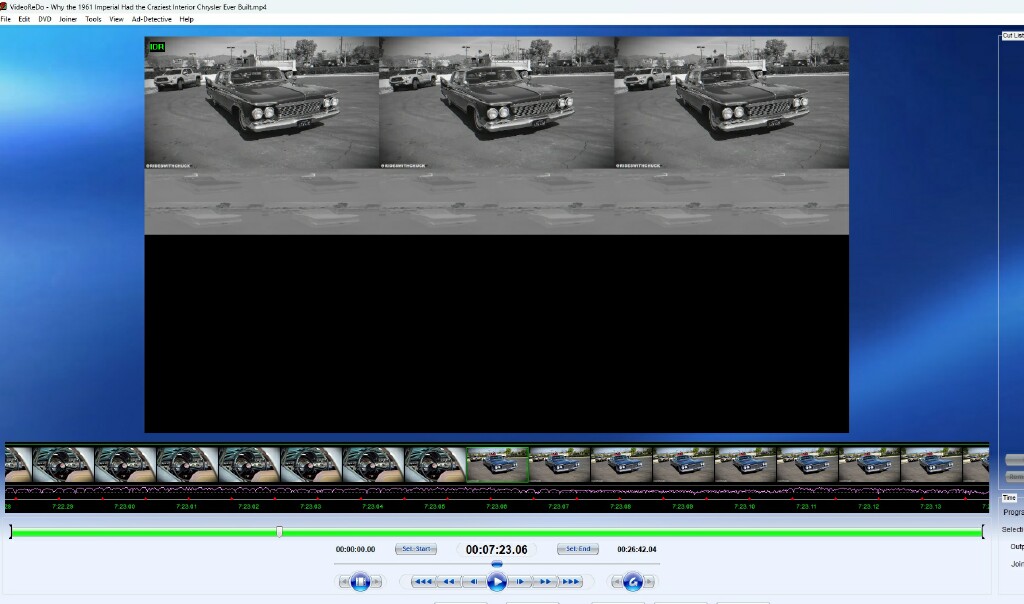

    I have Video Redo 4,5,and 6 on my fairly new MSI laptop. Installed them all earlier this year.
    I've used all 3 versions at various times but today I was working on some Wolverine 8mm scans and suddenly there were three images (monochrome) instead of the one in the center. See Attached.
    I think it appeared on Ver 6 but went back to normal after I restarted it but Ver 4 & 5 still have the problem when I open a video file.
    Couldn't find anything in the settings... any ideas?
    Update: Under Options - Playback Devices, I unchecked Use Video Card YUV Acceleration.
    That seemed to fix it on V4 and V5. I noticed that "Video Driver" is different in each version.
    Hmmmm.....
    Update 2: I remember a video driver update a couple days ago (Intel).
    That must have had side effects.

  3. Could be the video driver update, especially if you had the acceleration setting ticked. Might be worth going through all the settings and turning off all hardware acceleration settings. As VRD gets older and older issues with modern video drivers will become more and more of an issue. Having said that, the lack of any other comments suggests no-one else has experienced your issue (I haven't) so it's presumably related to your specific hardware & software environment.
    If you are still having the issue you could try posting your query to the reddit forum - one of the VRD devs frequents that forum.
    Aug 2006
    Never gave those settings a thought in the past. It's still checked ON in Ver 6 and it seems to work fine for now.

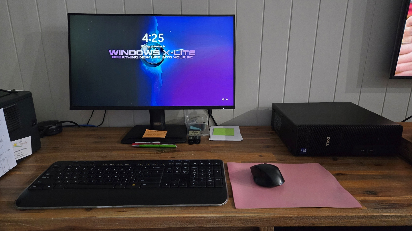

    Speaking of Dell and HP removing H265 (HEVC) decoding from some of their laptops/Desktop Computers, i just got my new Dell Pro Max Slim Desktop PC (Model FCS1250) delivered today.
    I immediately removed the 512gb Windows 11 Pro NVMe drive from the computer before i even connected the Power and MSI Screen, and i installed a brand new Crucial T500 NVMe drive with a Clone of my Metabox Windows 11 X-Lite Optimum Pro on it using my Hasleo Disk Clone software.
    I plugged the power cable in, i then went to plug the HDMI cable from the MSI screen into the back of the Dell PC, only to discover the Dell has 3x Display Ports and no HDMI, so i was not able to power up the Dell, got to head off to the Computer store tomorrow and grab a new cable with Display Port on each end.
    This new Dell PC will not be affected by the H265 decoding crap thank god.

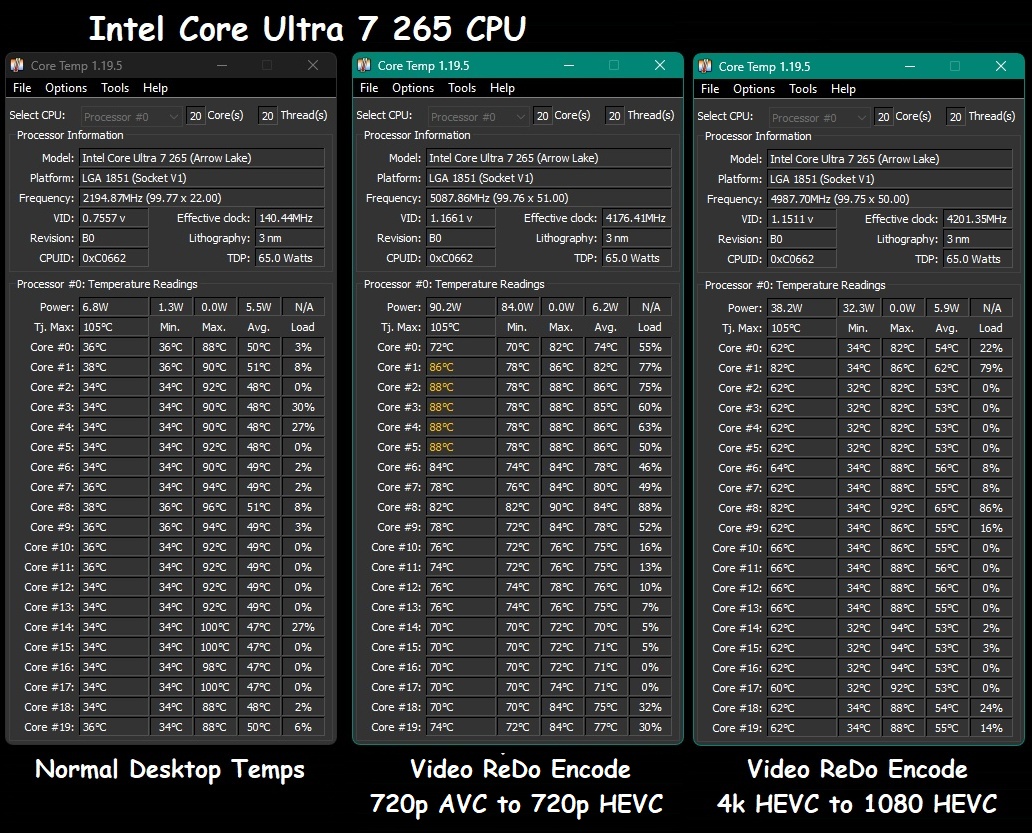

    On another note, the new Dell with the Intel Ultra 7 265 CPU encodes a 4k/60p HEVC file about 60% faster than the i7-9750H 6 Core CPU in my 6 year old Metabox laptop.
    I don't understand anything about these new Ultra series CPU's and how they really work with all these Cores that they have, as compared to the older i7/i9 CPU's, but i noted that the CPU usage is a bit lower when encoding with the Ultra 7 265 compared to the laptop, using the software encoder, not hardware based.
    This is a set of screenshots from Core Temp while sitting Idle, then encoding a 720p AC file to HEVC, then encoding the 4k/60p HEVC file down to 1080/60p HEVC.

  12. Originally Posted by Bridgy View Post
    Obvious: more cores (20 vs 6) and more threads (20 vs 12)
    Aug 2024
    Sydney
    Yes i know all that, and of course it is going to be faster, i just don't understand the way these new chips have been configured, like in the i7 you got 6 cores/12 threads or 8 cores/16 threads etc, buy these Ultra chips have Performance Cores and Efficient Cores making up the total number of Cores, but the Thread count is the same as the number of Cores, not double.
    Also, i still don't understand how the cores work together during say encoding etc.
    Total Cores = 20
    # of Performance-cores = 8
    # of Efficient-cores = 12
    # of Low Power Efficient-cores = 0
    Total Threads = 20

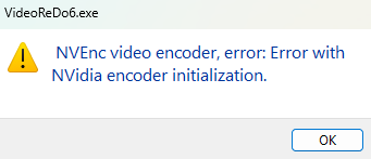

    Another case in point, mentioned in case others have the same issue, VRD started failing to initialise my NVIDIA GeForce 4060 when trying to use it for NVENC. Looking into this has revealed it's caused by deprecated functionality in the NVIDIA drivers. The NVIDIA release notes say:
    "Applications compiled using older NVENC presets and rate control modes would stop working on R590 drivers and above. R580 are the last drivers to support them. The new presets and rate control modes were added in Video Codec SDK 10.0. Therefore, all applications must migrate to Video Codec SDK 10.0 (or above) and use the new presets and rate control modes to keep continuing working on R590 drivers and above. Users can refer to the migration guide present in the Video Codec SDK to help migrate."
    The 4060 driver updated from R580 to R590 on Dec 4 so I can either stay on R580 (which will eventually cause its own issues) or switch to software encoding in VRD, which is what I've done. It's a pain in the arse as the main reason I bought the GeForce GPU was so VRD could use it.

    This is the error I've been getting with NVEnc since the NVidia driver update:
    [Attachment 90508 - Click to enlarge]
    I'm chill about it though as obviously VRD cannot be recompiled to use the latest Video Codec SDK from NVidia. I'd rather have the option of using NVEnc but Software encoding on modern CPUs is quite acceptable. After having no audio for so long, I'm no longer sweating the small stuff.
