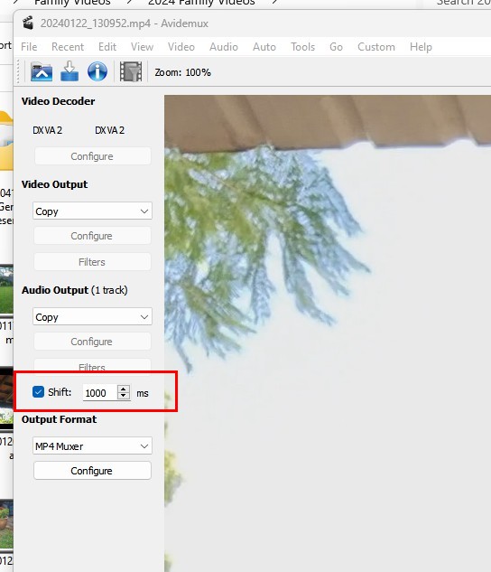

    For the audio sync, have a look at AVIDemux. It has a "Shift" feature which allows you to move the audio without re-encoding. Set it up like this (put the Output format onto whatever your file is eg MP4).
    [Attachment 85214 - Click to enlarge]
    The numbers are milliseconds (500ms=1/2 sec).
    A Minus value (-) advances the audio, plus delays the audio.
    When you're happy, File>Save and your new file will have "edit" appended to the file name.
