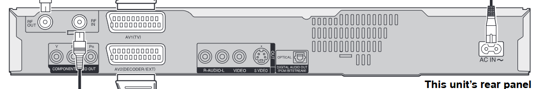

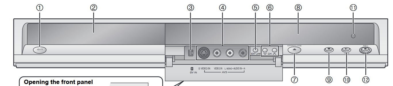

    The problem I'm having is that the ES-15 is connected a S-video (male to male) from the VCR player to ES-15. Is this correct I'm not sure. I did have a problem with the S-video cable connecting to the end of the ES-15.
    You need to connect your VCR to the S-Video IN as signal input which is on the front of the ES-15 only (AV3). The S-Video plug on the back is to be connected to the capture device.
    On the remote you have to press INPUT SELECT and then selct AV3 as input.

    I don't have an AV4 or S-video IN on my ES-15, only S-video OUT on the rear.

  8. From what I conclude from some European (PAL/SECAM countries) service manuals:
    - model ES15PL has Mini-DIN (aka Hosiden) front and rear S-video IN connectors which are functionally equivalent. Maybe the same for US/NTSC country models.
    - models ES15EB/EP/EC/EG/EBL have Mini-DIN (aka Hosiden) S-video IN on the front panel only
    No idea what else exists.....

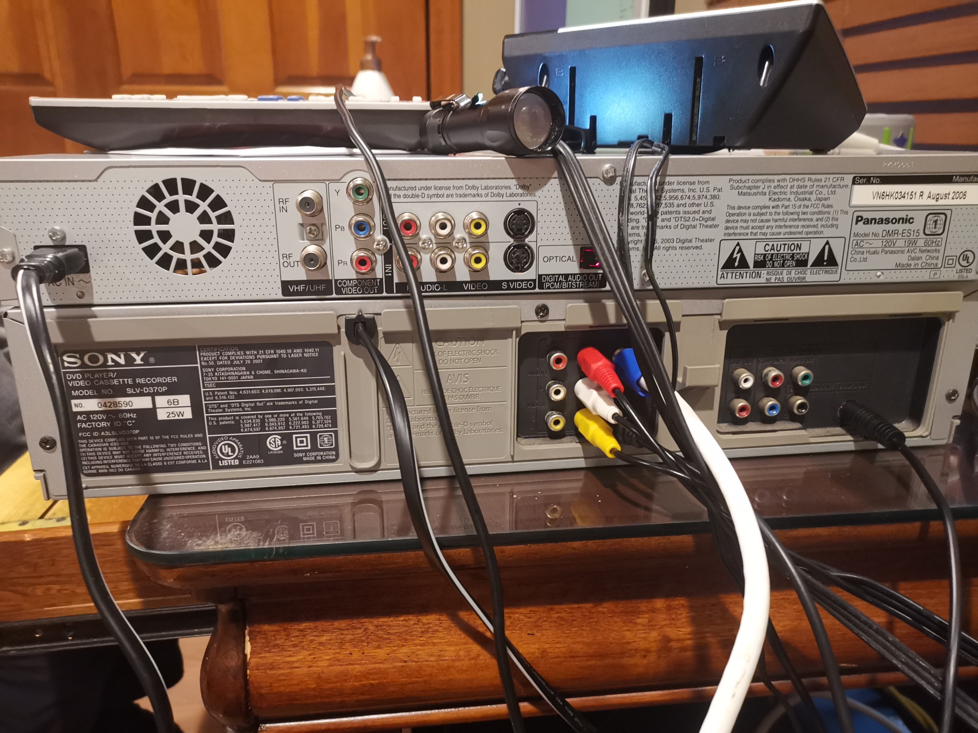

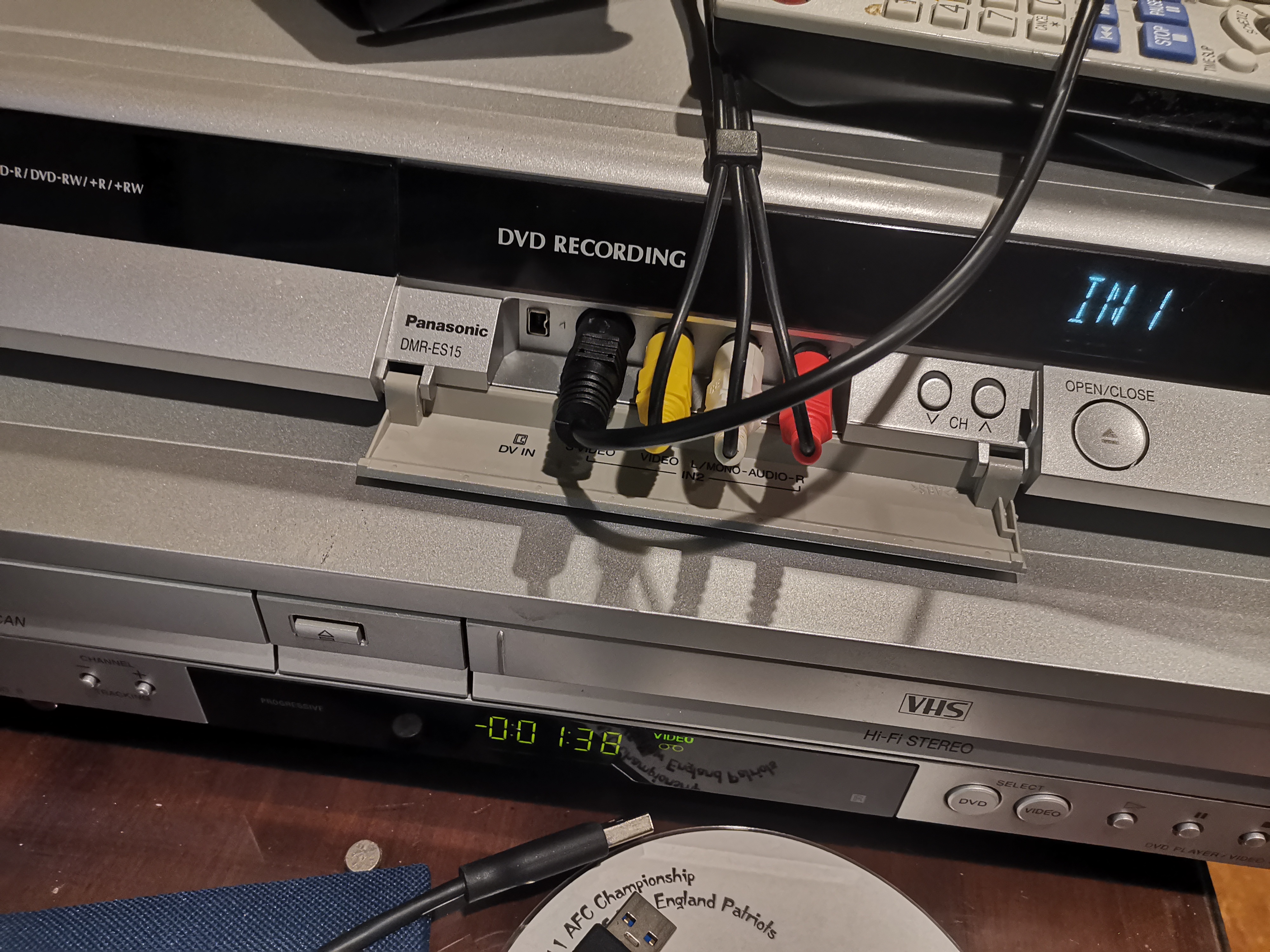

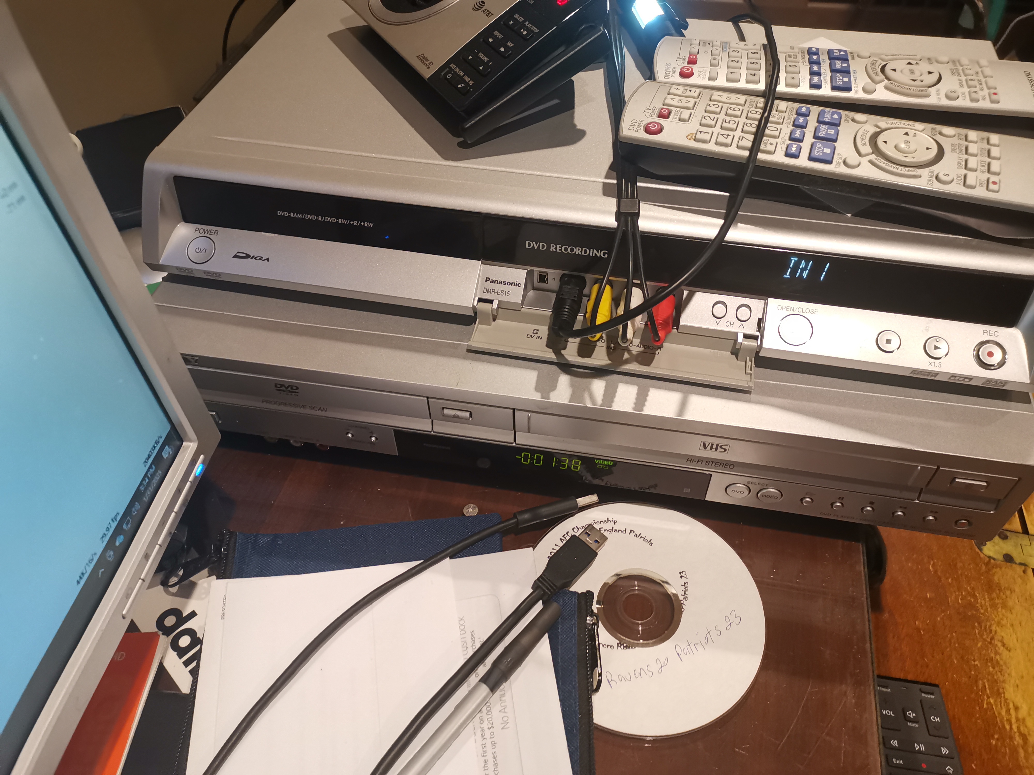

    I have video coming from the VHS Player (VHS film) and I can see it in virtual Dub. I have 2 remotes for the ES-15 but can't see the settings for the ES-15 on V-dub. I have one no name S-Video on the back of my VCR (only 1 S-video on back of VCR) and in the front of the ES-15 (There are a IN S-video and OUT S-video but cables don't fit in securely like the one on the front.) I'm still not sure why I can't set settings in VirtualDub. I did press function and display pointing to the ES-15 the display screen moves to set 1 and that's it.
    I would like anyone's help. Thank you
    see attachments

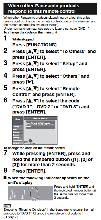

    Panasonic DMR-ES15 DVD Recorder Remote Control Programming
    Also see the manual of your ES-15 changing the remote control.
  11. @Infoman37:
    On a sidenote: According to the manual page 31 your SONY VCR does NOT output a VHS signal on the S-Video output. That S-video socket is for DVD playback only. For playing VHS tapes the yellow Composite output is useful only (which you connected correctly to the yellow RCA on the front of the ES15).
    The S-video cable from VCR to the ES15 has no function for VHS tape playback and you can remove it.
    [Attachment 85228 - Click to enlarge]
    The S-video OUT on the rear of the ES15 has to be connected to the capture card S-Video input using the S-video cable.
    (According to your pictures you seem to have no connection from your ES15 to your capture device, hence you will never see anything on the PC (Vdub) screen.)

  12. ... and here instructions from the ES15 manual how to match the Remote with the ES15 (in case it isn't matched):
    [Attachment 85229 - Click to enlarge]
