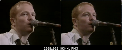

  1. Since getting into U-Matic, I've collected some U-Matic music videos that were probably used by networks such as MTV to play over the air before betacam was the more preferred format. Most of these are from 1995 to 2000-ish. I got them mainly to use as test tapes because they were commercially produced on I'm sure good working hardware at the time.
    I'm fairly sure that I can get better transfers of these music videos than what are currently on YouTube posted on their the official channels. My guess is Youtube's compression/bitrate is better than it was 15+ years ago when most of these videos were originally uploaded as 480p 29.97fps.
    The videos on YouTube at least in some cases seem to be zoomed in or have ditched some of the overscan area in all directions, almost as though they were encoded by an elgato video capture or something (which are known to do that). U-Matic doesn't really have head switching noise, so it doesn't make sense to me why they'd have intentionally done that.
    See attached screenshot of the same frame. YouTube version on the left, and my very basic composite capture on the right from EVE6 - Open Road Song.

    Re those screenshots, there's not a lot in it. The YT is softer. Whether it warrants a new upload...

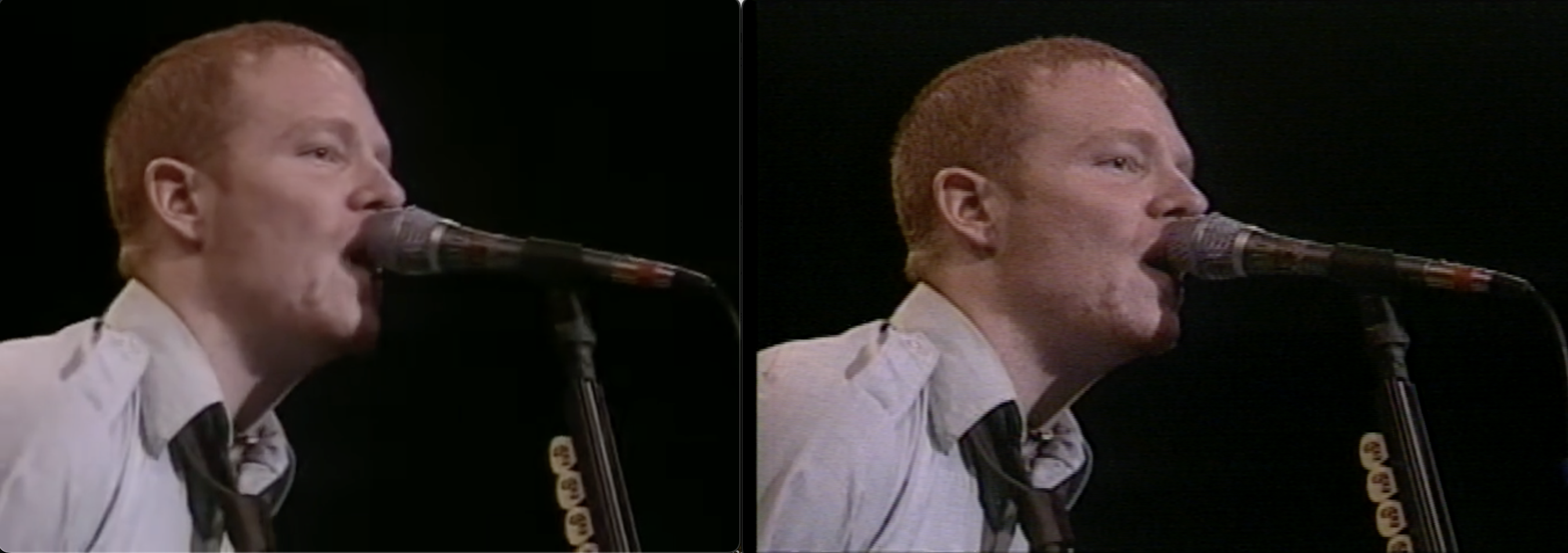

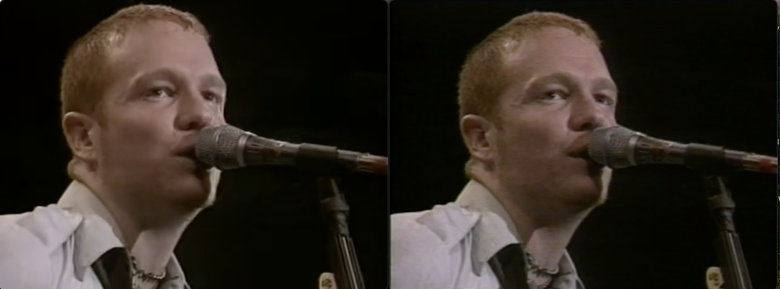

  7. Got a bit further improvement out of the VP9000, doubt I'll be able to improve it more. Eventually I'll see what the DomesdayDuplicator can do. Youtube is on the left, my VP9000 is on the right. Technically this was done in PsF interlacing, so it's interlaced, but there's only motion every 2 fields, so the above screenshot was not deinterlaced and that's how the frame looks like coming off the player. Obviously I also didn't correct the pixel aspect ratio either, but if I did, should be some extra perceived horizontal resolution to the U-Matic capture also.
    I actually reached out to Eve6 via email to see if the company that made the original video is still around (which would have the digital source files), If they aren't, or they no longer have the original files, this could be one of the better copies still left out there, so I asked if they wanted it to re-upload themselves.

    That's a major improvement, If you see noise grains and chroma blotches that's called transparency, meaning your capture chain is not processing much of it, just passing it along with minimum degradation, The one on the left is what it would look like after post processing, which I'm not a big fan of.
  9. Obviously it is heavily denoised - perhaps YT has ability to detect lowres but noisy video to apply heavy denoise to improve compressability - bandwidth and storage space are costly. Upscale video to HD or UHD and then try challenge YT.

    I think a bit of Camcorder Colour Denoiser would help (shirt colour doesn't look right). Also, the AR doesn't look right. But definitely better than the old YT version. Looks like his face has had a tough life!
