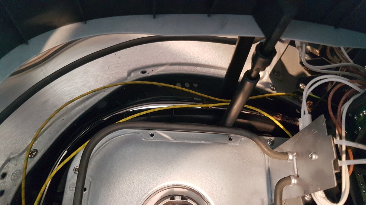

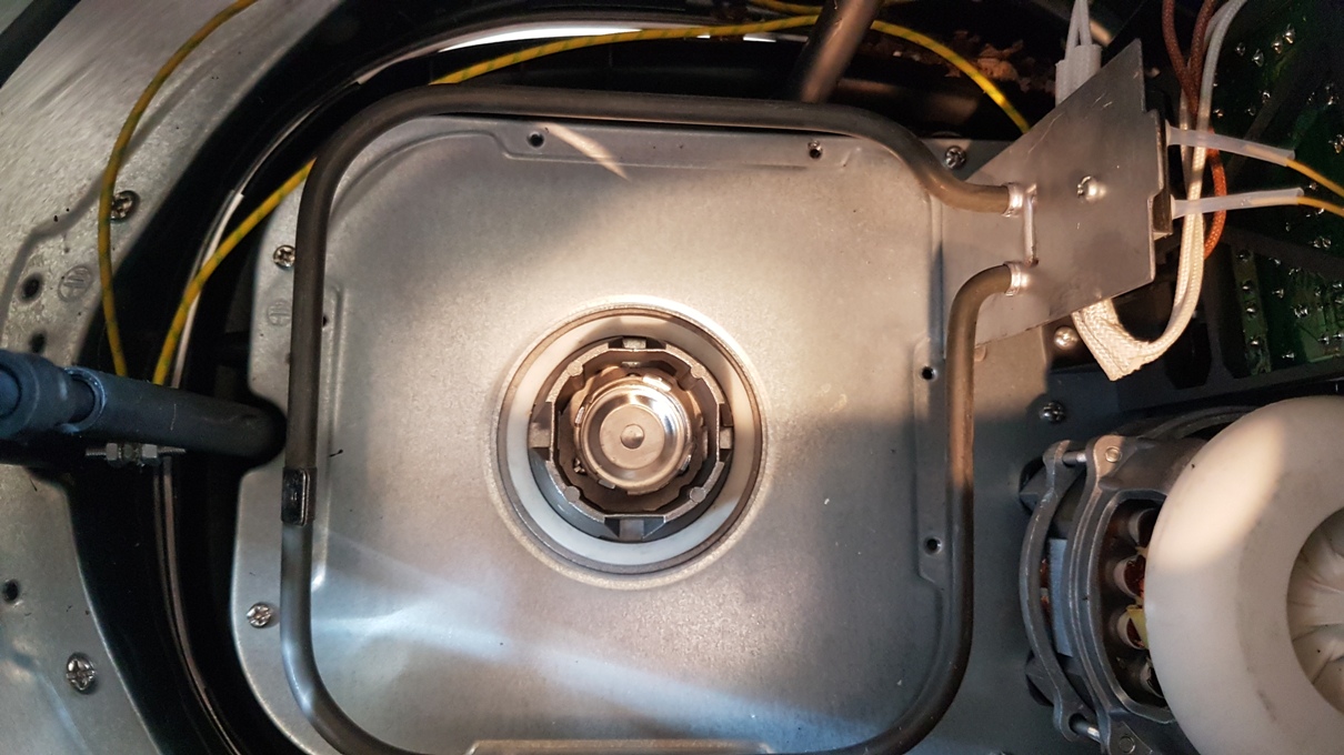

I have an old bread maker model Morphy Richards model 48239. haven't used it much when it was new maybe only three times. Few weeks ago I wanted to use it and to my surprise I discovered that the belt that moves the kneading plate has disintegrated into particles which is odd.
It is such a bad design to service because to get to the belt to replace, I would have to dismantle the whole machine into parts until I reach the belt part.
It has several security screws so I had to make a special tool to unscrew them. Today I managed to take the top cover and now I see that there are more obstacles in the way.
Please look at the attached images. There are three black pillars that hold the bottom plate in addition to several screws so it is not as straight forward as other machines.

Never mind. I managed to dismantle the machine in the end.
Unfortunately the belts I ordered three sizes none of them fit. So I have to order some more sizes.
You can't trust sellers on AliExpress they told me their belt will fit my model but obviously they lied.
