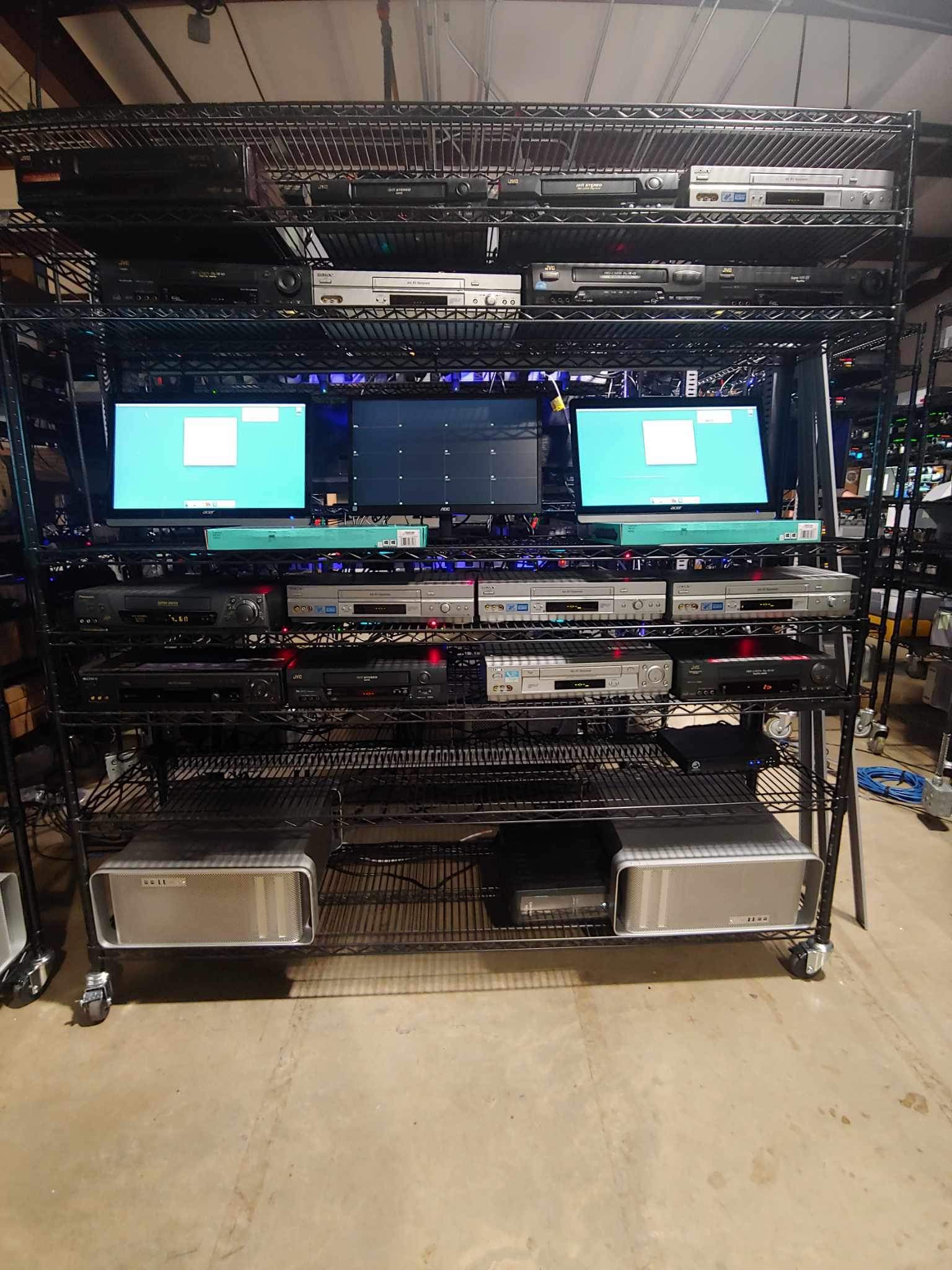

    To answer the question more directly Legacybox/Kodak digitizing/Southtree which all are owned by AMB media and are all operating in the same building. It’s the same company.

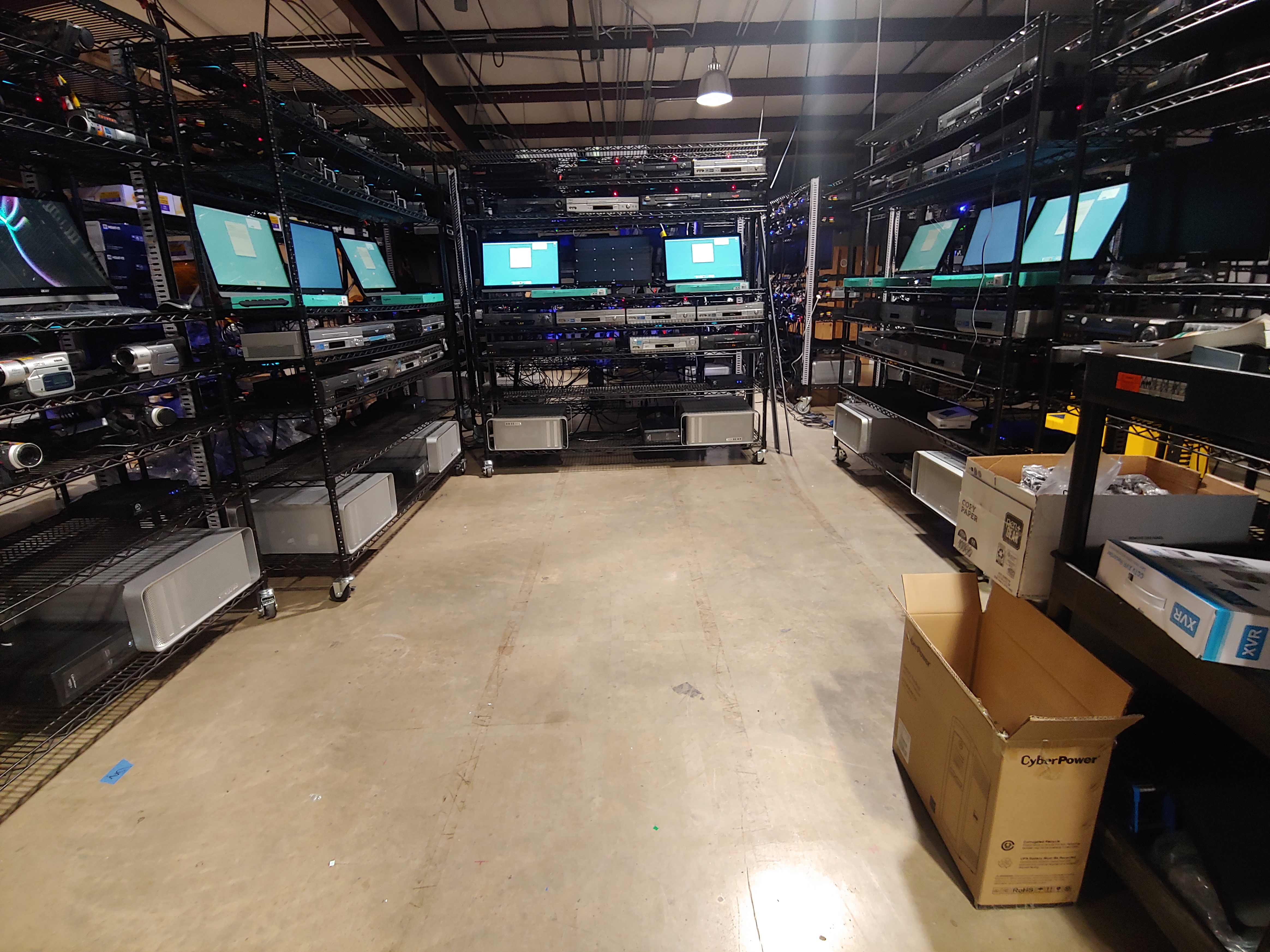

    They leave customers videos in a non climate controlled warehouse for months before digitizing them. They digitize VHS in VCRs that are in really bad shape. They use one computer to capture from 16 VCRs at once. Each VCR is connected to a splitter (MT-VIKI 4 Way 3 RCA Splitter Composite Video Audio Distribution (1 in 4 Out). They only use two of the outputs. One output goes to the composite security system which displays all 16 videos on one screen. The other output goes to a Haugpauge HD PVR 2. The splitter acts up and hinders video and audio sometimes and the tech won’t know it unless they press stop of if they know that box has a tendency to do that they can view the TS file and see that one isn’t counting. Four of the Haugpauge cards connect to a 4 in 1 out ankr device then the 4 ankr devices go into the 4 USB ports on a Sonnet USB 3 PCLE card inside of a Mac Pro (G5). Then they have another computer for archiving. That’s one rack. There were 5 racks per person and that makes up a POD. So one person watches 80 captures.
    Their software was developed by https://youtu.be/NquPjE60toA?si=j5CPKsJpEO2c-LiG. When they coded the capture software they didn’t set up the left and right channels correctly so something flying from left to right sounds like right to left. The system they created also doesn’t allow for editing of blue screens. The files transferred to a flash drive and DVD are split into 2 hour increments. If the video had 2 hour and 30 minutes of stuff, then there would be 30 minutes of blue screen at the end of the clip.
    Most of the blame for those transfers being bad isn’t really on the workers. The workers don’t really get a good preview of what is going on because their preview is coming from a split before the capture card instead of the capture cards output and their management pushes them to just get numbers. Their management knows their transfers are bad and just doesn’t care. They actually were starting to have super sections by the time my contact left. They started to have every tapes section be a dedicated 12-rack super section for one specific format. They added so many racks so there'd be enough time to let the first rack finish by the time you're done with rack 12, and God help you if you take more than 2 hours to switch all 12! That’s 192 tapes for one person. They just want warm bodies to push buttons. I don’t know if they stayed with the 192 at once. That wasn’t that long ago though. It’s all marketing with them.

    Here are some pictures of there hardware.
Name:	Front of rack.JPG
Name:	Back of rack.JPG
Name:	Inside of POD.jpg
