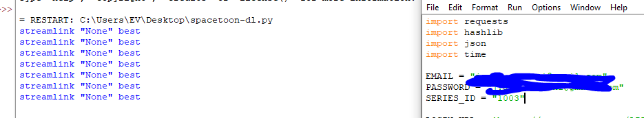

[Attachment 85236 - Click to enlarge]I checked and it keeps working “streamlink ‘none’ best”Last edited by ımtryingdownload; 1st Feb 2025 at 11:40.
It returns None, because the series 1003 contains "series_cost": "Premium", which means it's paid content. If you can't watch the content in the app manually with your account, then you can't restream it.
