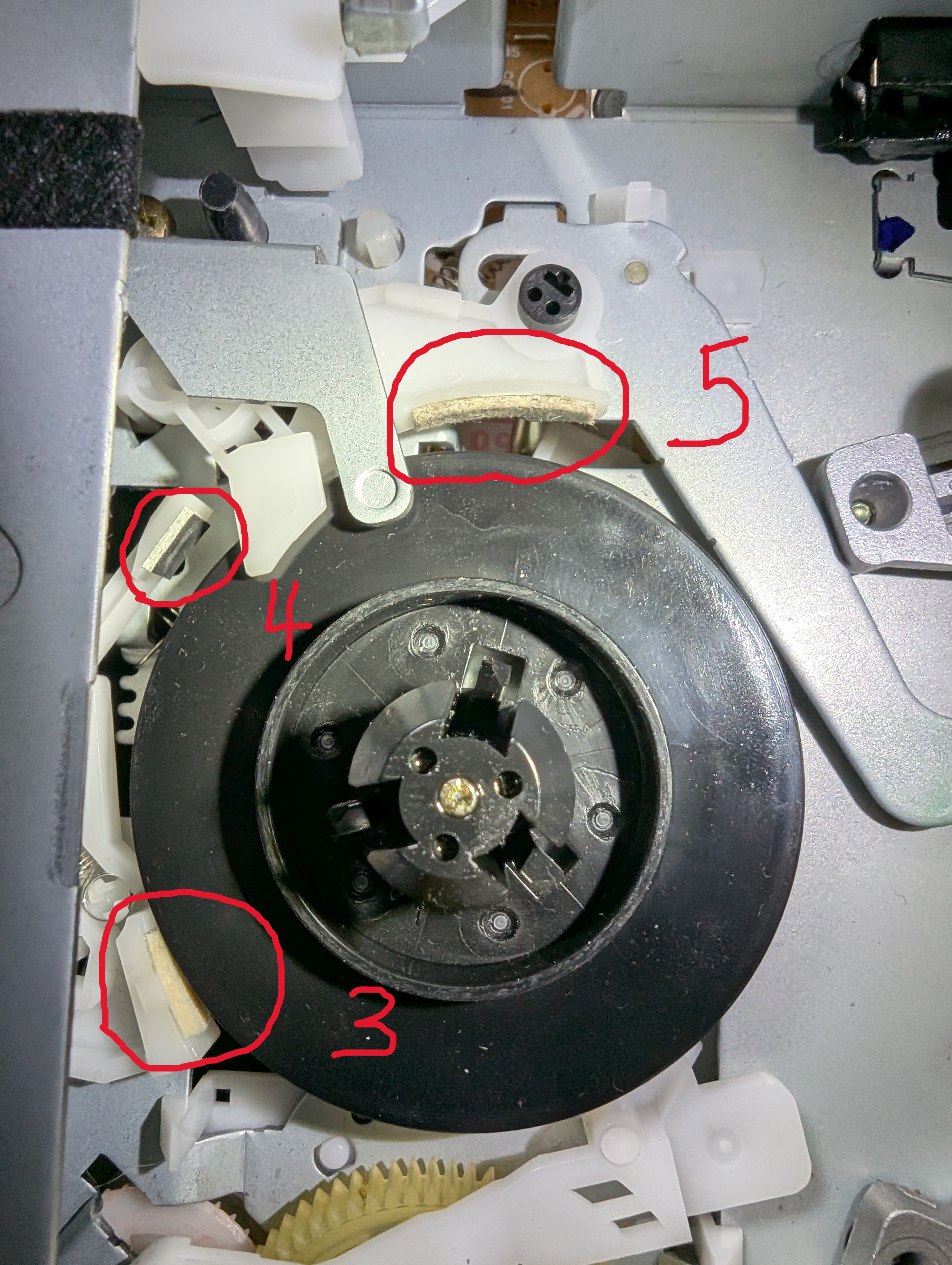

  3. Thanks for your feedback. Is there a sure way to know if it is the brake pads? I took the lid off and tried to get some pictures of the brake pads. I don't have anything for reference so I am not sure which one might be the issue. Also, I watched what was happening with the lid off and I don't think I saw any tape spillage, but I don't really know what I am looking for, extra slack or excess tape in the cartridge? I am also attaching another video of FF->STOP function with the lid off.

    The brake pads don't look completely worn, this doesn't mean they are functioning properly, they could be glazed, The best way is to replace them, but finding a replacement is not going to be easy, another way is using some felt pad alternatives and cut them to size, But for now you can try roughening the spindle tables surfaces with fine grit sanding paper and clean the brake pads with some detergent to remove the black stuff and allow them to dry and give it a go.
