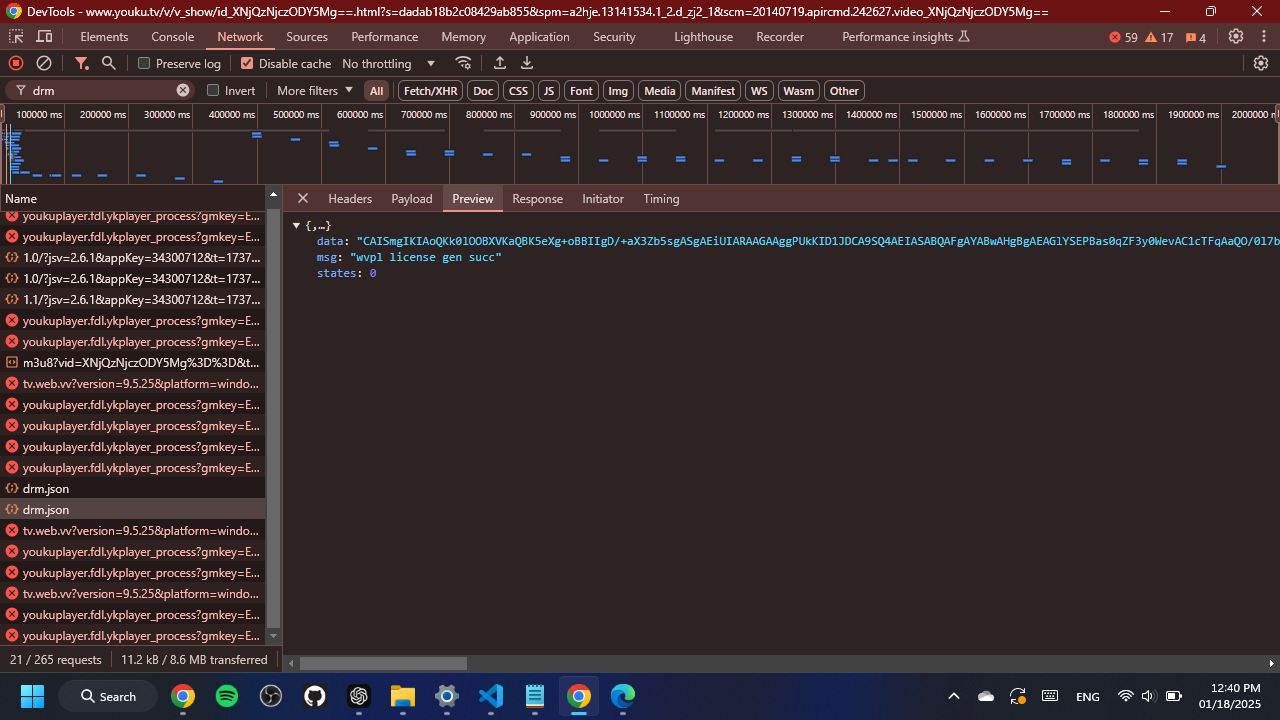

    But when i try to get the key, its returning
    Could not parse license_message as a SignedMessage, Error parsing message
    Then i look at the license server, it is says
    {"data":"default error","msg":"create wvpl session error","states":204}
    , instead of
    [Attachment 84949 - Click to enlarge]
    What is the main reason of this error? How to fix it

    oh, now i know the problem is. my wvd got revoked bcs i use android studio wvd. i change it into real device and now its work well
