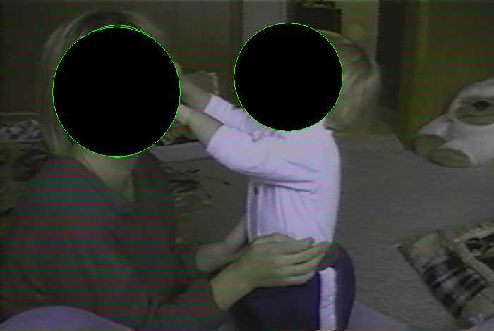

    Has anyone managed to capture video using a PAL60 VCR (JVC, definitely not NTSC4.43) using this card?
    There is such an option, but after switching to PAL60 in the device settings, the image is black and white. After a while, it automatically switches to NTSC_M.
    Of course, the TV does not see the problem...

    Although isn't it interesting that while using Phillips VR1100 I get exactly the same colour distortion as shown here in the first post, I captured NTSC tapes perfectly fine with RTV Blaupunkt 966, with the same set-up otherwise (Hauppauge USB-Live 2 and AmarecTV).
    I don't believe this is a multi-system model, so how is this possible?

    To be honest, I have no idea. I wasn't thinking much about it at the time, did not understand how it works. What I can say is that on Blaupunkt RTV-966, I digitised bunch of NTSC tapes perfectly fine.. and if that's a model that does not output PAL60 signal, but "regular" NTSC one, that's I think still useful and interesting information? I never heard it mentioned anywhere.
