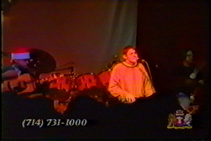

  1. Which of the following captures of the same frame from a VHS tape do you all prefer?
    Capture 1:
    [Attachment 84816 - Click to enlarge]
    Capture 2:
    [Attachment 84817 - Click to enlarge]
    Here's the image slider version:https://imgsli.com/MzM4MjY2

  4. It's at least a second-generation dub of an antenna broadcast from the 90s, so you're right that the captures are both bad. I thought the second capture with sharpness set to 2 on my ATI USB 600 was better, take a look at the detail on the drums for instance. But I am still pretty new to this so I wanted some more expert opinions! Thanks.

    There are no more details in the second, it has just more ... sharpening. I prefer the second, but is a personal taste, especially if you do not plan a post processing. With AviSynth both can be marginally improved, and I think that does not make much difference from which you start. Maybe with the second you need higher denoise and less sharpening in post processing, but is just a speculation.

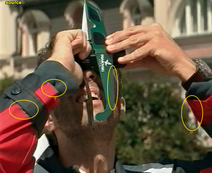

  9. 2 is the sharpest but has chroma displaced down/left. Can be fixed in post.
    (The chroma displacement is also present in the softer 1 and 3 but less eyecatching)

  10. Originally Posted by Sharc View Post
    Is the ChromaShift plugin for Avisynth the right choice:
    http://avisynth.nl/index.php/ChromaShift
    Would you agree that it is off by 4px left and 2 px down?
    ChromaShift(C=4,L=-2)
    Is chroma displaced unique for each tape, or it is tied to my VCR in general?

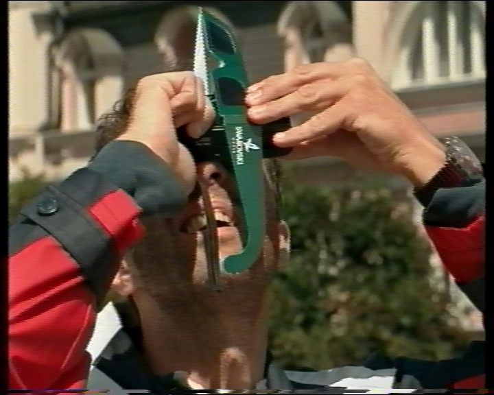

  20. Originally Posted by Sharc View Post
    Would you say the chroma displacement is fixed?
    [Attachment 84895 - Click to enlarge]
    I ended up not using the plugin, as it was only for 32-bit systems.
    So I used the overlay function directly:
    HTML Code:
    Overlay(Last.Greyscale(),Last,X=6,Y=-1,Mode="Chroma")
    Is this a valid solution too?
