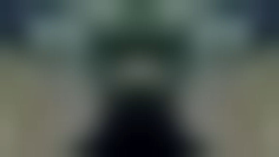

  3. I was about to suggest something similar to jagabo, but as he beat me to it I thought I'd just add....
    If you want the background more symmetrical, which might be less distracting, try flipping the video over and blending it into itself first.
    Just a frame from a video I happen to have open.
    BilinearResize(24, 12)
    Blur(1.0)
    Spline36Resize(1280,720)
    [Attachment 84962 - Click to enlarge]
    V = last
    Overlay(V, FlipHorizontal(V), Opacity=0.5)
    Blur(1.0)
    [Attachment 84963 - Click to enlarge]

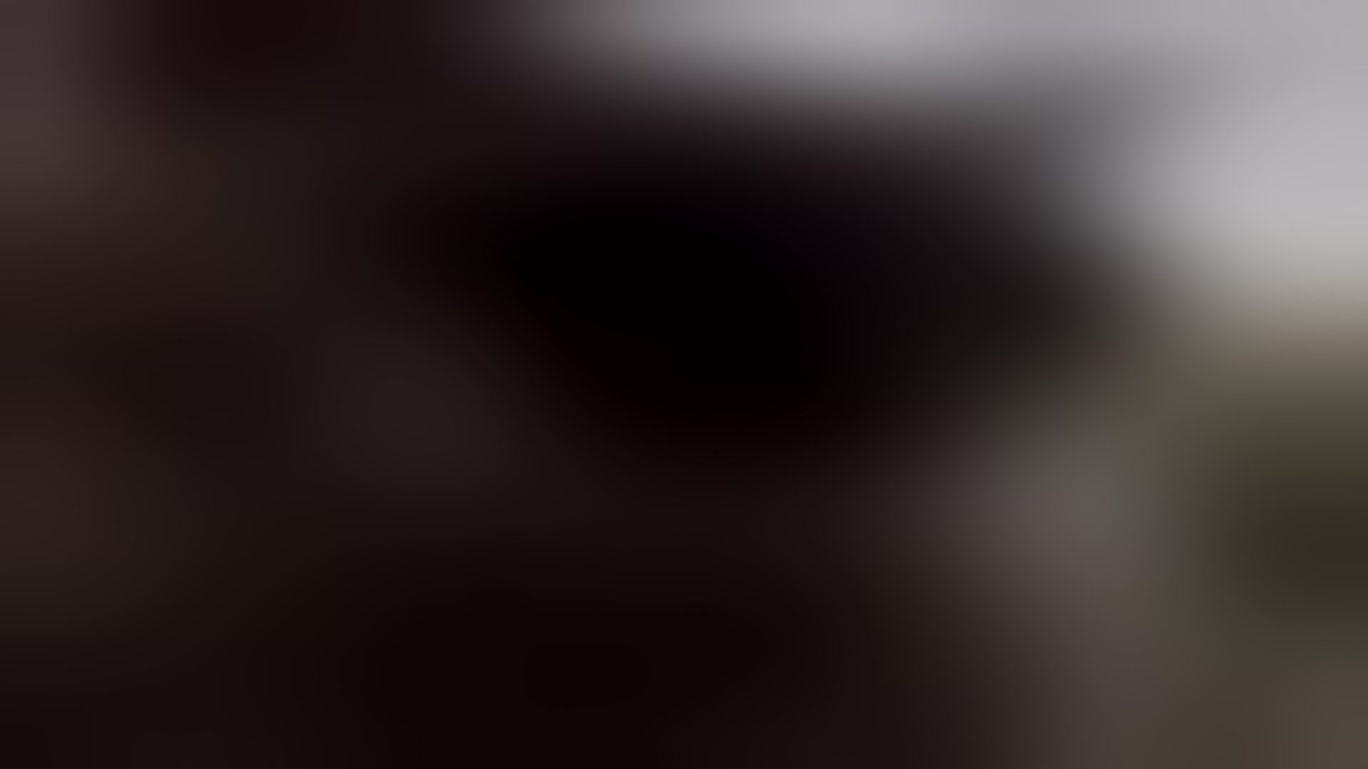

  5. so finally
    this is me
    [Attachment 84969 - Click to enlarge]
    using:
    LoadPlugin("v:\automazioneclip\AviSynth\LSMASH_AGO_2023\x64\LSMASHSource.dll")
    LWLibavVideoSource("C:\Users\Administrator\Desktop\Nuova cartella (6)\catLearn.jpg")
    function QGaussBlur(clip C, float radx, float rady)
        return C.BilinearResize(
        \           Max(16, _mod(2, Float(C.Width)/radx)),
        \           Max(16, _mod(2, FLoat(C.Height)/rady)))
        \       .GaussResize(
        \           C.Width, C.Height, p=19)
    function _mod(int m, float f)
        x  = (m>0) ? -1 : 1
        m  = Max(1, Abs(m))
        sg = Sign(f)
        i  = Round(Abs(f))
        return sg * Max(0, i + x * (i % m))
    function f2c(float f) {
        return Round((f - 1.0) * 256.0)
    #LoadPlugin("C:\ ...   path   ... \AddGrain.dll")
    #LWLibavVideoSource("catLearn.jpg")
    GaussResize(1920, 1080, p=19)
    blur = 100
    gain = 0.9
    blue = 0.2
    noise = 3
    sat = 0.5
    QGaussBlur(blur, blur).QGaussBlur(blur, blur)
    ColorYUV(gain_y=f2c(gain), off_u=blue, cont_u=f2c(sat), cont_v=f2c(sat))
    AddGrain(Float(noise), 0.22, 0.22, constant=1>0)
    this is the final result 1

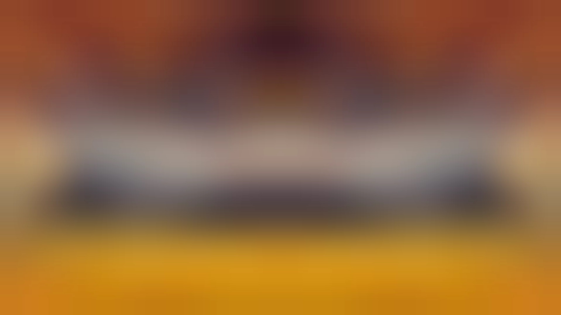

    this is the result 2
    [Attachment 84971 - Click to enlarge]
    using:
    V = last
    Blur(1.0)
    Spline36Resize(1920,1080)
    this is the result 3
    [Attachment 84972 - Click to enlarge]

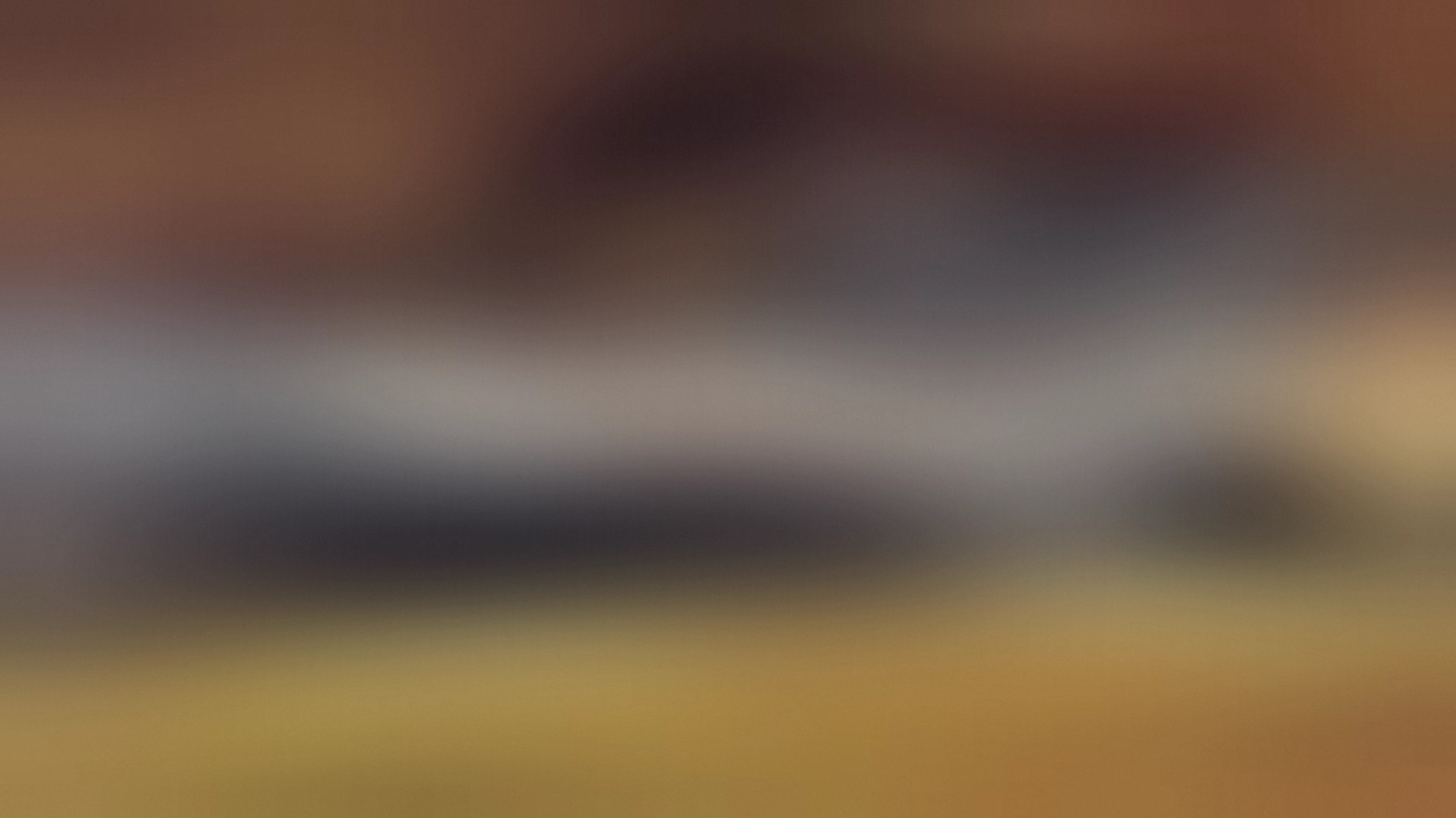

    the cat thanks everything and asks: considering that this should be the background to "animate" a possible photo of the cat in the center of the screen could there be a better alternative? otherwise it seems to me that in some way these results could also be fine

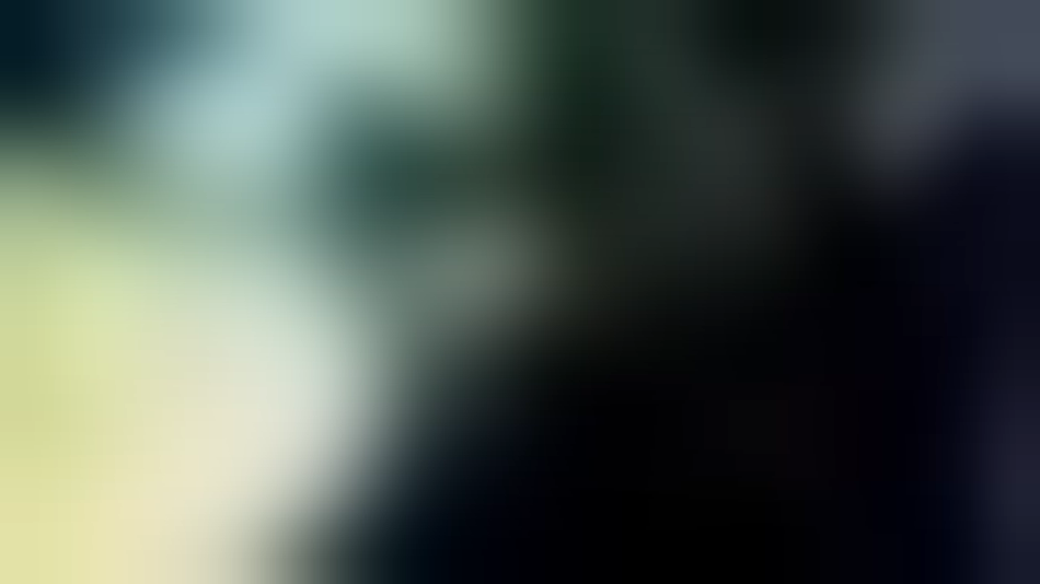

  19. Image

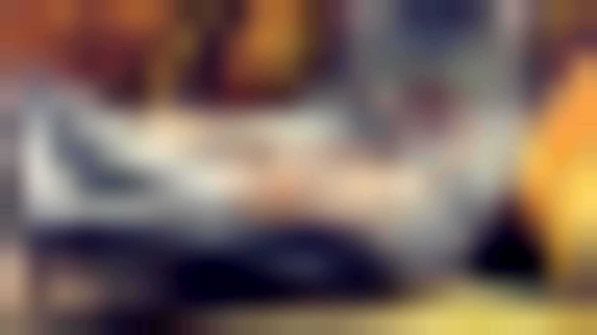

    [Attachment 85401 - Click to enlarge]
    if someone can help a cat
    import("v:\FuzzyBorders.avsi")
    LoadPlugin("V:\BestSource.dll")
    BSVideoSource("C:\Users\Administrator\Desktop\me\me.jpg")
    blur = 100
    gain = 0.9
    blue = 0.2
    noise = 3
    sat = 0.5
    ConvertToYUY2(interlaced=false)  #converting RGB to YUV
    ColorYUV(f2c=true, gain_y=gain, off_u=blue, cont_u=sat, cont_v=sat)
    result is this:
    [Attachment 85402 - Click to enlarge]
    my target is to get the blurry background only, HD resolution 16:9. So I wonder: it looking good, but is there a way to have a little more quality? (I :mean a little less dithering, or a improve of quality?)
    thankss

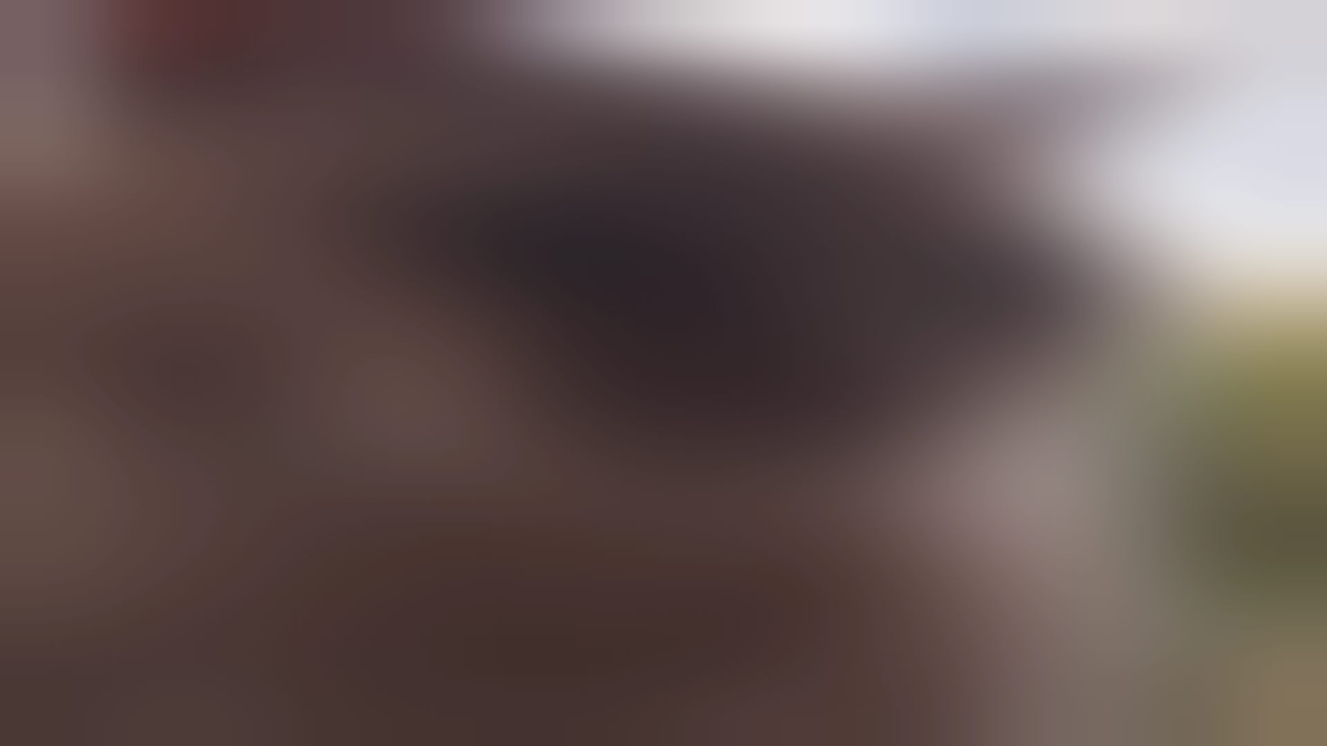

  20. Code:
    ImageSource("me.jpg", start=0, end=23, fps=23.976)
    ConvertToYV24()
    ConvertBits(10)
    # adjust colors and levels here if you want
    BilinearResize(16,16) # you can make the image blurrier by using smaller sizes here, clearer by using larger sizes
    Blur(1.0)
    ConvertBits(8, dither=0) # only if you need 8 bits
    [Attachment 85426 - Click to enlarge]
