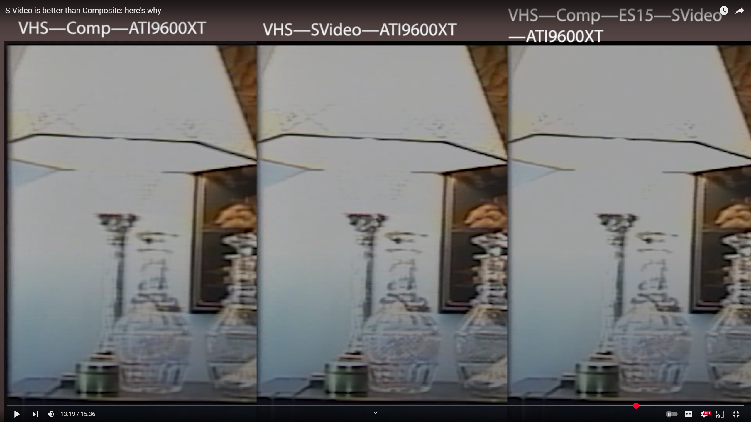

    This video illustrates just that, This link starts from the money shot but you can watch the entire video if you would like. The portions of the frame are labeled accordingly, so look at the glass bottles middle band and see how S-Video out has more details compared to composite out.
    May 2005
    Australia-PAL Land
    Hmmm, I'm, not seeing a significant difference. $500 worth (for an S-VHS VCR with now-unknown-quality heads)? And is the difference going to stand out when the video is running, as opposed to pixel-peeping at stills? I'm not sure that it will.
    [Attachment 85279 - Click to enlarge]
