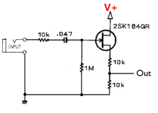

Why I am looking for an expert is because I need this diagram to be shown in stripboard format. I am a beginner so I can't do it myself:
[Attachment 84802 - Click to enlarge]

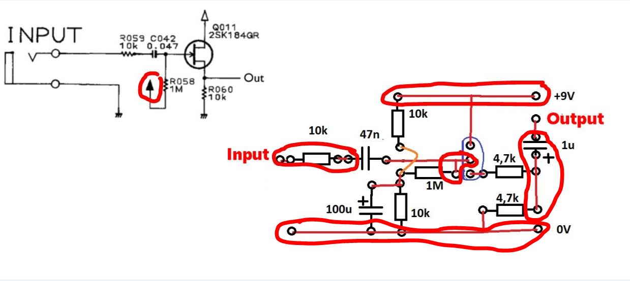

Besides if you link guides, I don't mind. But the problem is, I noticed most guides assume you have a basic knowledge of electronics, and they don't describe stuff that those people who have no clue about electronics don't know. However, I noticed the essential things needed to convert the block diagram to stripboard design is knowing how the routing situations look on the stripboards. Now that is what most guides don't really show one by one, that information is scattered among lots of different guides. So, if you know any guide that focuses on the routing situations only and shows how the different ones look on the stripboard, that kind of guide would be very useful for me. For example, here are 2 other circuits on this image. I encircled the routing situations that I would like to see how they look on the stripnboard. If I could see them, I could already start converting simple block diagrams myself:
[Attachment 84803 - Click to enlarge]

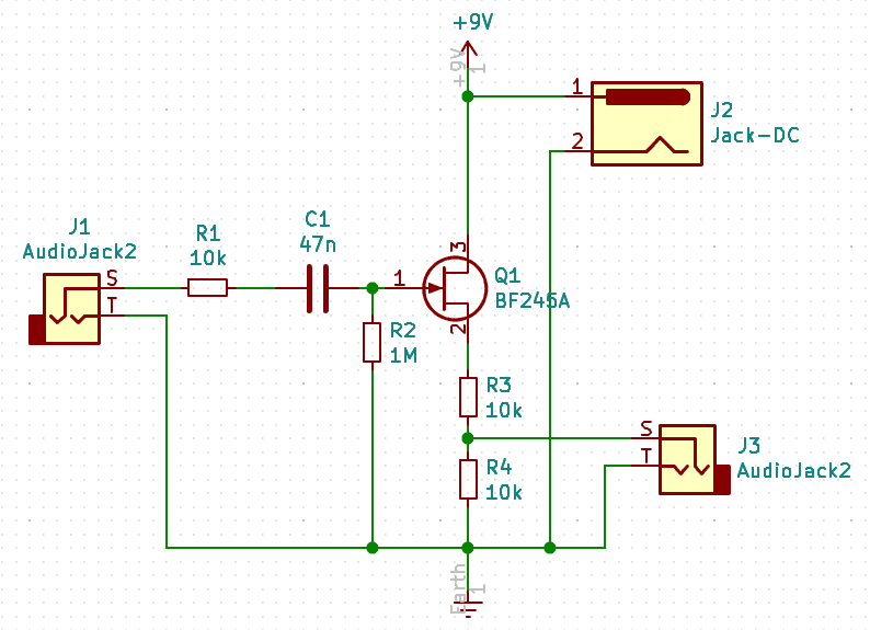

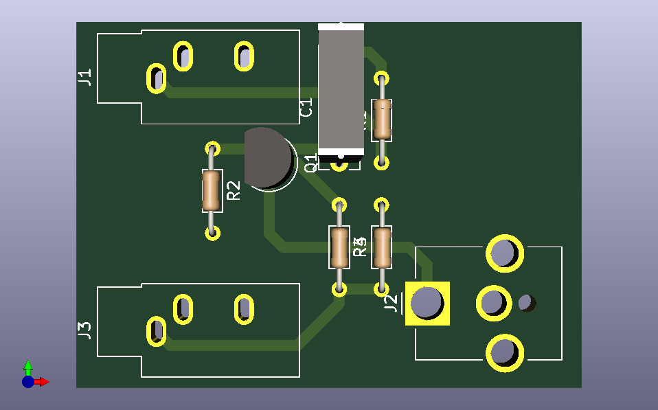

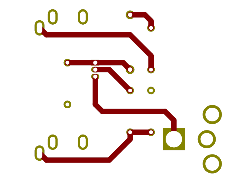

1 input, 1 output and 1 jack for power - this is based on description - "module between existing infrastructure" - use this as proposal not mandatory.
As pointed earlier it was easier to me made such thing in KiCAD than setting account on for example online EasyEDA or similar online CAD, just used parts from default library not even trying to make it as ready to be manufactured - also placed tracks on top side so it can be visible with components and i used THT parts not SMD so it can be easier for you to recreate it on veroboard. -

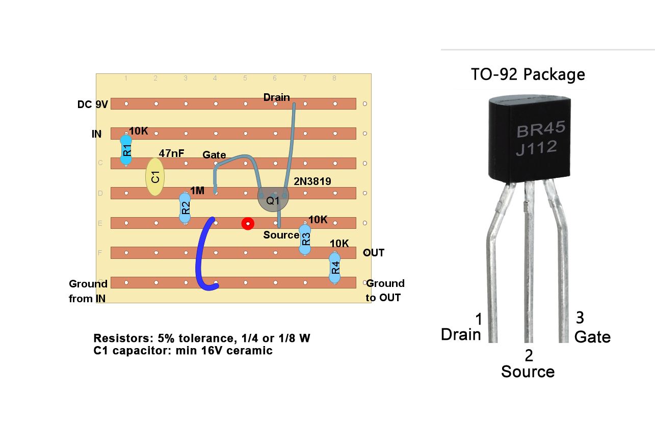

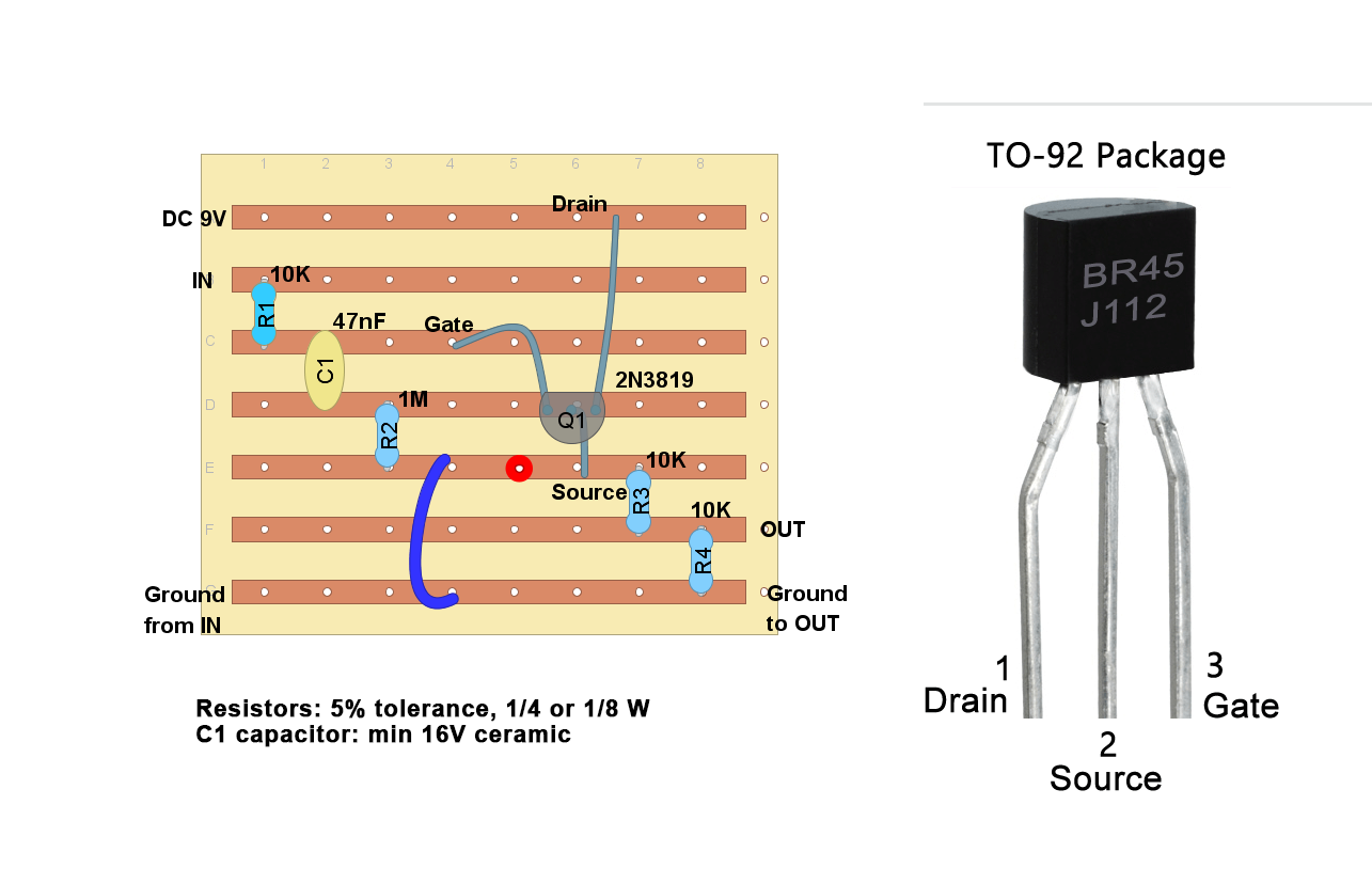

Could you check if my adaptation of that circuit is correct?:
[Attachment 85021 - Click to enlarge] -

From my perspective you should cut horizontal copper stripes to keep traces short as possible (to avoid many problems).
So going from R1 - rearrange it to horizontal position (current is vertical) - cut trace under, similarly with C1 - rearrange from vertical to horizontal, R2 may stay vertical, R3 and R4 also can be left in vertical direction. -
Okay but as I see that is the exact same arrangement like mine but only shorter stripes. I can do that even with my version too, getting rid of the unused segments with break points.
[Attachment 85030 - Click to enlarge]
What about the resistor and capaticor values and capacitor type? Some say ceramic is not suitable here. -
Nope - there are errors in your "PCB" - at least this is my impression - R1 in series with C1 feed signal to FET - in your previous "PCB" this was incorrect, in new one it may be fixed but populating R1 and C1 horizontally create this more obvious.
I didn't check values, also not simulated circuit so from my perspective you rely on unverified schematic.
Ceramic can be different - some ceramics are piezoelectric so they can act as microphone - use decent mylar (or comparable) capacitor - 47nF is quite small for audio so it may act as high pass filter (so in real circuit you may wish to increase it more). -
I wouldn't increase the 47nF, at the moment the 3dB lower frequency roll-off is only about 3.5 Hz so it wont have any effect on the audio but increasing it will increase risk of the JFET gate being damaged, they are very sensitive to static and excessive input voltage. Personally, I would still use a passive attenuator to avoid power problems. Notwithstanding the layout on the board, it will need screening and will need to be battery powered to avoid hum pickup and ground loop problems.
Brian. -
