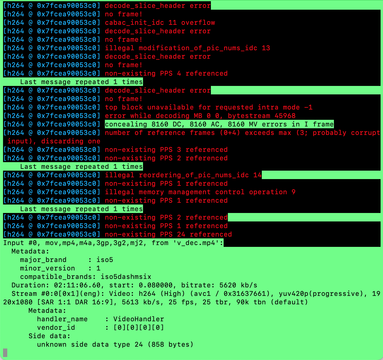

I downloaded DRM audio and video file from mpd link. After that I used cdrm-project site to get the key. Then used mp4decrypt to decrypt each of them (on my Mac):
macbook@macbooksmacbook bin % ./mp4decrypt --show-progress --key 57624cb3bdf5794c1eee91c627e3ffd7:bf938727cdb7d3f2e 38a561fe468989b manifest.mp4 v_dec.mp4
macbook@macbooksmacbook bin % ./mp4decrypt --show-progress --key 57624cb3bdf5794c1eee91c627e3ffd7:bf938727cdb7d3f2e 38a561fe468989b manifest.m4a a_dec.mp4

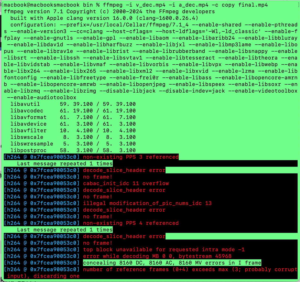

And lastly, I use ffmpeg to combine them:
macbook@macbooksmacbook bin % ffmpeg -i v_dec.mp4 -i a_dec.mp4 -c copy final.mp4
And I always get this error:
[Attachment 84749 - Click to enlarge]
[Attachment 84750 - Click to enlarge]
How could I fix this error? Any help please! Tk you very much!

1. are you sure the key is correct? you can play v_dec.mp4 and listen a_dec.mp4 (and audio is m4a no mp4. mp4 is a container vid+audio)

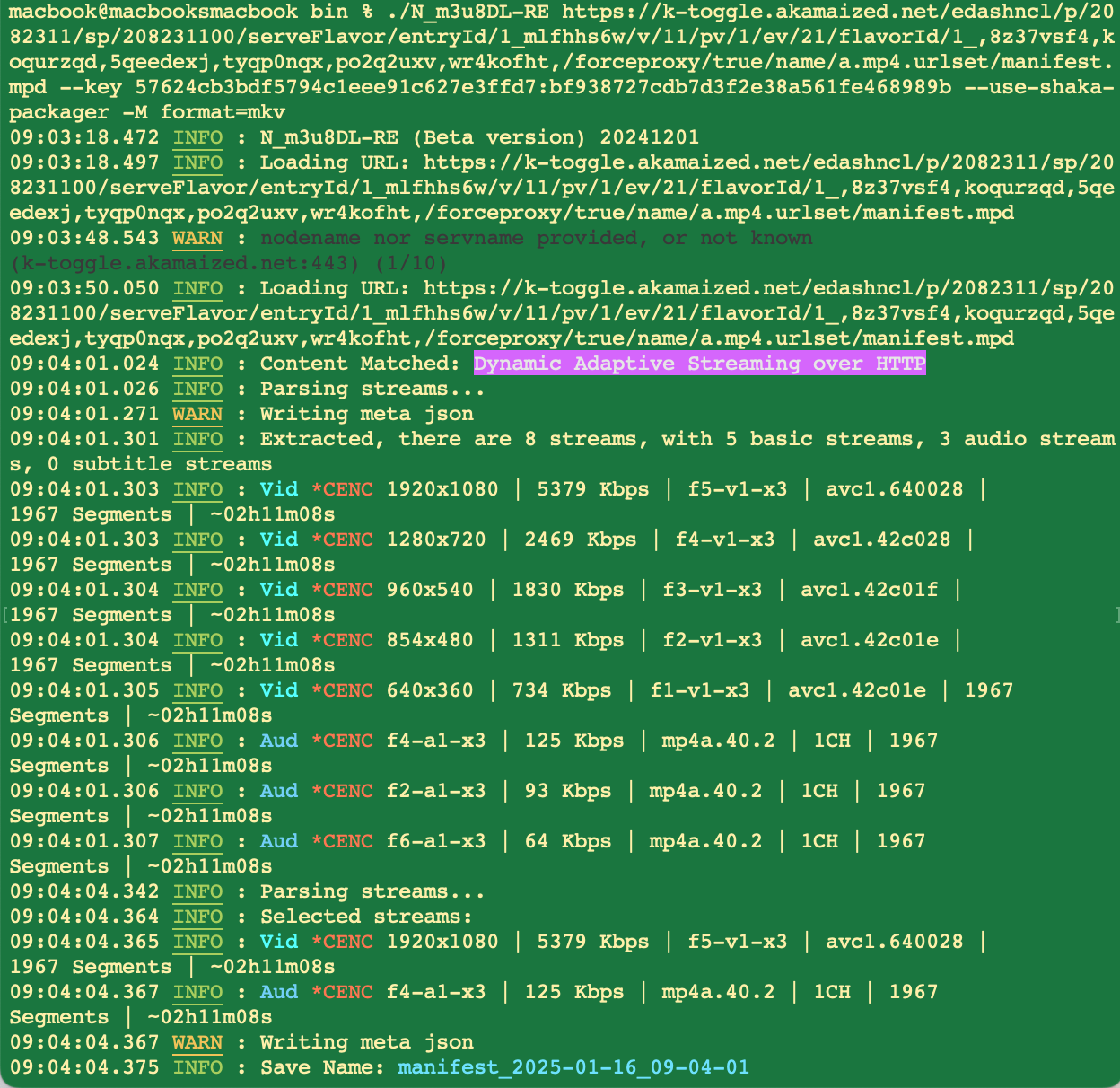

Sure, here is the mpd link:
https://k-toggle.akamaized.net/edashncl/p/2082311/sp/208231100/serveFlavor/entryId/1_m...t/manifest.mpd -
I also tried the app:
./N_m3u8DL-RE2 https://k-toggle.akamaized.net/edashncl/p/2082311/sp/208231100/serveFlavor/entryId/1_m...t/manifest.mpd --key 57624cb3bdf5794c1eee91c627e3ffd7:bf938727cdb7d3f2e 38a561fe468989b
it downloaded audio and video file but seems to be the same as previous download method.
How could I download and decrypt at the same time use N_m3u8DL-RE2? -

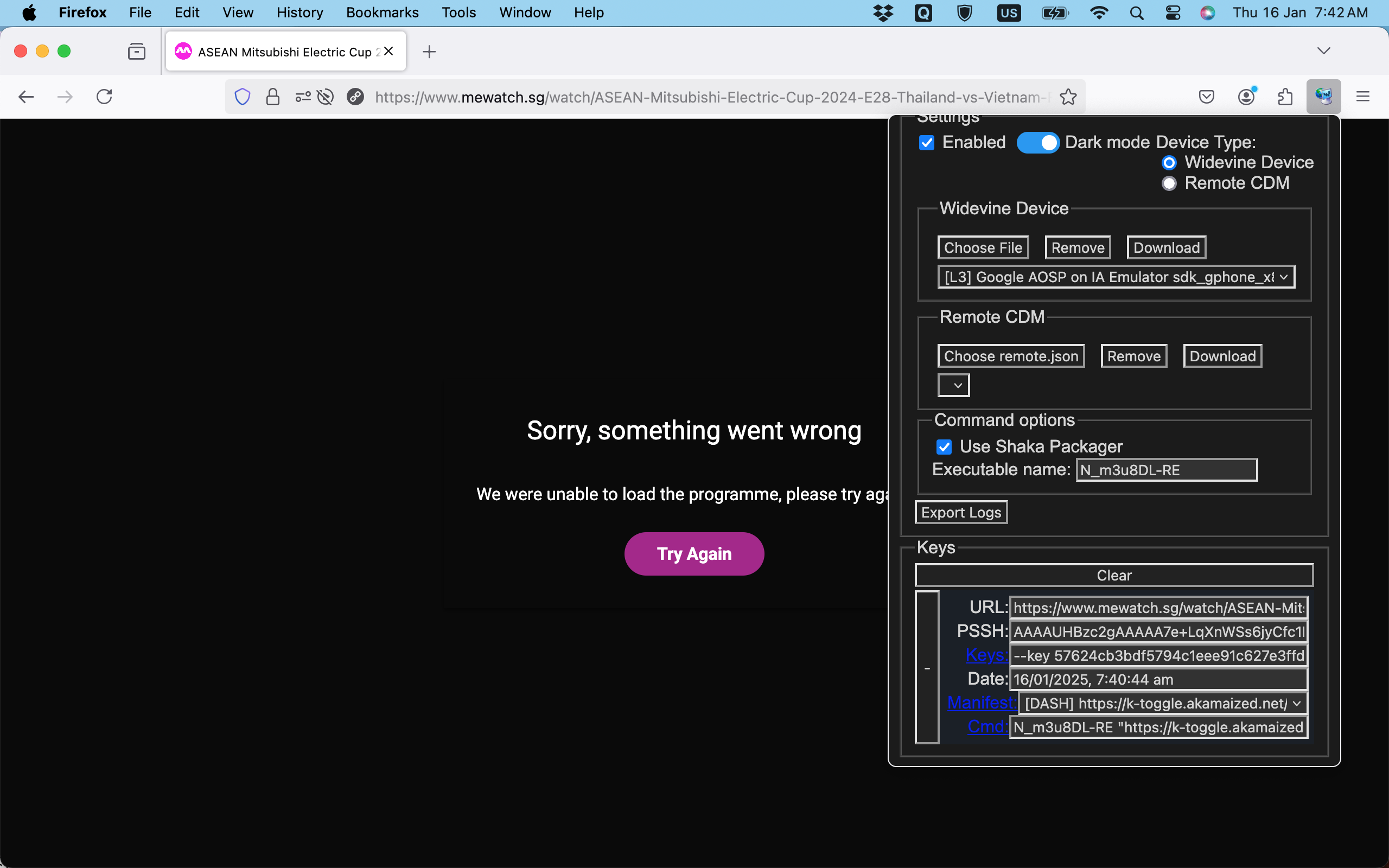

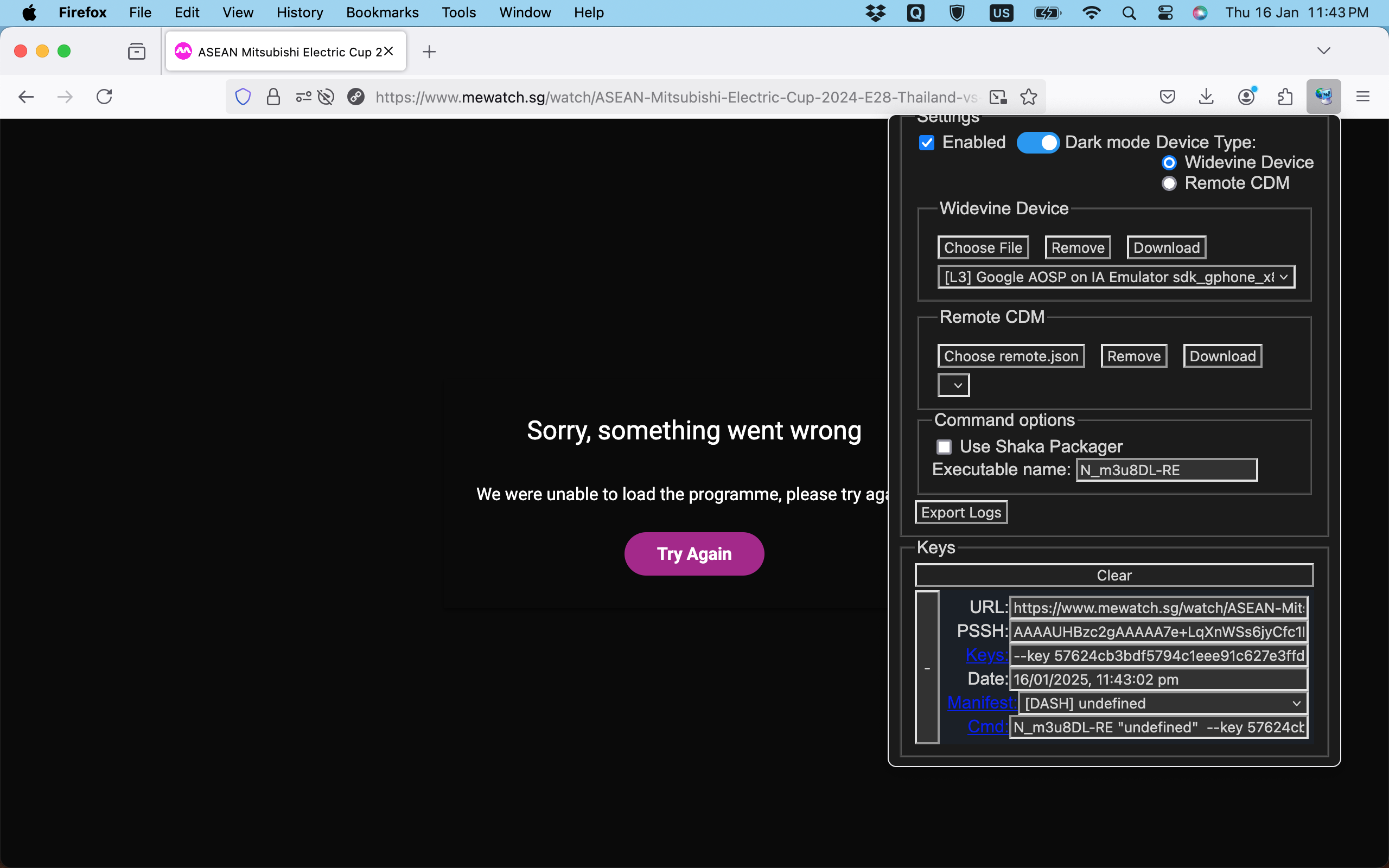

I tried again using WidevineProxy2 and it is exactly the same key, why your key looks different? Please refer to the screenshot below:
[Attachment 84849 - Click to enlarge] -

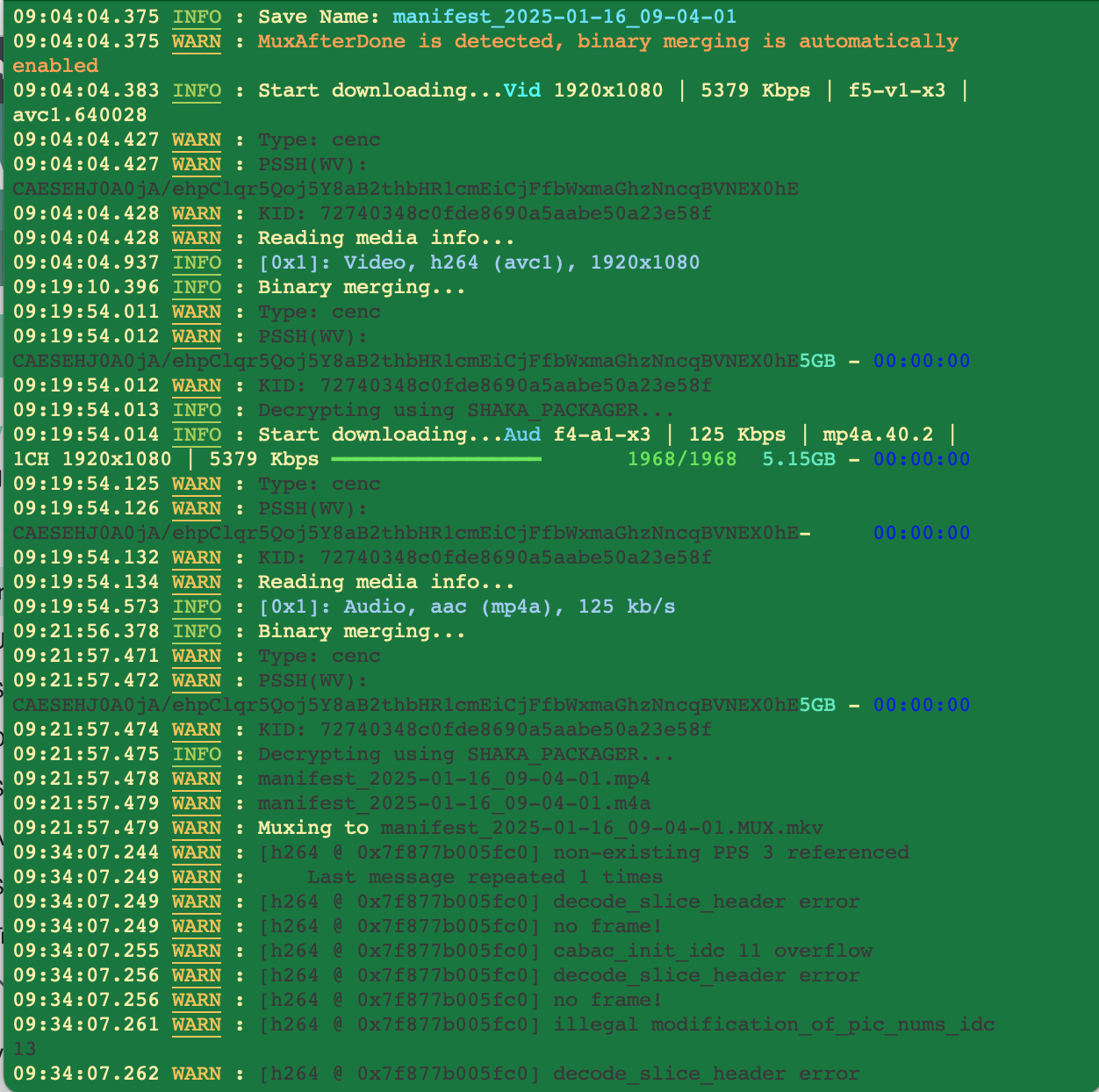

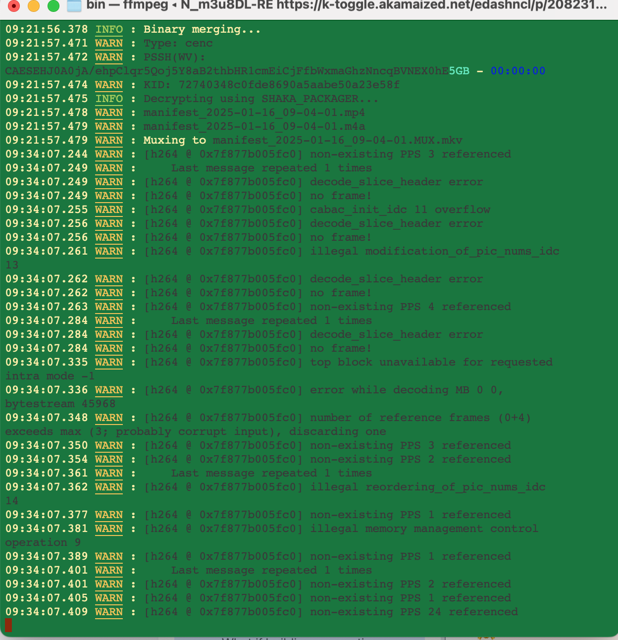

I tried another command:
./N_m3u8DL-RE https://k-toggle.akamaized.net/edashncl/p/2082311/sp/208231100/serveFlavor/entryId/1_m...t/manifest.mpd --key 57624cb3bdf5794c1eee91c627e3ffd7:bf938727cdb7d3f2e 38a561fe468989b --use-shaka-packager -M format=mkv
It also can download 2 files: audio and video but seems to face error as well, the process keeps going forever
[Attachment 84853 - Click to enlarge]
[Attachment 84854 - Click to enlarge]
[Attachment 84855 - Click to enlarge] -
wrong key, so maybe you mixed something, perphaps you posted another mpd not the correct one.
then, post the whole info you have from browser and widevine proxy2.
include title/video url in browser/ the pssh/key/mpd url/command widevineproxy2 give you
and we can compare if the mpd url match your provided in the begining:
Code:https://k-toggle.akamaized.net/edashncl/p/2082311/sp/208231100/serveFlavor/entryId/1_mlfhhs6w/v/11/pv/1/ev/21/flavorId/1_,8z37vsf4,koqurzqd,5qeedexj,tyqp0nqx,po2q2uxv,wr4kofht,/forceproxy/true/name/a.mp4.urlset/manifest.mpd

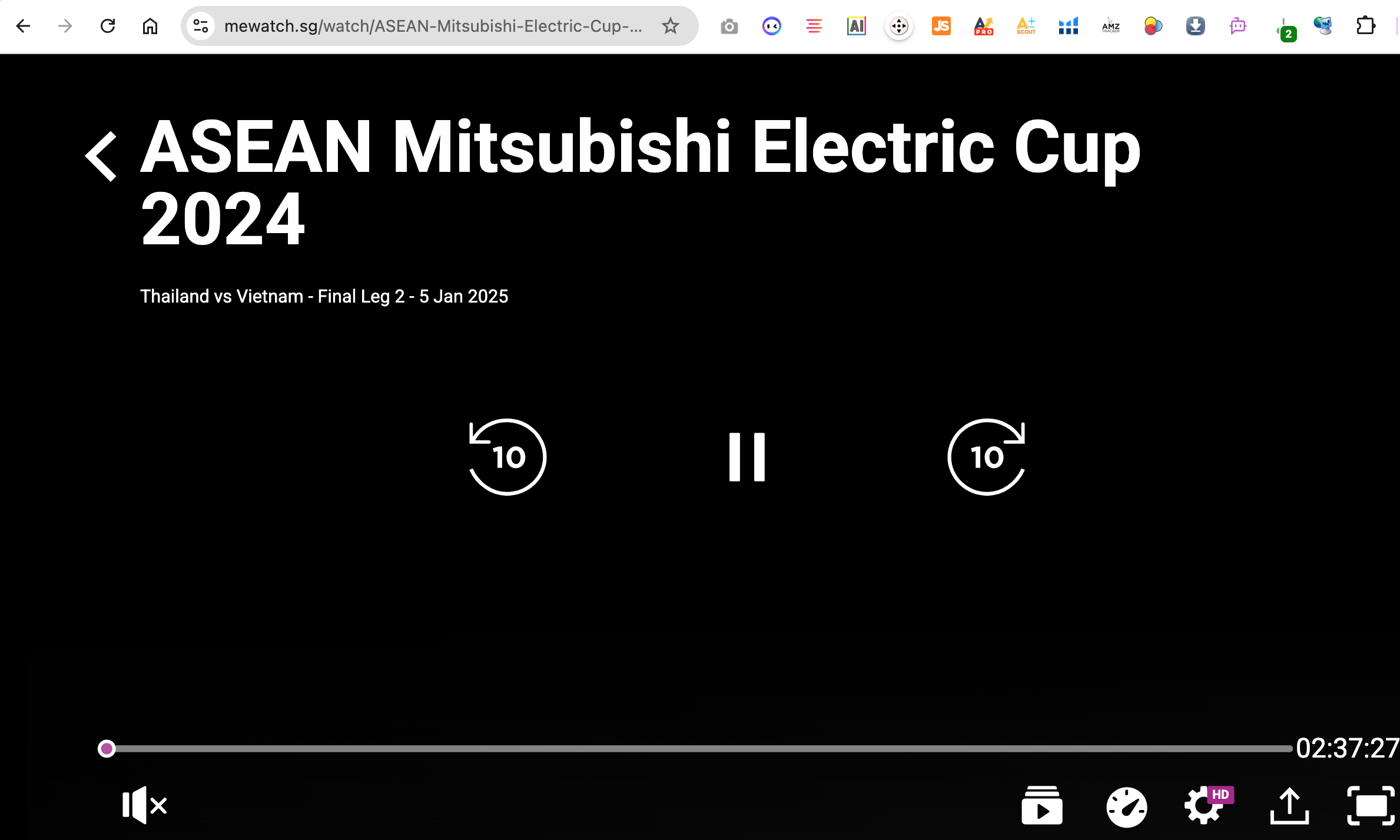

Here is the link:
https://www.mewatch.sg/watch/ASEAN-Mitsubishi-Electric-Cup-2024-E28-Thailand-vs-Vietna...?redirect=true
Here is the mpd I get manually from the website by inspecting on chrome:
https://k-toggle.akamaized.net/edashncl/p/2082311/sp/208231100/serveFlavor/entryId/1_b...t/manifest.mpd
And here is the screenshot
of the Title
[Attachment 84881 - Click to enlarge]
And the the pssh/key/mpd url/command widevineproxy2 give me
[Attachment 84876 - Click to enlarge]
The JSON log I get from Widevine proxy2 is attached.Last edited by nobtiba; 16th Jan 2025 at 09:53.
yes, you got something wrong, because you posted a wrong mpd url at #4 in this thread:
Code:https://k-toggle.akamaized.net/edashncl/p/2082311/sp/208231100/serveFlavor/entryId/1_bnlljx0i/v/1/pv/1/ev/14/flavorId/1_,metomoiq,msa0nkva,cnqfz5ve,95kcu7cc,6eidkzk1,8ohhfhk1,/forceproxy/true/name/a.mp4.urlset/manifest.mpd
Code:--key 57624cb3bdf5794c1eee91c627e3ffd7:bf938727cdb7d3f2e38a561fe468989b
use correct mpd and keys widevine proxy2 gived you it should work:
Code:./N_m3u8DL-RE "https://k-toggle.akamaized.net/edashncl/p/2082311/sp/208231100/serveFlavor/entryId/1_bnlljx0i/v/1/pv/1/ev/14/flavorId/1_,metomoiq,msa0nkva,cnqfz5ve,95kcu7cc,6eidkzk1,8ohhfhk1,/forceproxy/true/name/a.mp4.urlset/manifest.mpd" --key 57624cb3bdf5794c1eee91c627e3ffd7:bf938727cdb7d3f2e38a561fe468989b --use-shaka-packager -M format=mkv -mt
Thank you very much, @shellcmd and everyone else for helping me figure it out. What a mistake I made! It solved all the issues and it is working now. Now I know how to use widevine proxy2 too, that is a great tool! Good day everyone, tks again!
