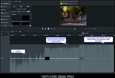

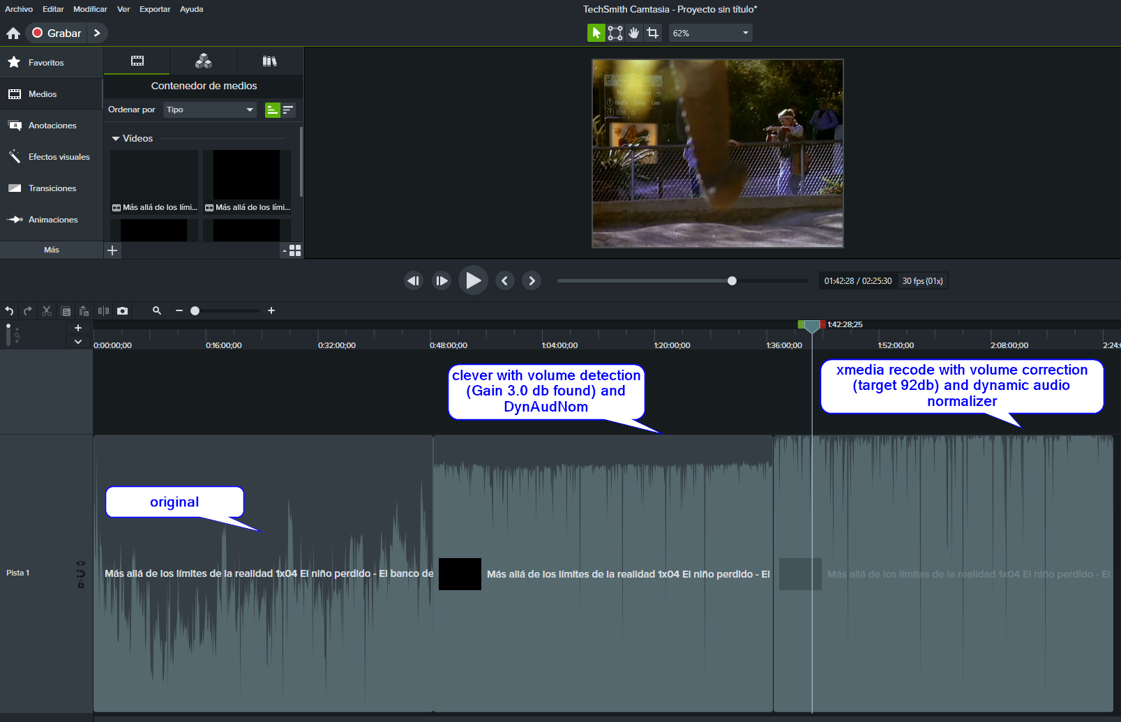

    camtasia: spectogram

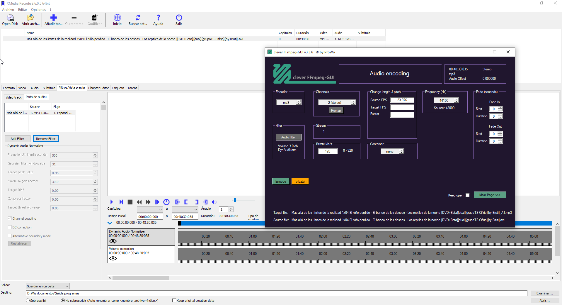

    xmedia and clever:
    I tested two: in Clever could I set the maximum decibels to reach? as in Xmedia. I think no
    I prefed Xmedia (It is more comfortable to use and I can set a target db).

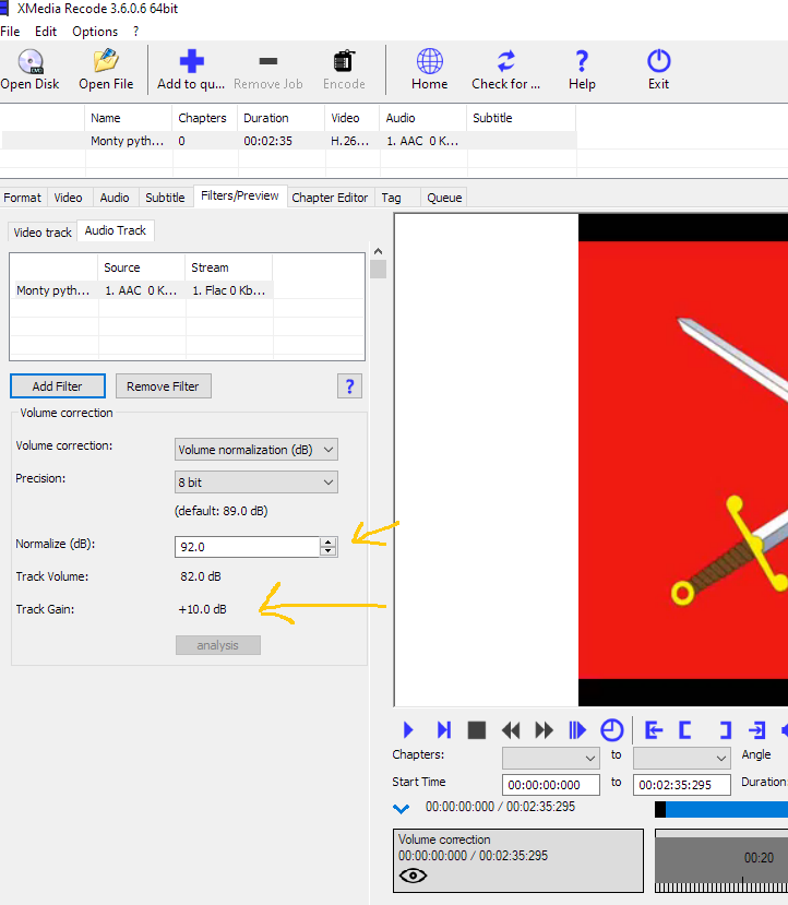

    DO you mean this? In this example, It tells you the current volume is 82db and that setting normalize to 92db is a 10db gain.
    This operation raises all sample levels the same amount, it's like a classic normailize.
    But it doesn't warn you if you set it too high causing the highest peaks to clip.
    This could be a problem
    yes, I mean this.
    Recommended is 89db I set 92db. when I see it in Camtasia the picture I dont hear peaks.
    I want two things (copying the video):
    a) leveling to a target (92db)
    b) normalize (after or before?) the volume
