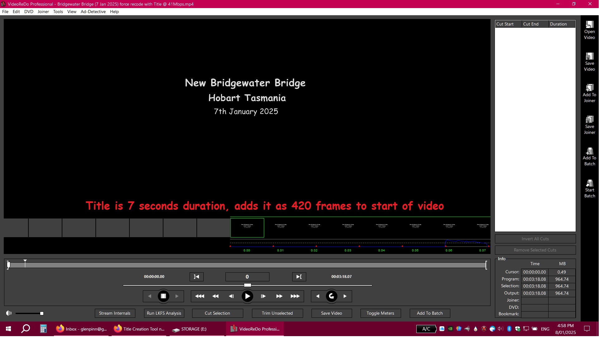

    Hi there, i was curious to find out if there are any simple to use Title Creation tools out there, one that can create simple text based Titles and/or end Credits for my 4k/60p HEVC camera files, and Smart Render back to Same as Source file.
    I use either VRD Pro or LosslessCut to cut my files and Smart Render them back to original format (Same as Source) and retain those as my master or archive copy, and in some cases i need to add a Title, sometimes a credit to the end as well.
    I have always used VRD Pro to do this work for me, however, up until the passing of Dan Rosen in 2022, VRD had not developed support for text or graphical based Titles to be added to 4k HEVC files and Smart Render them, this only works with my 4k/60p AVC files.
    I can however use VRD to add a Title and/or Credit and have it export to 4k/60p HEVC BUT only if i do a Force Recode to 4k/60p HEVC at a Bitrate the same or close to the Source File, and for me this is not really acceptable because it takes at least 10 times the duration to recode than what the video file duration is, and if i am going to add a Title/Credit etc and have to recode it, i would rather use the x265 encoder rather than Mainconcept that is used by VRD (i may be nit picking here) but that is my preference.
    I could do it a lot faster in VRD by using QSV or NVEnc as i have both Graphics in my Laptop, but i always prefer to use software encoding whenever possible.
    VRD uses a frame based Text or Graphical based Titles editor, rather than do it by overlaying the Titles onto the actual video frames at the start and/or end (which i don't like doing) so when i create a title and make it 7 seconds duration, the actual Title will result in 420 title or graphical frames being added to the start of my 60fps video file.
    Some software such as TMPGEnc Smart Renderer 6 will do titles, but they are overlaid onto the video frames, and TMPGEnc paid for software, i just prefer a free one instead.
    Any recommendations (if any) would be appreciated, as i don't think i have seen anything such as this kind of tool so far.

    EDIT: Maybe there is a way to convert my 4k/60p HEVC files to another lossless format that VRD does support so i can add titles/credits to, then convert back to the same as they were before.
