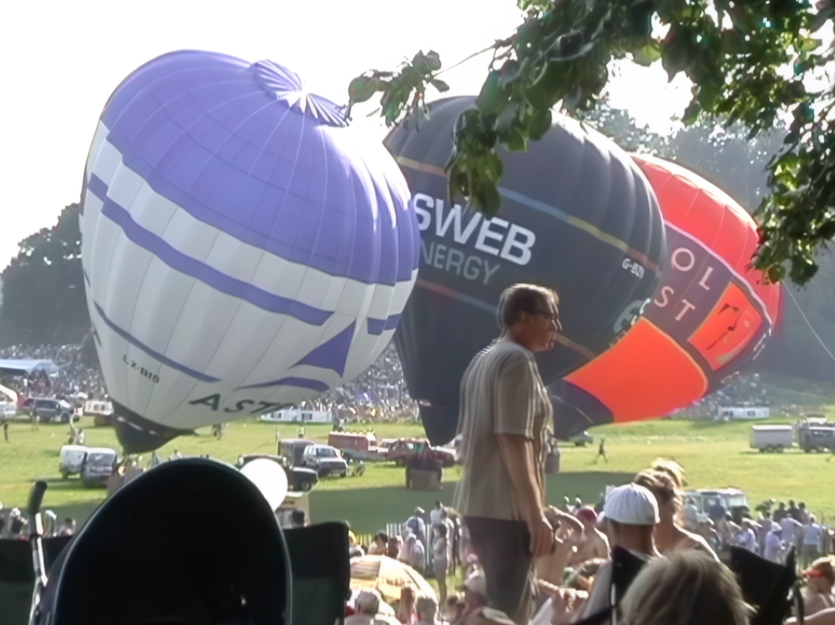

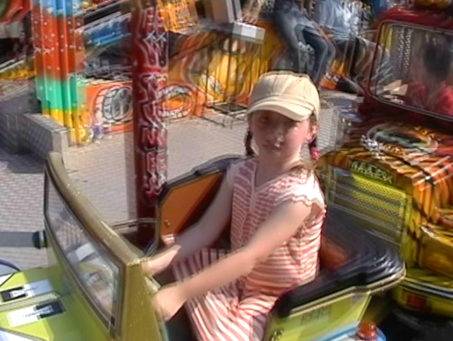

  1. I have old PAL Mini DV videotapes I am transferring in using the mini DV cable via a Canopus ADVC100 to my Mac Studio. It looks pretty good most of the time, nice and sharp, but on faster moving motion, the video displays a double ghost image and I'm wondering why. This is not interlace combing, but a ghost image, as pictured below.
    [Attachment 84656 - Click to enlarge]
    Here's another example which shows the slow moving balloons sharp, but the man walking by has a double image.
    [Attachment 84657 - Click to enlarge]
    When I view the video on my old DV camcorder screen and freeze frame, I don't see this ghost effect at all, so it's something to do with the transfer. I have tried using analogue instead of DV cable, but it doesn't help. Any idea why this is happening and how to fix it?

  6. Okay, I seem to have solved the whole problem in a way I did not expect. Importing using Quicktime is the culprit. Not the hardware or cables. If I import using Final Cut Pro, I don't get the ghosting. No idea why QT is doing this or how to fix it using QT. The problem with importing with FCP, however, is that it wants to break every single shot into a different file and with shaky camera movement, it seems to make loads of different files even though they are, in fact, the same shot. So is there an app for importing video which does it as one long file and does not create the ghosting QT does?

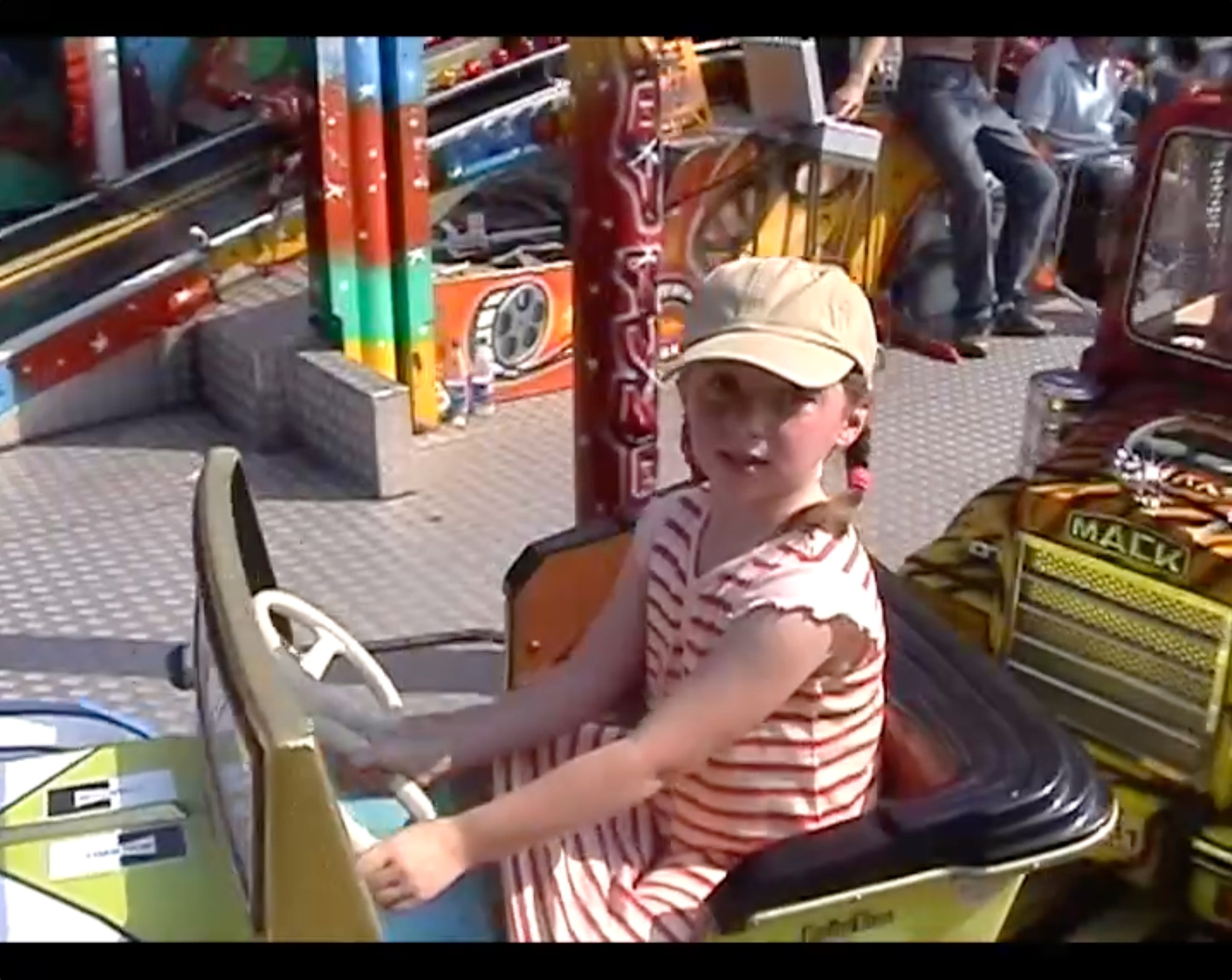

    Also, an odd thing. The file is PAL, so it's 720x576 25i. I created a project in FCP which is the same pixel dimensions, but when I output, I get black bands top and bottom, as pictured. Why am I outputting a different frame size? It shouldn't have any black bands.

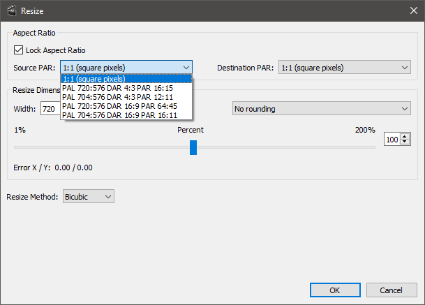

    Europe
    How about to try 768x576 resolution in FCP. Unfortunately i don't know this software. Avidemux got nice calculator in swresize to suggest resolution based on PAR.
