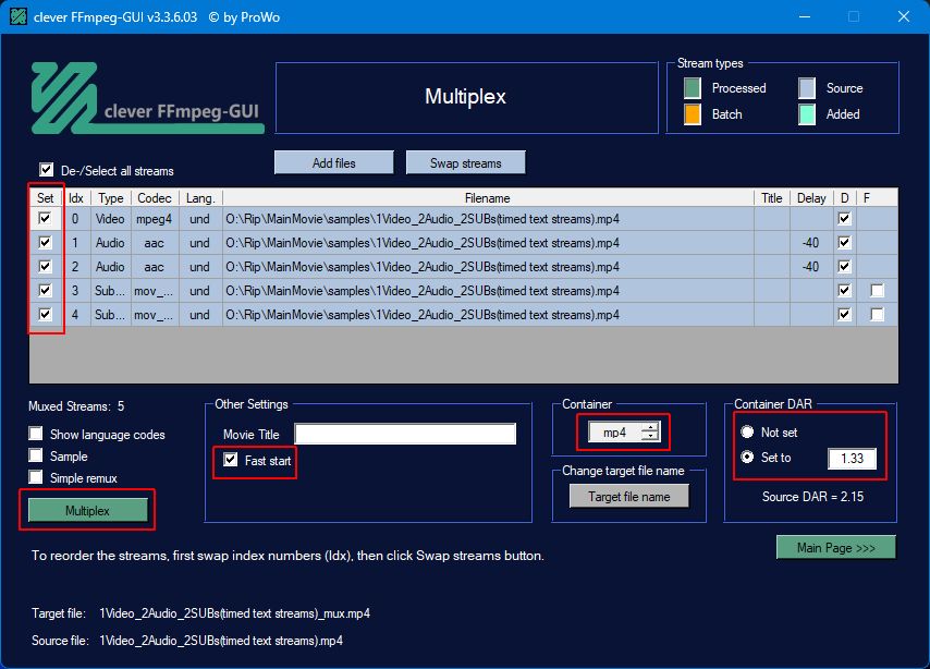

  3. Use clever FFmpeg-GUI.
    Load your mp4, click main page, click multiplex, set all like in the picture below and click multiplex. Done.
    [Attachment 84616 - Click to enlarge]
    Try the new created mp4 on your TV.
    If the display aspect is wrong, repeat the operation with 1.78 instead 1.33
