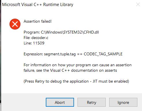

    Lately I've run into 2 files that have had a problem that when trying to deinterlace, I get an assertion failed error at the same point in the video. The first time I had to give up, and recapture the whole 2 hour tape. This is unreasonable, and not an acceptable solution, I should not have to recapture the 2nd tape, and keep doing multiple captures of tapes due to some idiotic bug that no one seems to be able to acknowledge or fix.
    I think the problem existed on the file before running through fixo - if I tried to deinterlace the file with out the index, it would just get stuck at that point and keep growing the new file indefinitely until I crashed it out, creating a difficult to delete large file.
    After running through fixo I have a playable file, but now at that point it keeps crashing with this error:
    [Attachment 84576 - Click to enlarge]
    Seems to be referencing the dll for the cineform codec I'm using for compression. Been using this codec for quite a while now without issues, so I don't believe there really is a problem with that dll.

    There are quite a few reports (Google search on "cfhd.dll") on this from Sony Vegas and Adobe users,
    the common advice seemed to be to delete that dll.
    Maybe you should read up on it yourself
  5. I read that, it makes no sense. Never in my life have I encountered an error with a library, that the solution is to simply delete the library. That file was put there for a reason, it's only causing an error on a small number of files - I don't want some bullshit unexplained hack, I want an explanation, and a real fix.
    Anytime I start messing around with .dll files, it might fix one thing, but break another. I have no idea what things I do are relying on that file. To simply "delete the file" is not an acceptable answer, unless there's some explanation for why, and a guarantee that anything relying on it will fail over to something else, consistently.
