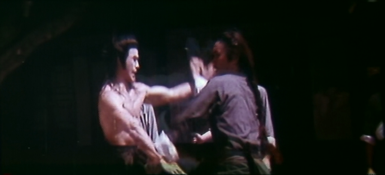

Also can this be fixed, see pic above his head.
[Attachment 84575 - Click to enlarge] -

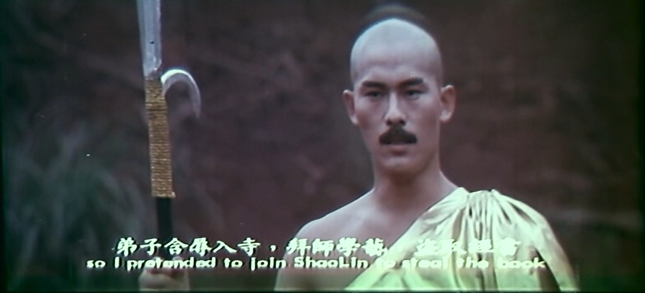

Also video has some kind of ghosting effect, how can this be fixed. See pic :
[Attachment 84614 - Click to enlarge] -
Did you look at the MP4 ? Looks like some dropped frames and jerky motion , with duplicated frames at the end in the MP4. Possibly from DirectShowSource, because those errors are not in the source sample
The VOB sample uploaded gives no field order transition errors. If the full VOB has issues, and "fix" gives problems, then try not to fix then test again . (You don't have to encode to test, just comment out most of the filters after IVTC and preview)
The ghosting/ blended frames in the screenshots are not in the sample(s) . No idea if you can fix them easily

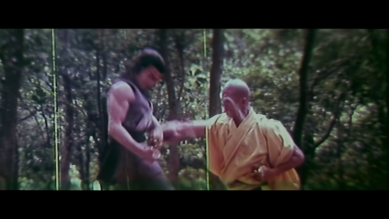

Overall the picture looks soo much better now with alot of the constant dust/ dirt being removed. I still have some annoying screen vertical scratches which appear at some scenes for 5/10 seconds. I would like to attempt to remove them if possible. See pic for vertical scratches. What can I do for them green Scratches. Any suggestions ?
[Attachment 84672 - Click to enlarge] -
DeScratch might work if you adjust the settings.
