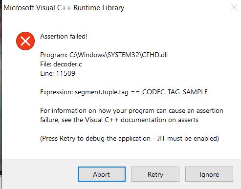

  5. Now every time I try to deinterlace, virtualdub gives me this bullshit error.
    [Attachment 84574 - Click to enlarge]
    Getting sick and tired of my time being wasted by idiots that can't recommend working apps, and programmers that can't fix long standing problems with their apps.
