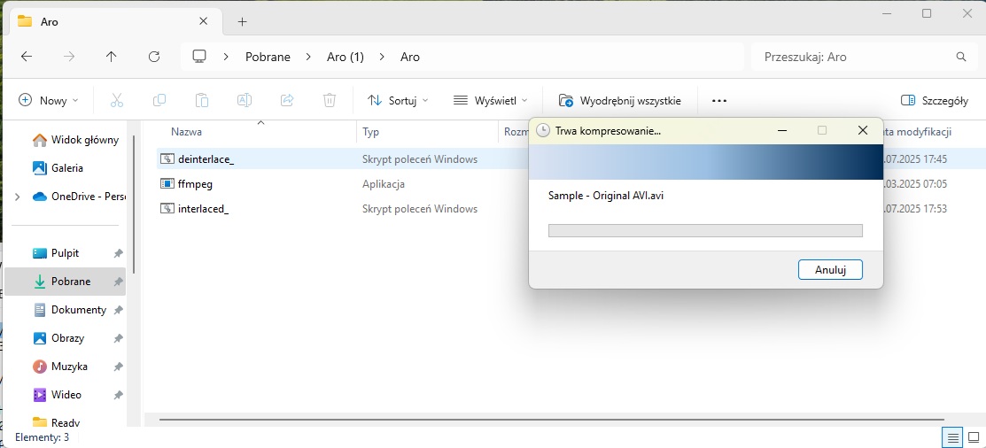

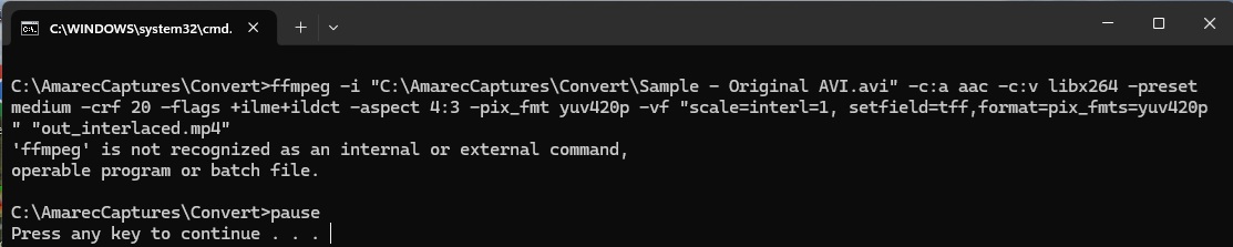

  6. That snippet looks very good. Does that tool fix the aspect ratio automatically as well? I see it's 4:3.
    I have some issues getting it to work. Should it be fine on Windows 11?
    [Attachment 87788 - Click to enlarge]
  7. Yes on w11. Seems you didn't follow my instructions.
  8. Originally Posted by Sharc View Post
    I read it couple times and I can't figure out where could I be going wrong.
    The compression seems to be starting if I don't unzip it, just "open" it where it is - but then in that folder I just get a copy of the same size AVI file in the Aro folder.
    [Attachment 87789 - Click to enlarge]

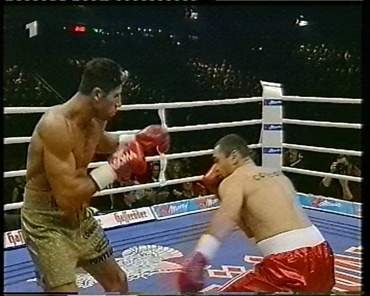

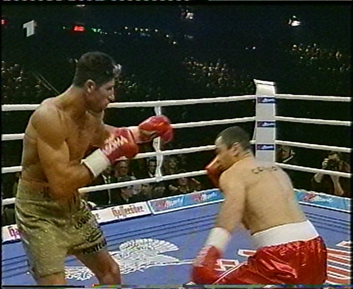

    Yes. In AviSynth it is ConvertToYV12(interlaced=true) vs. ConvertToYV12(interlaced=false). If you don't specify true/false it will default to false.
    blended chroma:
    [Attachment 87797 - Click to enlarge]
    normal chroma:
    [Attachment 87798 - Click to enlarge]
    Note the red glove at the bottom center. The red "shadow" to the left of the glove is blending of the colors from the previous field.

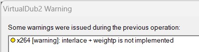

    Just tried that (on your suggestion).
    Handbrake: no change, still reads as Prog but is Interlaced.
    VDub2: file now reads as MBAFF, Interleaved, TFF but threw an error message:
    [Attachment 87799 - Click to enlarge]
    The file seems to play OK.
