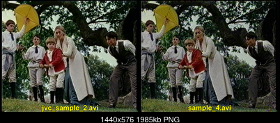

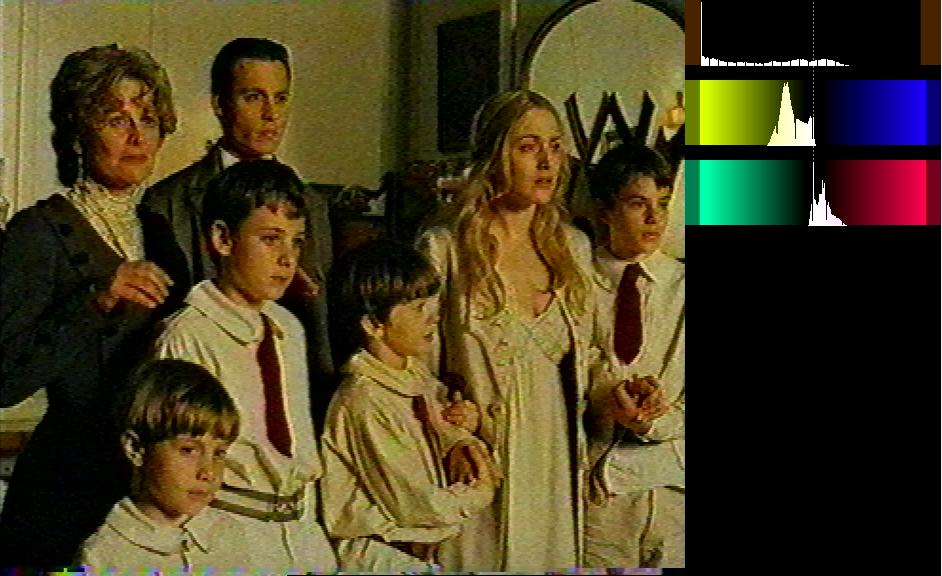

    No more gaps in the histogram (still some accumulation for dark levels):
    I prefer the default values in term of general look, but is a personal taste. You can change the parameters/levels as you prefere in post-processing. Use the procamp only to stay inside the capturable range (and in a reasonable "good" overall look).
    Now you should have all the elements for a good capture. Enjoy your captures!!!

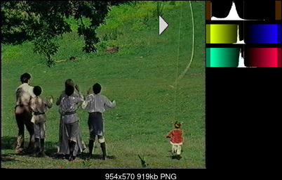

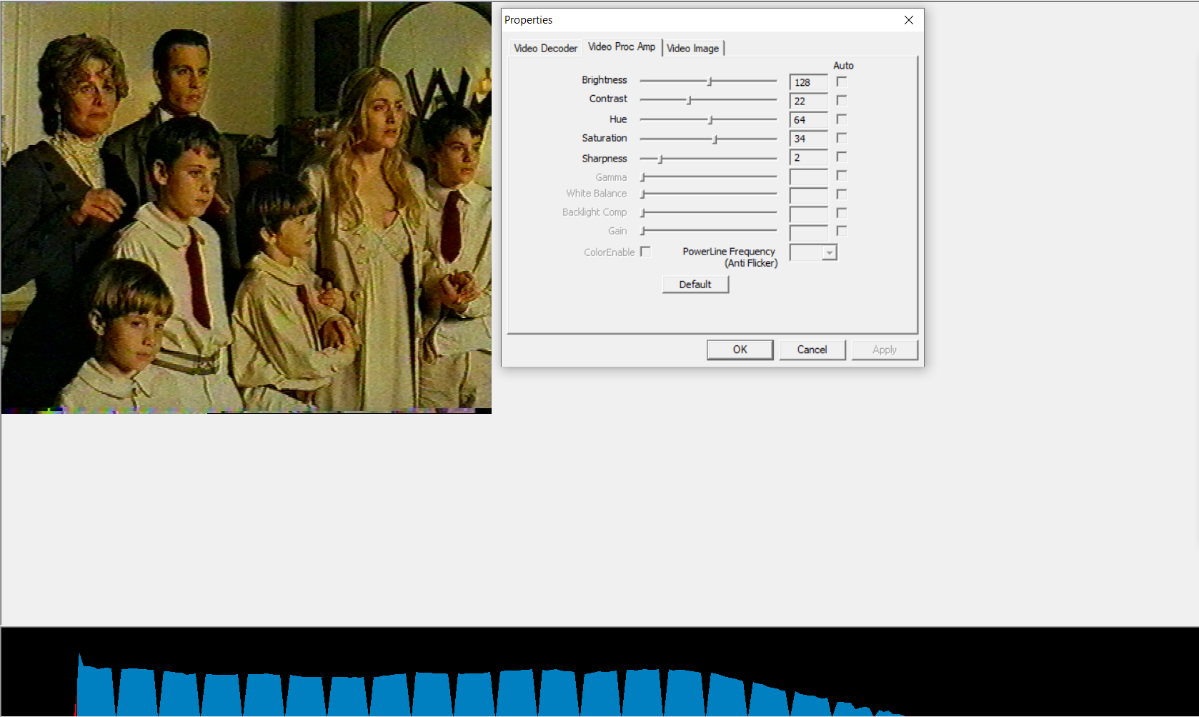

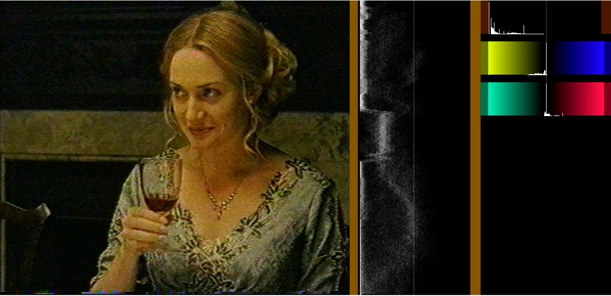

  2. Image
    [Attachment 84627 - Click to enlarge]
    Your darks are partially clipped. Clipped video can't be recovered in post. Perhaps increase the brightness a few notches (2...4 steps) for capturing.
    Edit: oops, lollo has already commented.

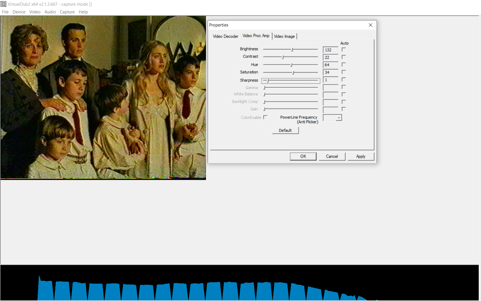

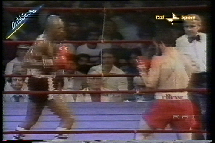

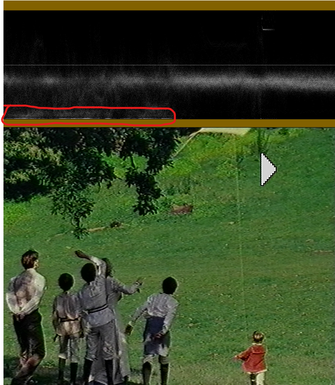

    Thanks both for help! So far with every tape I’ve tried to capture, I see horizontal lines at the bottom regardless of the VCR I use. Is this normal?
    [Attachment 84628 - Click to enlarge]
  4. Originally Posted by tko4 View Post
    Yes, this is normal for tape captures. It is called "head switching noise". If it annoys you can just crop it off in post. Same for the left an right small black pillars. Just take care to keep the aspect ratio intact when cropping and/or resizing.
    @tk04, you can see the "too-dark" clipping on your VDub histogram in post #30. The Brightness (left end) is hard up against the limiter. Increase the brightness until the edge just starts to move right (in my experience, it's best to have just a slight bunch-up on the limit, not as much as yours). After you've done that, increase the contrast to move the right end further to the right. Don't go too far though, and also visually check really bright areas to make sure they are not being "whited-out".

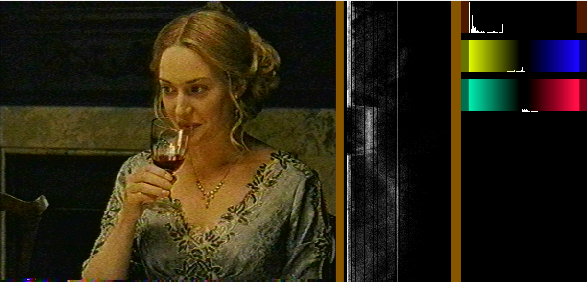

    I increased the brightness a few notches as @Sharc suggested and slightly increased the contrast.
    Histogram:
    [Attachment 84641 - Click to enlarge]

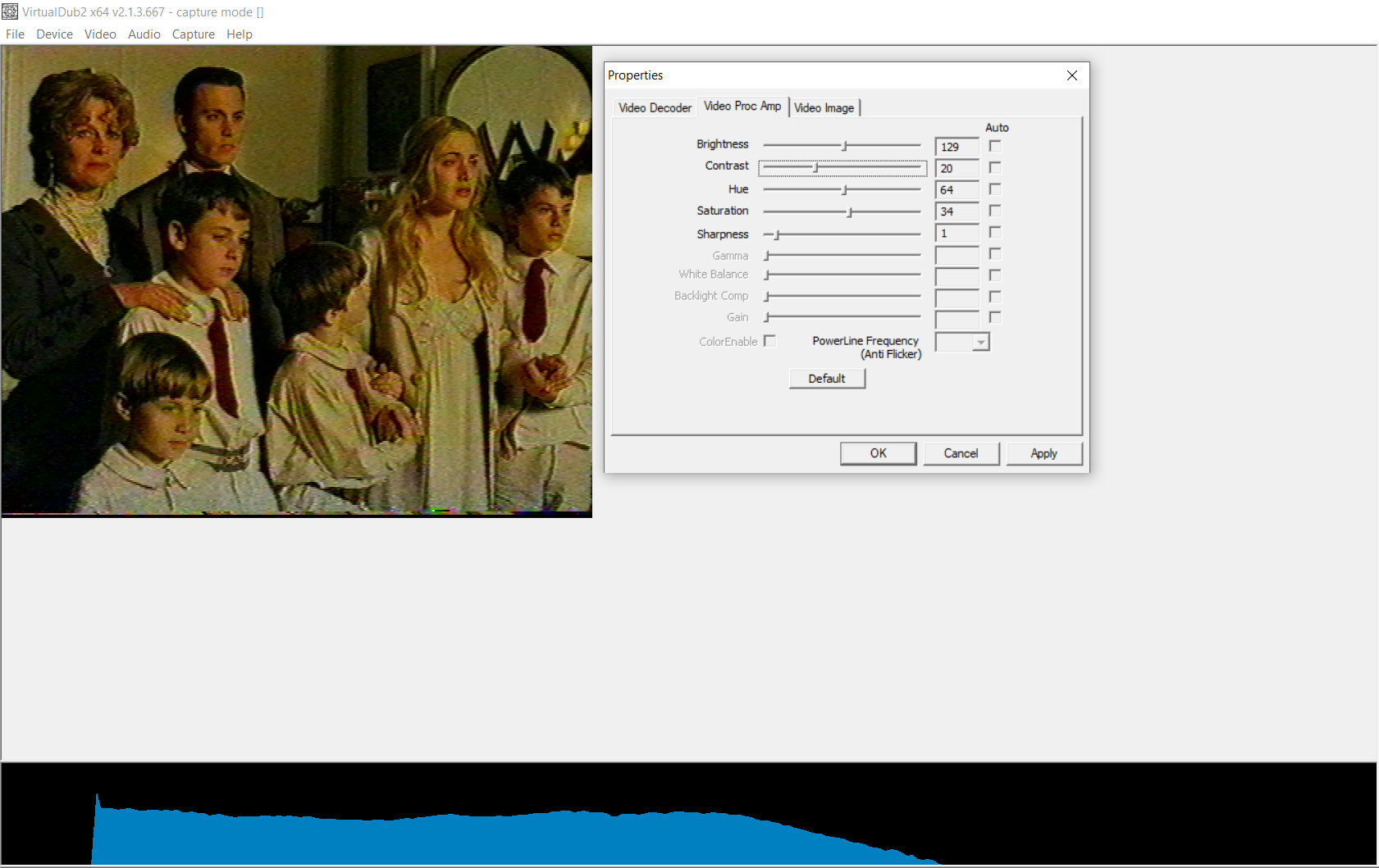

    What I was using (129 Brightness is just after the red limit):
    [Attachment 84644 - Click to enlarge]
    Isn't the purpose to stay withing the Y=16? Sorry If I'm asking a dumb question I'm new into this.
    Yes, but the numbers in the Proc Amp don't relate to the 16-235 limits as far am I am aware. They're just random values which change with every digitiser (as you can see from Lollo's version of the Live2).
    In your last example, it looks too dark to me. The boy's shirt looks like it is white but it is quite dim. And I still don't like that vertical left edge. I reckon you could crank up the brightness more, as well as probably some more contrast. There is a yellow haze over the whole video, but I do think it's still a bit dark.
    Are you into AVISynth? Because you could confirm the levels using an AVISynth histogram (as Lollo and Sharc have done above), or post a short sample of that last one for us to check.

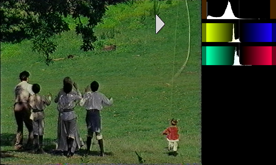

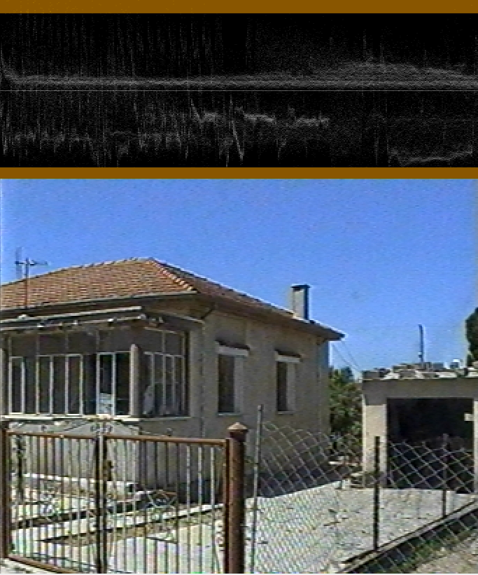

    I'm not an expert but it seems the histogram from AVISynth is pretty close.
    [Attachment 84650 - Click to enlarge]
    [Attachment 84651 - Click to enlarge]

    Are gaps generally a bad thing? I increased the brightness a few notches to 135 but it moves slightly away from the limit.
    [Attachment 84652 - Click to enlarge]

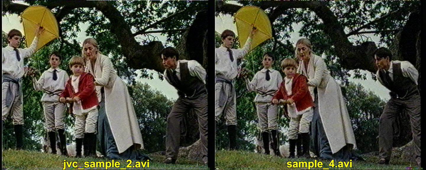

  11. I found something in VirtualDub2, I checked the 'Capture pin' and the compression quality was set to 1.000. After changing it to 0.000 the histogram no longer shows any gaps.
    1.000:
    [Attachment 84654 - Click to enlarge]
    0.000:
    [Attachment 84655 - Click to enlarge]

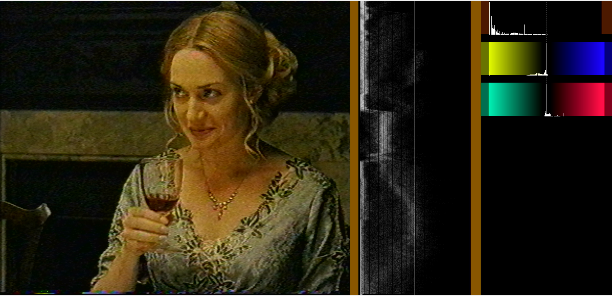

  12. You shouldn't arrange the waveform and the histogram stacked horizontally. The histogram will include the waveform picture in its statistics.
    (You clearly see in the histogram the spike representing the brown vertical bars of the waveform monitor.)
    For tape captures you need not worry much about gaps or spikes in the histogram. It would matter more for high quality sources where it may contribute to color banding in flat areas. When you do some denoising in post or add a tiny bit of grain the histogram will become smooth anyway.
    P.S. I am wondering where the hard clipping of the darks originates from. Brightness or contrast procamp tweaks seems not to mitigate it. It is still there even after cropping off any borders. Maybe it's baked into the source or comes from the VCR or from the capture device (?). Just speculating.....

    I like the histogram across the top, so you can see what part of the image is causing the blowouts or darkness; you can then decide to either ignore or make a correction.
    TurnRight().Histogram().TurnLeft()#Puts histogram across top

    Sample from a different tape:
    [Attachment 84667 - Click to enlarge]
  15. ^^^^
    This looks fine.
