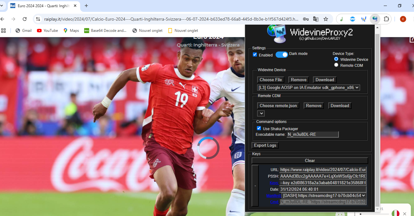

  4. You can download 720p using widevineproxy2 with the MPD and the key it gives you, for 1080p it is a bit more complicated
  5. thank you, in widevine the key 5c8f41a2da6132fcb23dee2d60e781bb
