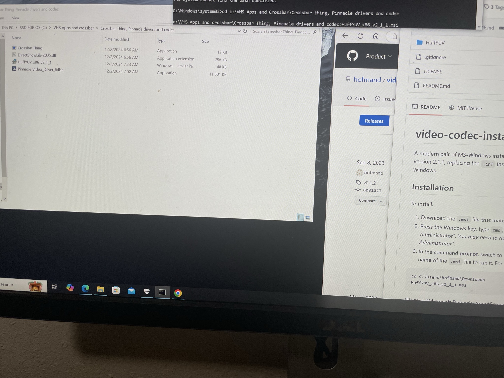

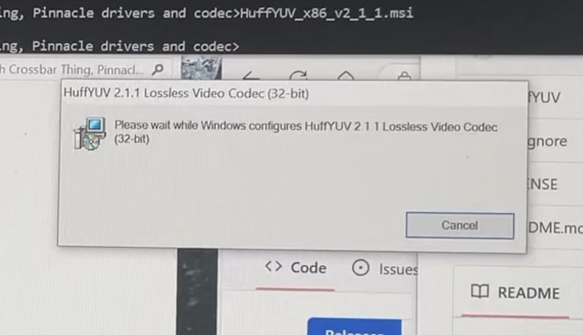

  5. I installed HuffYUV but there is no HuffYUV on the list under video - compression

    If you are using Virtualdub 1.9.11 and you installed the 32 bit version of Huffy it should work. You can install the 64 bit version also.

    Yes I am using 1.9.11 that LS recommend, and I downloaded 32 bit left click install on .inf file right ? And I don't see it under compression in VirtualDub.

  9. Thanks! It's working now. Didn't see text under on that like I just hit download on that green thing, my mistake.
