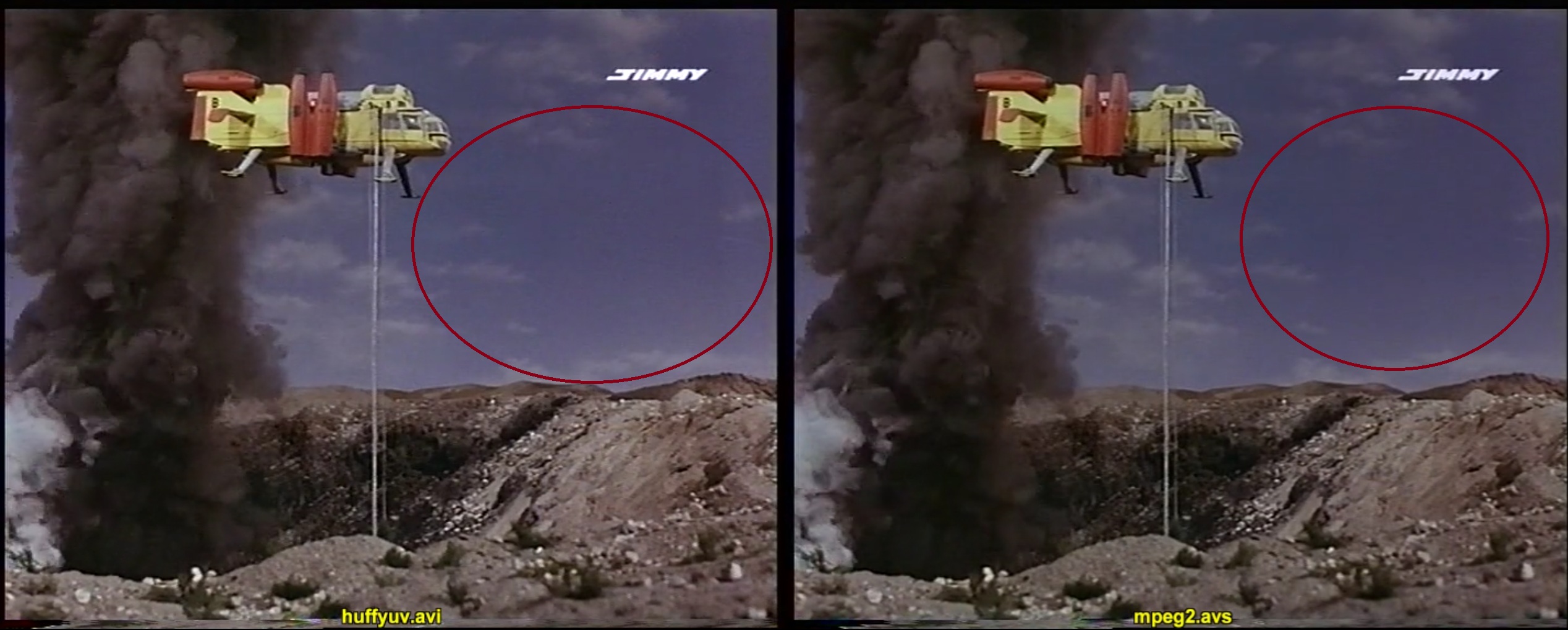

    How opposite, look at this
    [Attachment 86750 - Click to enlarge]

    I do not know what you are looking for, nor your conclusions.
    To me, HuffYUV is (marginally) sharper and better. Here some image slider frame:
    https://imgsli.com/Mzc0NDQ0
    https://imgsli.com/Mzc0NDQ2
    Now that you have the USB-Live 2 you can do the capture/comparison yourself, but here my original captures used here:
    mpeg2: mpeg2.ts
    huffYUV: huffyuv.avi
    The file I used for comparing:

  30. Hmm it really is better. I was thinking when looking at sky that there are more noise than on mpeg2.
    How to use that huffyuv. I just install it and load in compression settings in virtualdub ?
