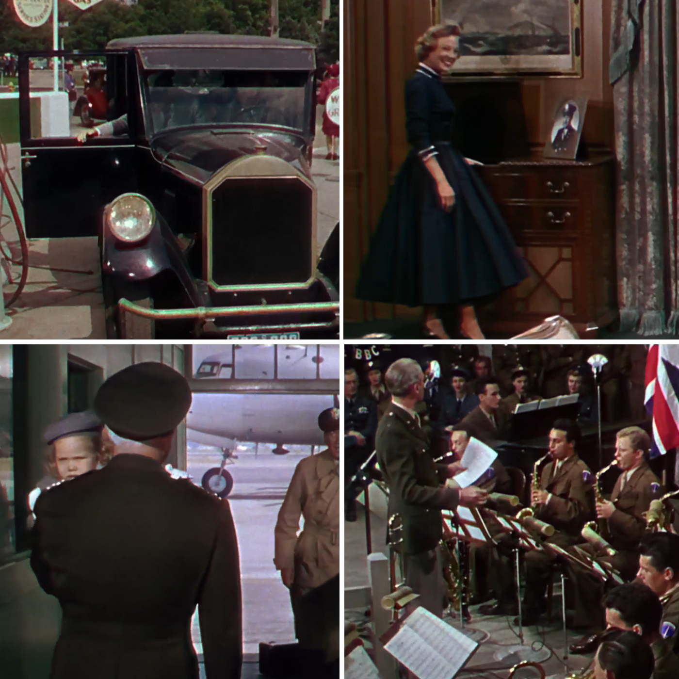

    [Attachment 84478 - Click to enlarge]
    ImageSource("GMS Color 1.jpg")
    ConvertToPlanarRGB()
    z_convertformat(pixel_type="YUV444P16", colorspace_op="rgb:709:709:f=>709:709:709:l")
    mergechroma(awarpsharp2(depth=70))
    mergechroma(awarpsharp2(depth=50))

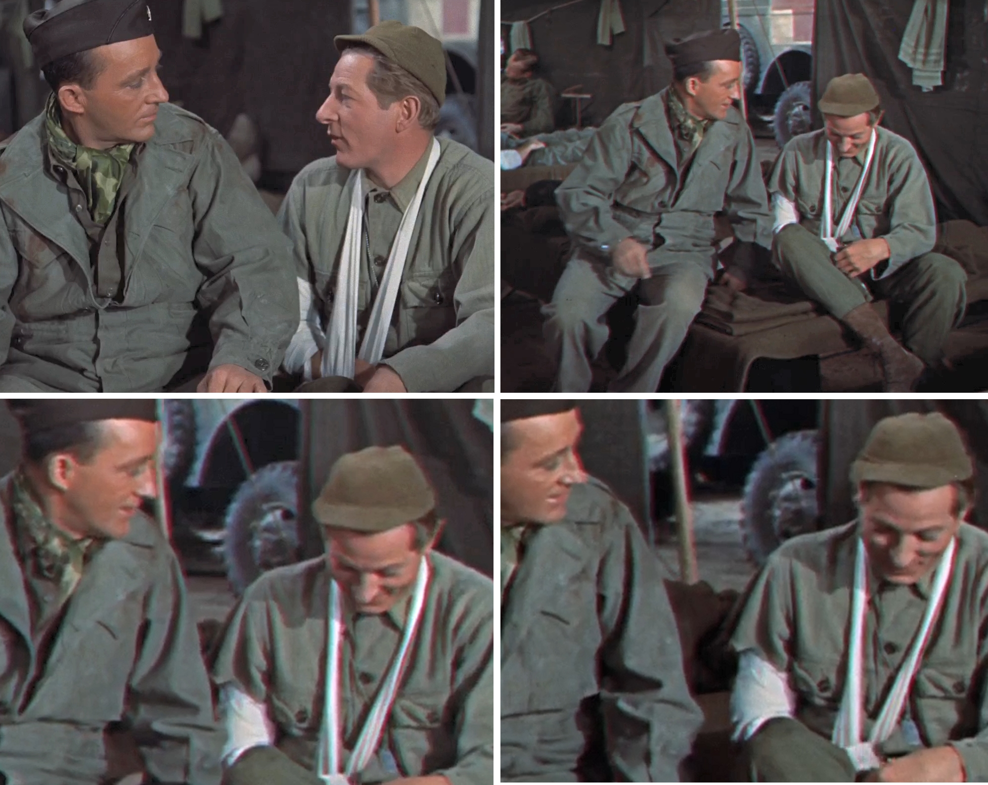

    All good points. This issue is that only parts of the "The Glenn Miller Story" are affected, most of the film is relatively OK, but not perfect. Another example is the BD re-release of "White Christmas", which was done very well. However, there is one scene at the beginning, when Bing enters the MASH tent to thank Danny for saving his life. Here too, there's noticeable color separation. However, this is the only scene this is occurs. The rest of the film is near perfect.
    The other points are also well taken. If the entire film was misaligned, there's a much better chance it could be fixed. With only some scenes affected, this AI would need to be very smart to differentiate what is a real misalignment, and what was intended (i.e. artistic effects). I guess if I was a studio that did this remastering, it would be worth the time.
    As seen below, the Top Left closeup shot is near perfect, but when the scene went to a long shot (Top Right), it got fuzzy, probably from this misalignment. The bottom two shots are blown-up of Danny's scarf, where the separation is very noticeable. Interestingly, all this only occurs in the long shot (10:46 to 11:05).
