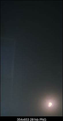

  1. My goal is to use Topaz Video AI to upscale my DVDs to FHD and maybe denoise some Blu-rays. I've been using it for years, and have built a script to streamline all the programs needed. I just need the final files to be able to play on my newish Roku player through Plex.
    The issue that I have is that TVAI processes everything in rgb48le. I output that to tiff, then I use FFMPEG to convert it to H.265. When I put it to the standard yuv420p pixel format, I get color banding that's pretty easy to see in some scenes. If I set it to yuv420p10le, the banding goes away—but only on my computer since my TV does not support 10 bit. It displays the color banding.
    Here's my command for the tiff to H.265 conversion:
    ffmpeg.exe -hide_banner -stats_period 2.0 -nostdin -framerate 23.976 -y -i "input\%6d.tif" -c:v libx265 -crf 18 -pix_fmt yuv420p -preset slow -profile:v main -vf "zscale=pin=bt709:min=gbr:tin=bt709:rin=pc:d=3:f=5:p=709:t=709:m=709:r=tv:c=input,format=yuv420p" "output.mkv"
    Here's the 8 bit:
    Here's the 10 bit:
    Everything I can find says to dither, but I'm already doing that with zscale. It doesn't seem to have any effect.
    I did have some success with adding the deband filter, I feel like it shouldn't be needed though.

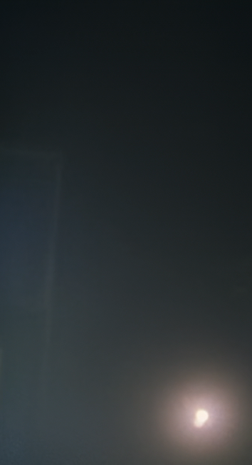

  2. I might have found a few more details. rgb48le should be easily converted to a 12 bits per channel pixel format. So really, I just need to know how to get FFMPEG to dither from 12 to 8 bits per channel. Maybe I need to chain the filters like 12 -> 10 -> 8. I don't know. Everything online says dithering should happen automatically just by the 'format=yuv420p' filter.
  3. I think chaining the format filter helped a little. It looks better to me than the what I was getting before, but not quite as good as the 10 bit version.

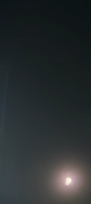

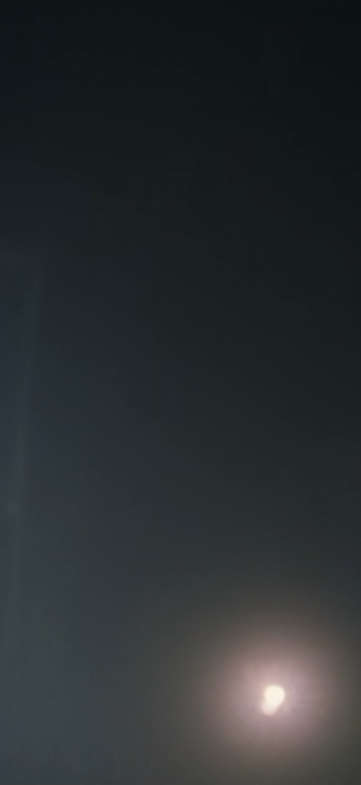

    So what I came up with, chaining the format filter
    -vf "zscale=pin=bt709:min=gbr:tin=1:rin=pc:d=3:f=5:p=709:t=709:m=709:r=tv:c=input,format=yuv420p12le,format=yuv420p10le,format=yuv420p"
    [Attachment 84584 - Click to enlarge]
    Somehow, I don't have the grain filter, but the noise one was fine. I decided to keep the chained formats in. I put the noise before the last one.
    -vf "zscale=pin=bt709:min=gbr:tin=1:rin=pc:d=3:f=5:p=709:t=709:m=709:r=tv:c=input,format=yuv420p12le,format=yuv420p10le,noise=alls=1:allf=t,format=yuv420p"
    [Attachment 84585 - Click to enlarge]
    Those pictures don't really show any difference. The noise version looks sharper and I can't see any added noise. So it's doing what it needs to. I can still see the banding. It's reduced though.
    I'm going to see what chaining the noise does…

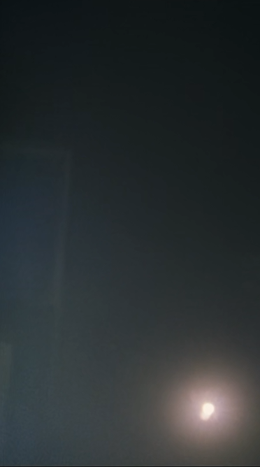

  12. libplacebo took me full circle. It has all of the options needed to be a replacement for zscale and format. In the end I was able to get the same results as zscale and chaining format—not better. It might have had a slight color change.
    After all that, I want to lay this thing to rest. I checked again how the final video looks on my TV setup. The banding is much less noticeable on that, then on the computer.
    I'm settling with the chain format command. Zscale with d=1 makes a slight difference.
    -vf "zscale=pin=bt709:min=gbr:tin=1:rin=pc:d=1:f=5:p=709:t=709:m=709:r=tv:c=input,format=yuv420p12le,format=yuv420p10le,format=yuv420p"
