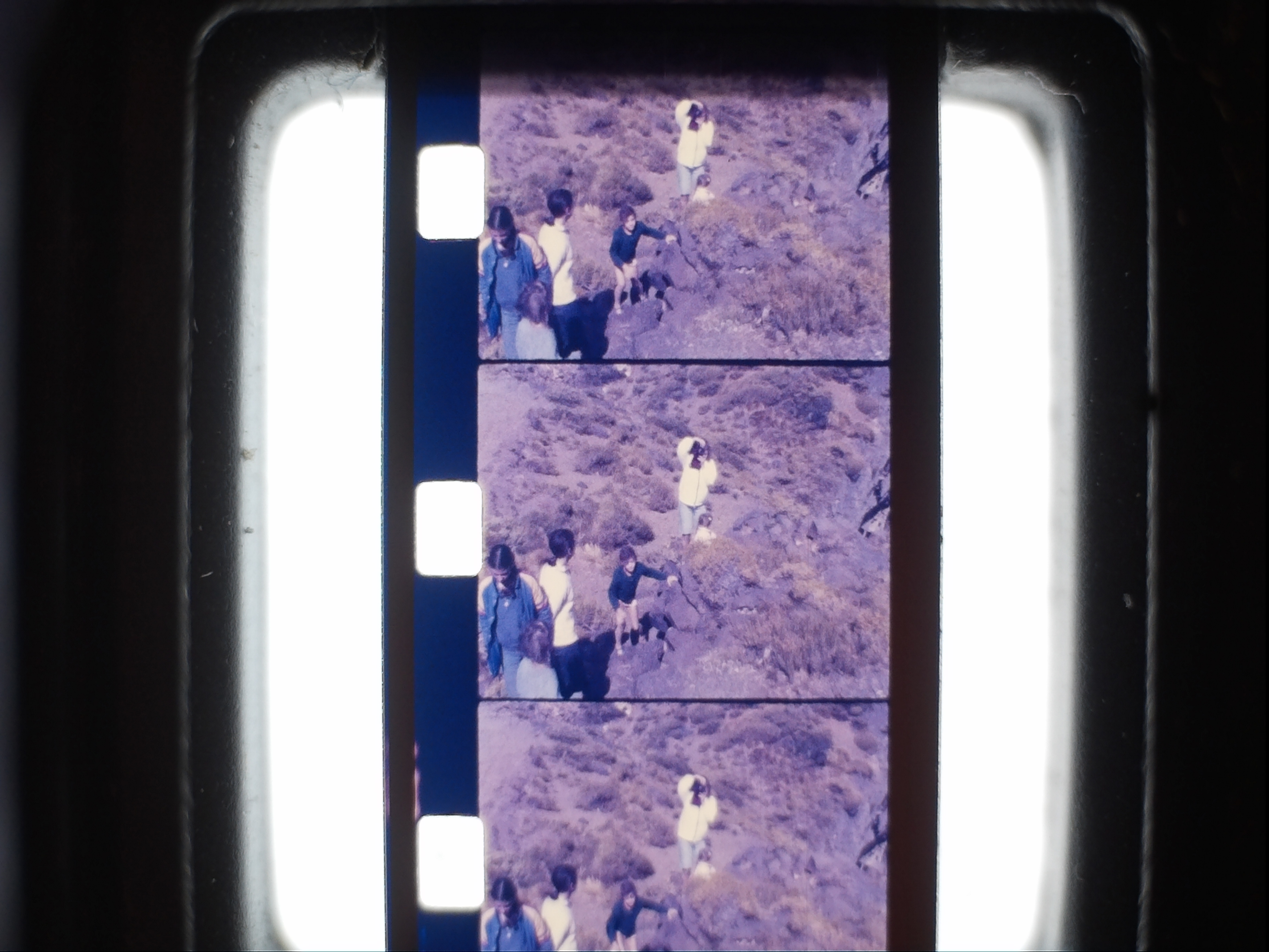

  1. Wolverine MovieMaker-PRO — firmware that saves every frame as a full-resolution still (1:1, no upscale)
    As I´ve told you before, I'm not a programmer — just a patient, stubborn person who wanted better scans, working with Claude (Fable). After a lot of trial and error on the NT96650, here is a firmware for the Wolverine MovieMaker-PRO (MM100PRO) that changes what the machine does:
    - Saves every film frame as an individual JPEG, instead of the stock 1440x1080 H.264 MP4.
    - Native 1:1, no interpolation: 2304x1536, JPEG 4:2:2. It captures the full film gate (picture + the sprocket-hole column), about 0.9 MB per frame. (Sample still attached.)
    - Extra firmware fixes vs. the OEM build: correct still colour, OSD text sized for the PL11 panel, Fast-Forward/Rewind stop, USB mass-storage, a take-up motor pulse, and a format-aware centred preview.
    Capturing the whole gate, including the sprocket holes, is deliberate: it lets you stabilize and align every frame using the sprockets as a fixed reference. So I also put together a small tool (attached) to do exactly that and turn the captures into a movie (Telecine Studio):
    - Sprocket-hole registration -> it locks onto the exact frame, so there is no gate weave or "flashing" between frames.
    - Auto-calibrates for Super 8 and Regular 8 (nothing hard-coded), and picks the correct frame in the tricky half-pitch cases.
    - Optional colour restore (removes the magenta cast of faded film) and optional extra stabilization — only if you want them.
    - It is local and offline, and runs in your browser.
    Its a small Web GUI that runs locally made with Claude that uses ffmpeg among other things to capture the frame from the JPGs and make a video.
    The catch — it is much slower. Scanning runs at roughly 3.8 seconds per frame, about 4-5x slower than stock. So this is not for everyone. But it is unattended — you press start and walk away — so in my opinion the extra time is well worth the quality. Your call.
    I am also attaching all the documentation: a full reverse-engineering knowledge base of the NT96650 (memory addresses, the capture pipeline, the emulator setup we used, the dead-ends). If anyone wants to keep improving this, it should save you a lot of time (and a lot of tokens).
    I think a posible future project from all this is could be to stop Video Mode upscaling. Video mode captures at 944×652 and it upscales it to 1440×1080. The latest firmware edits from this forum already improves quality a lot by reducing video compresion. By reducing the upscaling you could get a more real output without interpolation. I think this could be a good balance between speed and video quality. The JPG method from the firmware I´m attaching has the drawback of speed and postprocessing on a PC. But on the other hand, you could stabilize the film which, at least in my scanner, wobbles a little bit during scan using the sprocket as a reference, and has almost no pixel nor colour compression at all. I think this firmware its at the practical top when referring to the quality you can get out of this scanners.
    A heads-up: this runs in photo mode, so on the unit you will see a different on-screen menu than the stock movie mode — that is expected.
    Flash at your own risk — it is built from the MM100PRO 20210508B-ZS15 base, so keep a rescue card with your original firmware. Details are in the firmware readme. That said, it has been running happily on my father's scanner after several nights of trying, and honestly that made all the effort worth it.
    Happy to answer any questions.
    [Attachment 93786 - Click to enlarge]

  28. In addition to my last post. I analyzed a defective jpg file:
    The analysis of the original file shows that this is not simply a damaged JPEG header. The file contains a valid JPEG structure, but the image data itself is corrupted or incorrectly generated.
    1. Unexpected data before the JPEG
    The file starts with approximately 65,536 bytes of non-JPEG data.
    Instead of the normal JPEG signature:
    FF D8 FF
    the file begins with structured ASCII/binary data containing entries such as:
    RGB
    Flash Info
    Redeye
    Noflash CA
    Preflash CA
    and numerous RGB values.
    The JPEG starts only at:
    offset 0x10000 (65,536)
    FF D8 FF E1
    The exact 64 KiB boundary strongly suggests that this is a buffer or diagnostic data block, rather than random filesystem corruption.
    2. The data is clearly related to the camera's image-processing pipeline
    The data found both before and after the JPEG contains parameters such as:
    ExpectY
    LumY
    PrvEV_Value
    CapEV_Value
    Prv_ISOGain
    Prv_ExpoTime
    RGain
    GGain
    BGain
    Weight Table
    These are characteristic of internal image-processing operations such as exposure, gain, brightness and color processing.
    Therefore, the data appears to originate from the camera/firmware image-processing system, not from a normal JPEG file.
    3. A valid JPEG is embedded in the file
    A complete JPEG starts at offset 65,536 and ends at approximately 873,720.
    Its header identifies it as a:
    2304 × 1536
    JPEG image with Exif information.
    The JPEG itself is syntactically valid and can be decoded. However, the resulting image is visibly incorrect: only parts of the expected film image are present, with corrupted/misassembled image content.
    This is important because it means that repairing or replacing the JPEG header cannot restore the correct image.
    4. There is another JPEG/data structure afterwards
    Immediately after the first JPEG, additional data follows, including another JPEG structure and further camera/ISP parameters.
    A separate intact 640×480 JPEG can be extracted from this region, and that JPEG is technically valid. It appears to be a secondary/preview image rather than the original full-resolution image.
    5. Comparison with the neighbouring valid file
    The correctly recorded 520.JPG has a conventional JPEG structure beginning directly with:
    FF D8 FF E0
    JFIF
    and does not contain the large diagnostic data block found in 519.JPG.
    This makes ordinary filesystem damage or a simple missing JPEG header unlikely.
    Conclusion
    The most plausible interpretation of 519.JPG is:
    The camera/firmware did not correctly create the image file during capture. Internal image-processing/debug data was written into the file, including a 64 KiB block before the JPEG. Although a complete JPEG container is present, its actual image data is already incorrect/corrupted.
    In other words, the problem is not primarily a damaged file header. The JPEG header and much of the JPEG structure are intact; the corruption occurred at the image-generation/file-writing stage.
    The available evidence does not allow us to determine the exact firmware bug or the precise reason why frame 519 was affected. Possible causes include an incorrect/overwritten image buffer or a synchronization problem between image capture, ISP processing and JPEG encoding, but those would remain hypotheses without further affected/working files or firmware analysis.
    Most importantly: the original 2304×1536 image cannot currently be reconstructed simply by removing the 65 KiB prefix. The necessary correct pixel data does not appear to exist in the file in a usable form.
