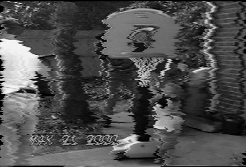

Here's an example of the issue, using a tape I was previously able to capture perfectly fine:
[Attachment 84362 - Click to enlarge]

Looks to me like a ground connection has come adrift. The wavy distortion seems to be at a lower frequency than the video and not related to the video content. Is it possible the video is being grounded through the audio connection? We need to see a short video clip to see if there is any correlation between audio and sync distortion. I certainly suspect a hardware problem, nothing to do with software at all.
Brian. -

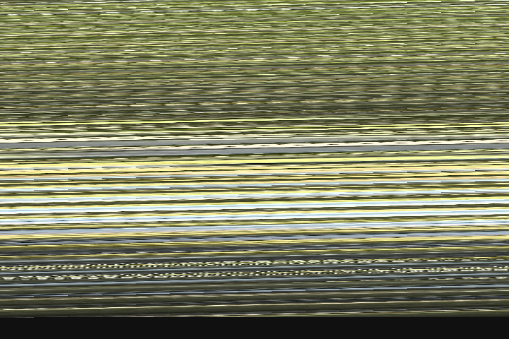

I've attached a small clip of what the video captured by my Pinnacle 510 is looking like now, as requested.
Also, here's a picture of what the preview in VirtualDub looks like using the other capture card just for reference.

That screen should be fixed by switching from overlay to preview or vise versa in vdub.
Switching to Preview makes it disappear unfortunately, not even a black screen just VirtualDub's grey background.

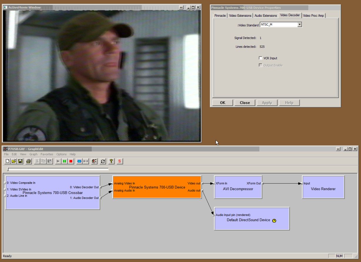

change the sync gate width, open the gate for VCR Input
