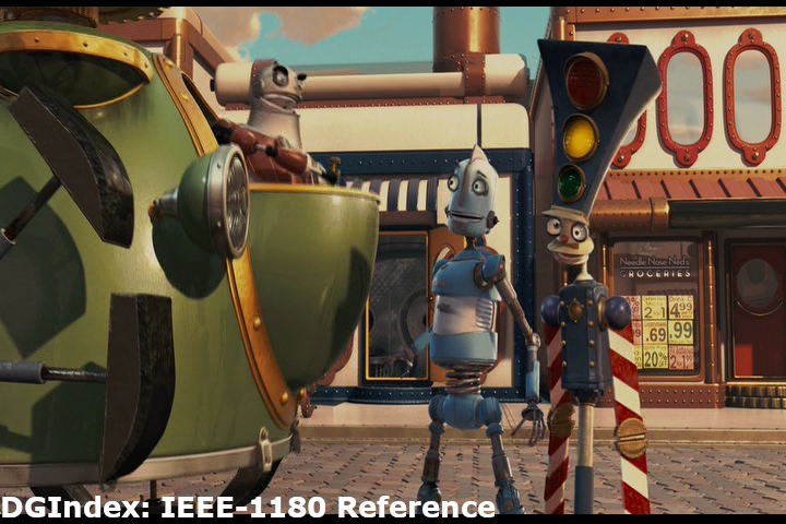

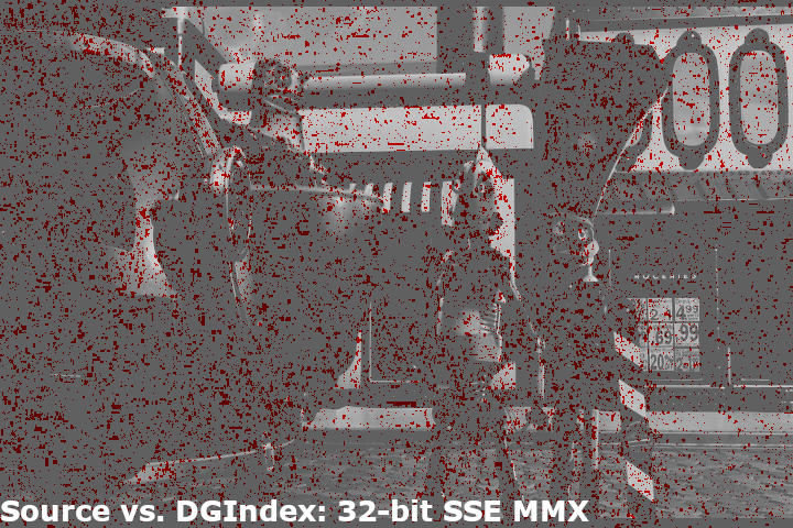

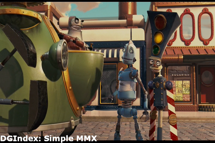

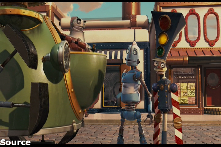

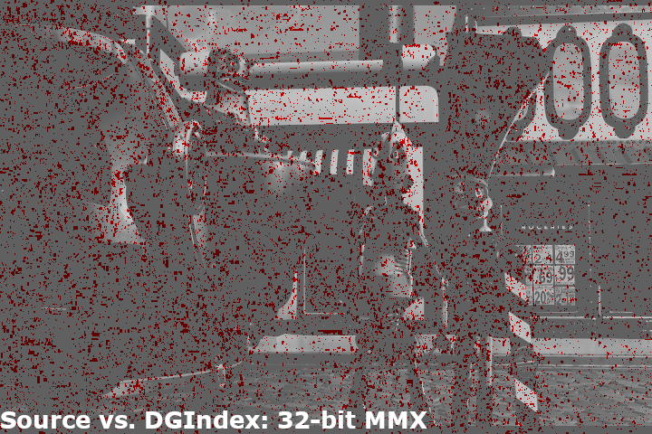

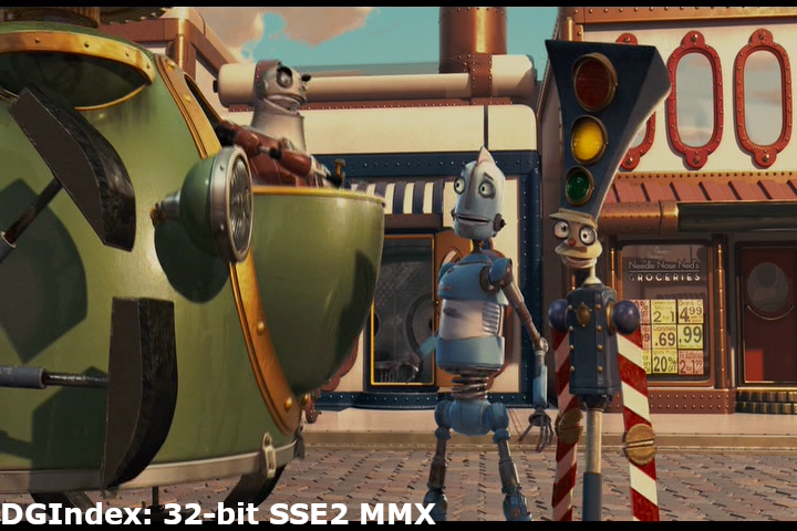

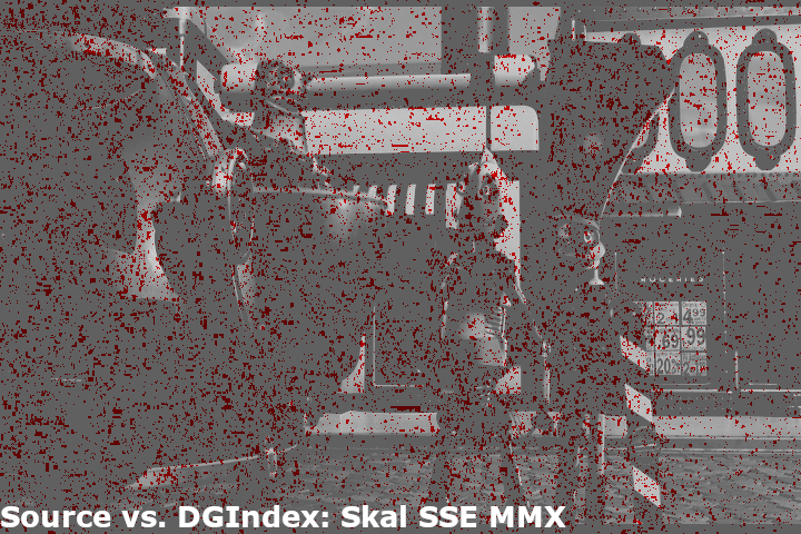

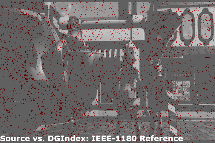

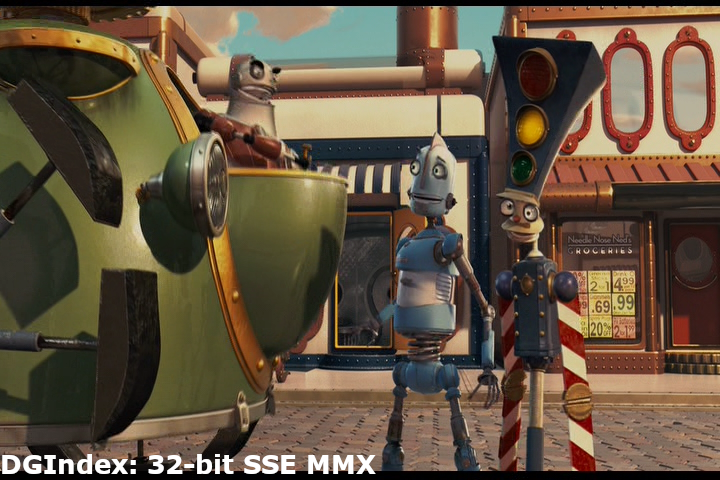

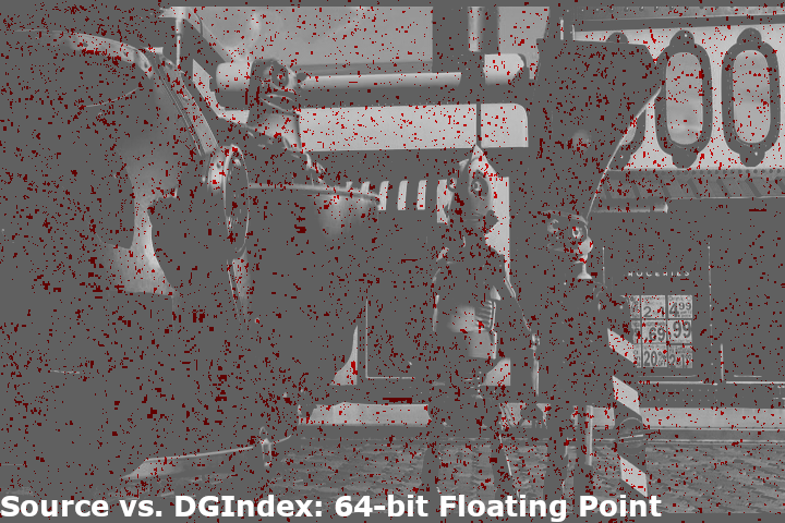

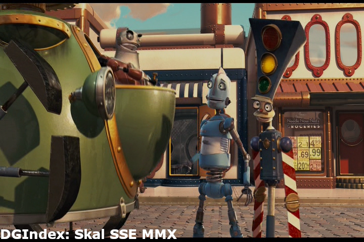

    Sure do! Now with the naked eye you won't notice every blemish or artifact when viewing the end results, on occasions however, because I know the quality of the source so well, I end up spotting some things out of place here and there that I know shouldn't be there or happening when testing the video results out. To set the record straight, I DO NOT encode into MPEG-2 at all, as stated in the main post I try to encode losslessly if I can help it. In this particular case, I encode into H.264 with lossless settings using FFmpeg. Based on Cornucopia's response, decoding is handled losslessly (assuming I understood correctly), which implies that my issue really comes down to DGIndex now. I put together a collection of frame images, all of which are of the same frame from the film, but each of which differ in the sense of what iDCT algorithm is utilized in DGIndex. The frame chosen isn't inherently one that will be noticeable with the naked eye, but it was chosen because it's a progressive frame, as such, technically when using DGIndex to remove pulldown and such, the original progressive frames aren't supposed to be touched at all. These differences occur on every frame no matter the MPEG-2 source utilized.
    Source
    [Attachment 84342 - Click to enlarge]
    DGIndex: 32-bit MMX
    [Attachment 84343 - Click to enlarge]
    DGIndex: 32-bit SSE MMX
    [Attachment 84344 - Click to enlarge]
    DGIndex: 32-bit SSE2 MMX
    [Attachment 84345 - Click to enlarge]
    DGIndex: 64-bit Floating Point
    [Attachment 84346 - Click to enlarge]
    DGIndex: IEEE-1180 Reference
    [Attachment 84347 - Click to enlarge]
    DGIndex: Simple MMX
    [Attachment 84348 - Click to enlarge]
    DGIndex: Skal SSE MMX
    [Attachment 84349 - Click to enlarge]
    Source vs. DGIndex: 32-bit MMX (Gray means no differences, red means differences)
    [Attachment 84350 - Click to enlarge]
    Source vs. DGIndex: 32-bit SSE MMX (Gray means no differences, red means differences)
    [Attachment 84351 - Click to enlarge]
    Source vs. DGIndex: 32-bit SSE2 MMX (Gray means no differences, red means differences)
    [Attachment 84352 - Click to enlarge]
    Source vs. DGIndex: 64-bit Floating Point (Gray means no differences, red means differences)
    [Attachment 84353 - Click to enlarge]
    Source vs. DGIndex: IEEE-1180 Reference (Gray means no differences, red means differences)
    [Attachment 84354 - Click to enlarge]
    Source vs. DGIndex: Simple MMX (Gray means no differences, red means differences)
    [Attachment 84355 - Click to enlarge]
    Source vs. DGIndex: Skal SSE MMX (Gray means no differences, red means differences)
    [Attachment 84356 - Click to enlarge]
  10. Originally Posted by DeadSkullzJr View Post
    Some issues with that comparison is "source" - how did you get the "source" to compare? and how are you comparing exactly to generate "red" differences
    eg. if that was obtained with ffmpeg, then you're using ffmpeg mpeg2 decoder and whatever idct algorithm it's using. That could be an additional source of "error" in the source
    Problem #2a - are you converting RGB then comparing in RGB ? Because that is technically lossy
    Problem #2b - You could be measuring differences in upscampling and RGB conversion algorithms.
    Yes, but these are types of expected idct differences that selur explained above
    But the rough idea is what I was referring to earlier . The mpeg2 decoder algorithm differences are very minor .They are essentially rounding differences. Eg. instead of a pixel being YUV (138,97,100) , it might be rounded to YUV(138,91,101). The actual Cr value in this hypothetical 101 migh t have been 100.35, but it gets rounded differently due to precision - and that value is actually lossy eitherway. It might have actually been 99 in the original, original, pre mpeg2 source.
    In theory, the IEEE-1180 Reference decoding for mpeg2 is supposed to be the highest quality. One way you could test that is use a source (A), encode that to mpeg2 (B). Run through the different idct decoding and measure against the source (A) using whatever measurement (metrics such as PSNR, SSIM, VMAF , subjective assessment, etc.)
    Can you post an example where "spotting some things out of place here and there that I know shouldn't be there or happening" - because that's not due to MPEG2 decoder idct differences, it's going to be from something else
    ie. can you point out a frame with a material difference that affects visible quality. Something you can see that's noticably out of place or definitely worse. Because right now you could argue some of the pixels in the "source" are "worse" - both subjectively and objectively - because it's not the real YUV source, but a lossy RGB converted representation of the source
    e.g. If I did an unlabelled blind test, could you pick out which of those screenshots are "worse", and explain "why"

    In terms of "quality", I was curious myself so I tested a few sources , different mpeg2 encoders to test different mpeg2 decoders - and modern ffmpeg/libavcodec (also ffvideosource) scores slightly higher in psnr consistently than DgDecode.dll IEEE-1180 Reference (or other idct). "psnr" as a measurement has a bunch of issues, but it's one type of "measuring stick". It might be that the old dgdecode.dll is still based on an older libavcodec implementation, and could be improved. Curiously nvdec /purevideo (used in DGDecNV, consistently scores the lowest). Mind you we are talking like < 0.1 db PSNR differences between decoder implementations - it's like splitting hairs . I'll eventually test some other decoders , commercial ones like Mainconcept, Sony, but 0.1 db is the max diff. Usually it's like 0.01 or 0.02 db.
    VirtualDub2 and FFmpeg seem to use the same decoder(s) when I exported frames from a few MPEG-2 sources, they matched identically, implying the same decoding algorithm is being utilized, unless multiple exist and are capable of equivalent decoding accuracy.
    Yes, they will be using a current version of libavcodec . They should be perfectly fine for 100% soft pulldown sources that do not have other issues
    Is there a chance for a lossless decoder to exist, is it even possible for one to exist?
    Not really from MPEG2, because there is no defined lossless output for a given lossy input for MPEG2. The outputs vary (very slightly) between decoders. You can measure "quality" if you have the master, but all quality measures have various issues - it's difficult to measure "quality"
    AVC specs dictate you have to have bit identical output - so even lossy streams can have lossless decoded output for that lossy stream. Not true for MPEg2
    even if I encode into a lossless format, the damage could potentially already be done just by decoding.
    For MPEG2 yes. But the "damage" is very minor. The delta between MPEG2 encoders is small according to PSNR. Can you tell the difference in an unlabelled blind test which of those screenshots is the "best" or the "worst" ?
    Still, I was surprised that IEEE-1180 wasn't the "best". Even if it was just a few tests, and PSNR is not a great "quality metric", the trends are pretty consistent
