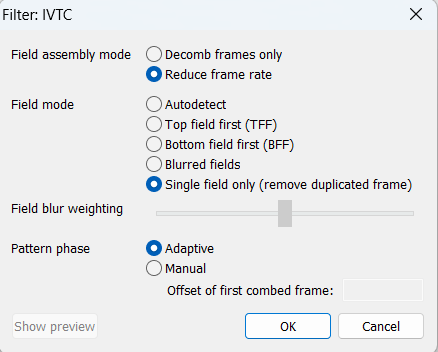

I installed VD for the purpose to rid off of duplicate frames (mostly work with DVD PAL content). Well my first problem that is very stupid but very important is that Virtual Dub has no reaction when I try to open video file (MP4 HEVC). I open the file from the "File" option top left but the program does not respond. I red other threads about dropped/inserted/duplicated frames and from what I understood is best to remove duplicated frames when the video is interlaced scan. But what are the exact settings? I think the right settings are those:
[Attachment 84329 - Click to enlarge]

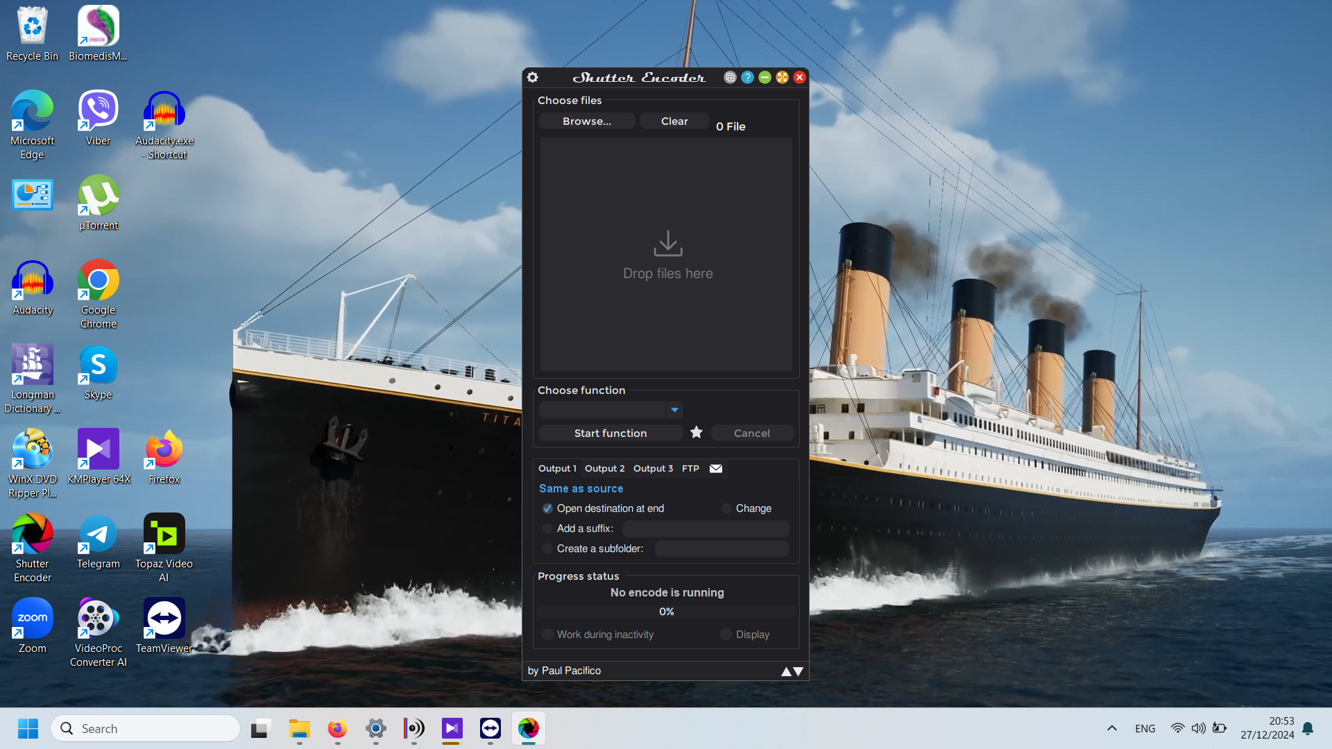

I am here. Before interpolating frames first I tried to remove duplicates with Shutter Encoder. Here's the opening screen

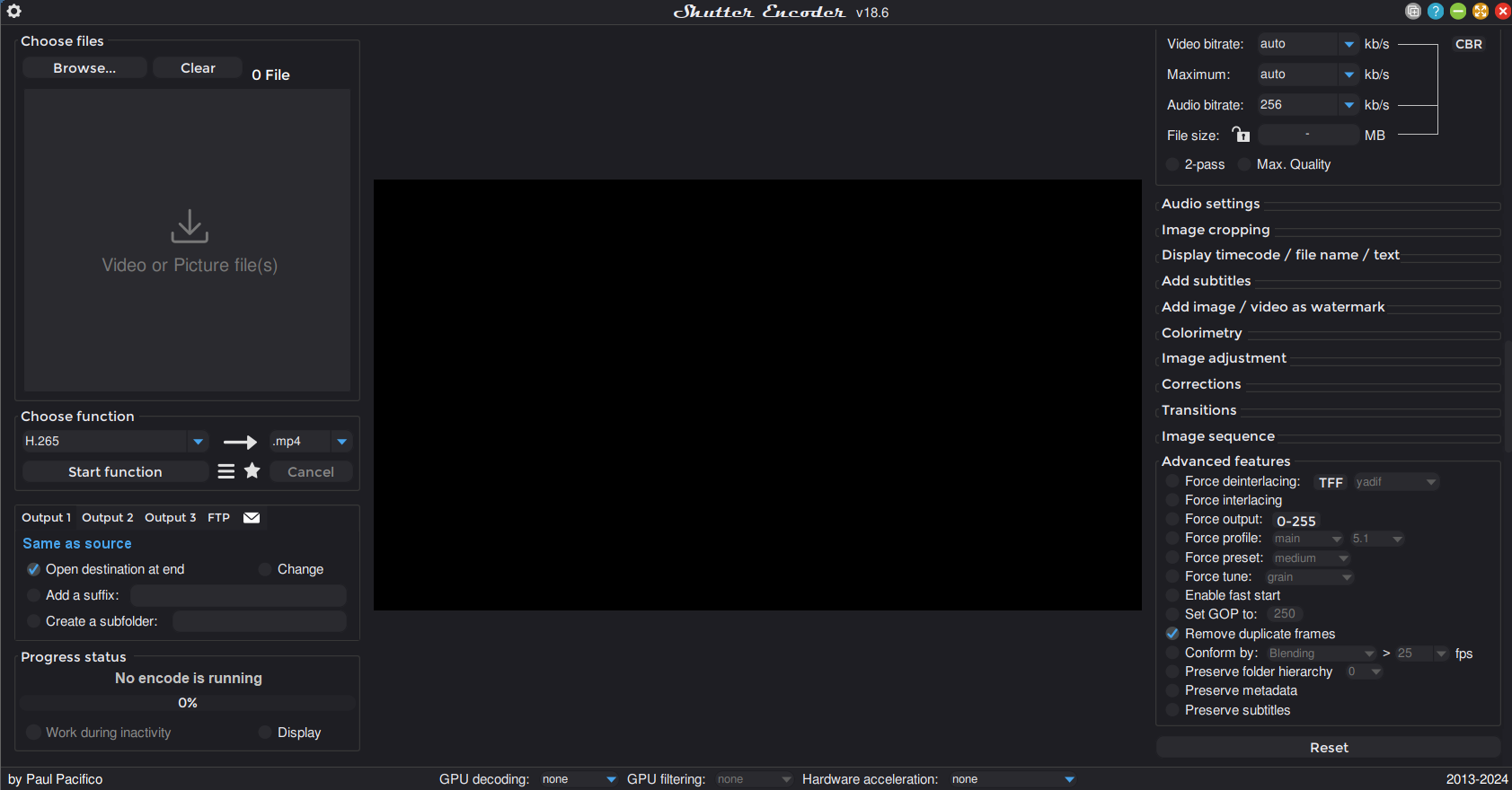

From the "Choose Function" list I select "Output Codecs", then "H.265". From the upper left part of the window I browse for the file.
[Attachment 84380 - Click to enlarge]

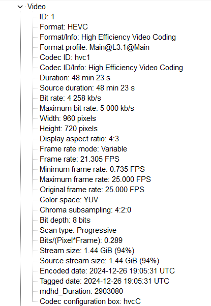

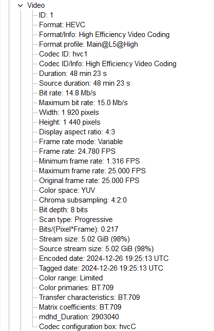

On the right side I click "Advanced Features" then "Remove Duplicate Frames". I tried this approach with three different versions of one source material. First with raw quality (720x576p interlaced in MPEG 2), second filtered, deinterlaced and upscaled to 720p with Topaz Video in MKV FFV1 8-bit 4:4:4, and third filtered and upscaled to 1440p in MP4 HEVC. The processing speed on the raw material was fastest (500fps approximately), on the second one slightly less (300-400fps), on the third significantly slower (120fps). On the all processed files I don't see differences. At the metadata the results are also pretty similar but something that I do not expected is that the framerate is not 24fps what I expected but varries. Here are screenshots of the Media Info analyze in the same order, exept the first one. I will explain later why I missed it.

From my experience is better to remove duplicates after deinterlacing because when I remove them first, the video automatically will be transcoded into progressive scan without really be progressive (fake progressive). And again I do not see any differences for supporting this process before deinterlacing. No visually, no in process speed, no in metadata. The only reason why processing is slower after deinterlacing in Topaz is the higher resolution. I do a lot of experiments with different sets of settings but have no time to do all permutations so about the rest I extrapolate.
