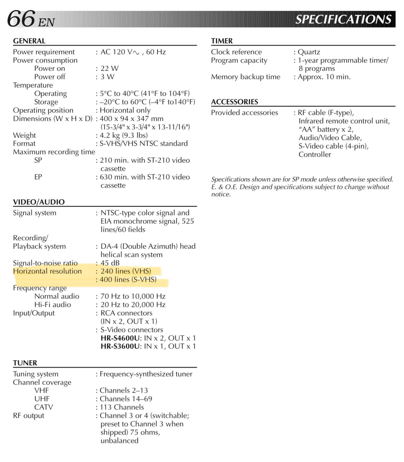

    Yeah, but "lines" horizontally makes no sense, from an analog video perspective.
    I couldn’t agree more and it always confused the heck out of me yet…
    [Attachment 84318 - Click to enlarge]
    It was always the standard of the industry meaning number of vertical lines that can be resolved horizontally across the screen. Talk about obtuse!
    BW
    BW
    In that specs sheet perhaps the most important technical spec is omitted: the horizontal color resolution of only 40 lines. I guess they didnt want to make it too plain that (compared to the broadcast TV standard of that day) in SVHS the color was still just as weakly defined as it was in VHS, and other consumer VCR formats. So they only mentioned the improvement in luma resolution.

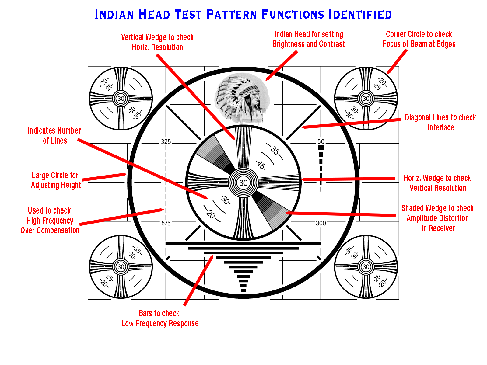

  12. I think term "lines" refereeing to resolution "wedges" visible on many older patterns like famous 'Indian head'
