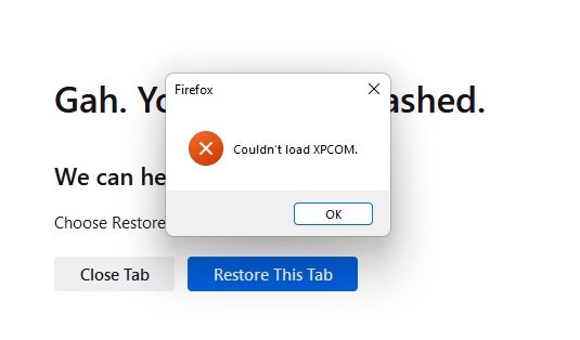

  1. Lately I've noticed my Lenovo Ideapad laptop running Windows 11 keeps crashing particularly when using youtube when I bring up a new tab. I will often crash at when doing other tasks like using Handbrake to encode a video. I had this problem a few years ago when I was using an APK for Whatsapp, but after I uninstalled it the problem seemed to go away. Since then I've used the proper Whatsapp app, but lately Windows seems to be crashing alot more especially when using certain sites like youtube, though I'm not sure if it's down to Firefox. Often also there is barely any HDD space left. Also fails to update Windows security. The screen (more so on youtube) when viewing the main page, will flash in and out.
    Anyone know what could be causing this?. Seems like a hardware fault or maybe a virus?. The lack or RAM and HDD space is odd.
    [Attachment 84243 - Click to enlarge]

  2. Looks like two error messages. The firefox one indicates a missing file. Don't know if that is related to the underlying message but maybe you could try to reinstall firefox to at least fix one of the messages. Here's some help in resolving the firefox error....
    https://support.mozilla.org/en-US/questions/1229392

  3. Originally Posted by TreeTops View Post
    The smaller error message appeared straight after the other one. I will reinstall Firefox but I think it crashes using Chrome as well. Youtube seems to be crashing the most on but not just with youtube.
