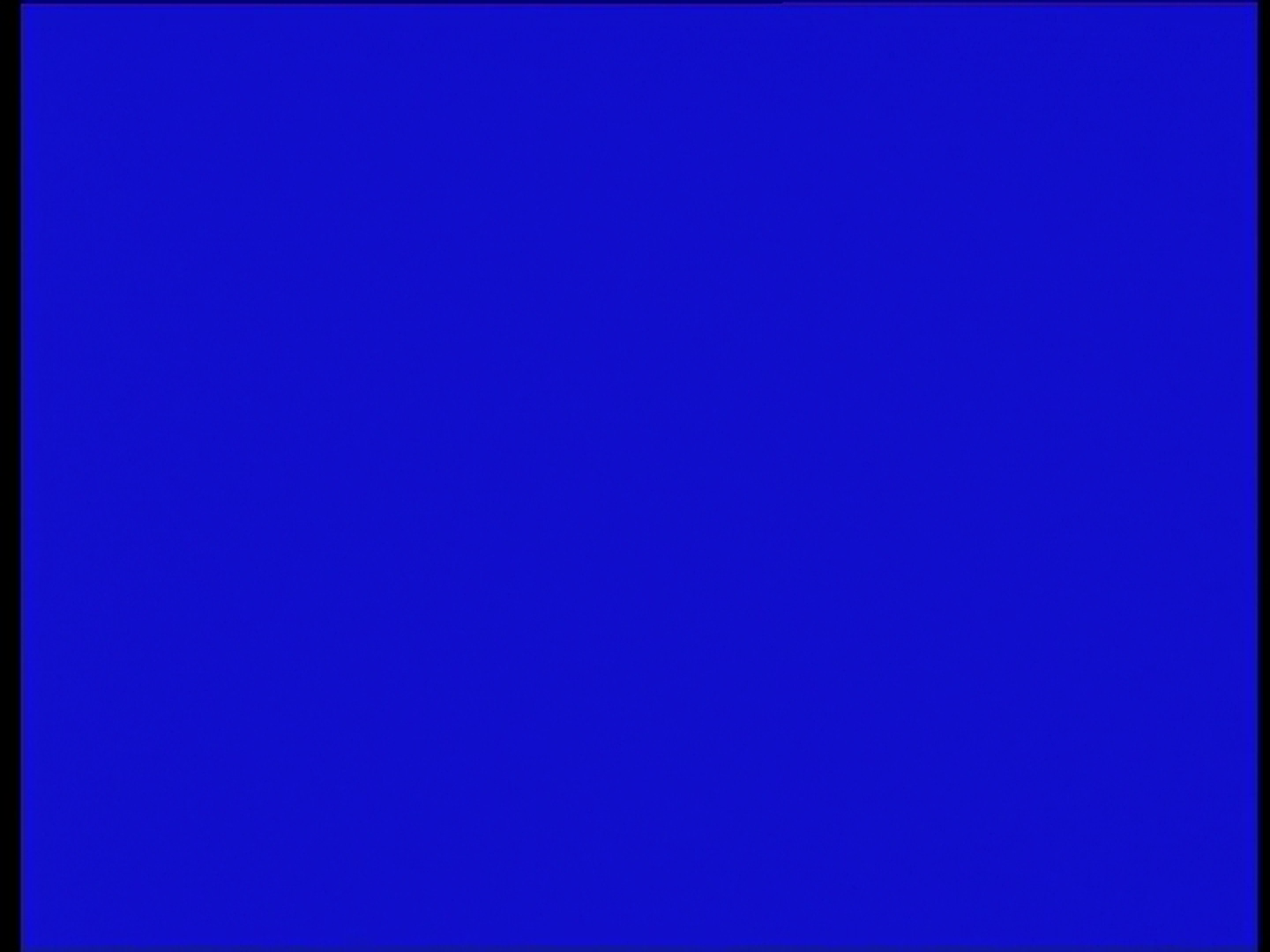

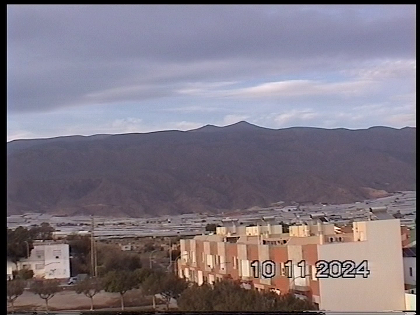

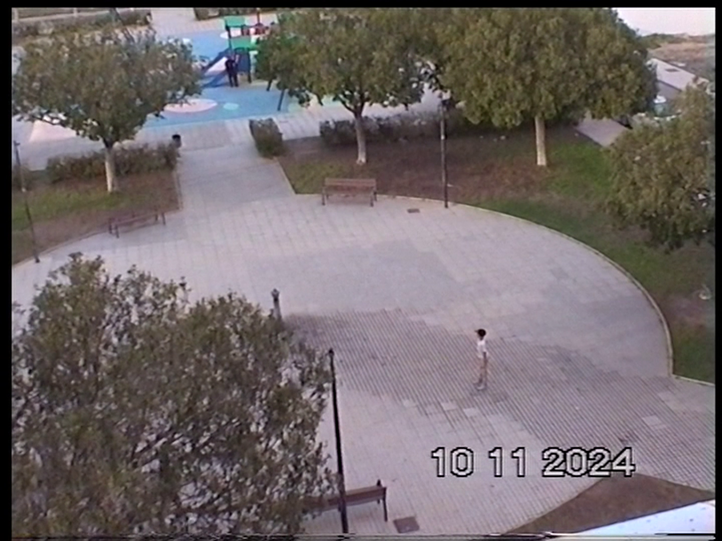

Here is the video captured directly to my Digital 8 TRV730E camera without the DMR ES10, TBC from the Hi8 camera was disabled (OFF):
[Attachment 84225 - Click to enlarge]
[Attachment 84226 - Click to enlarge]
[Attachment 84227 - Click to enlarge]

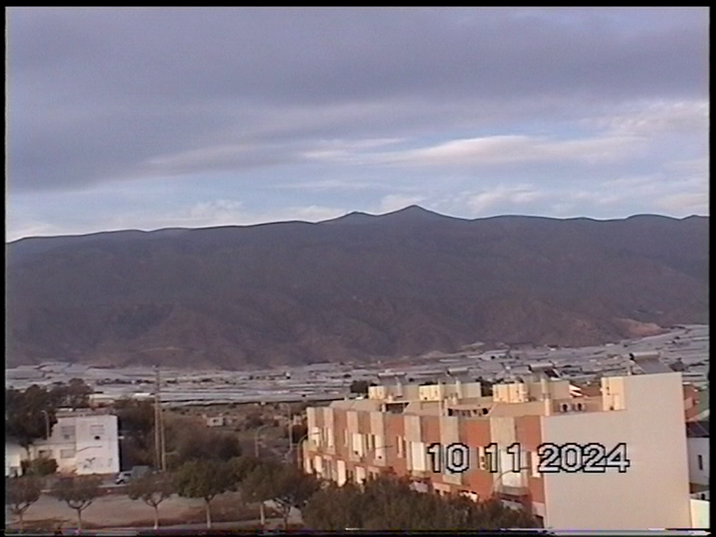

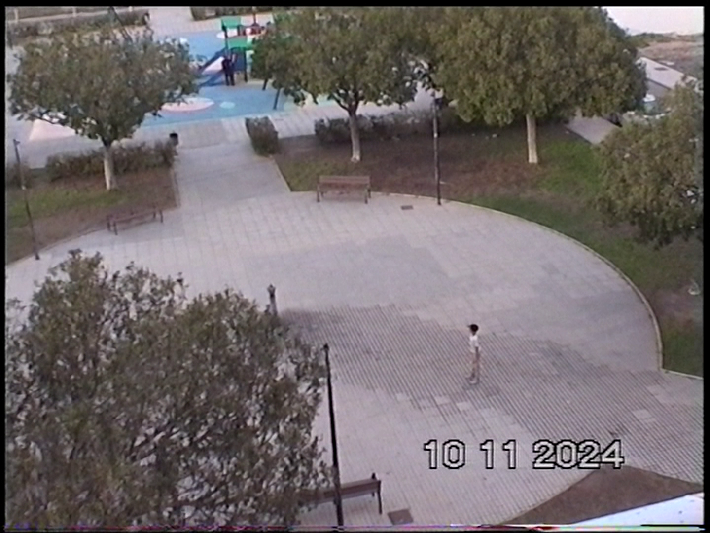

Now this captured with the DMR ES10 and s-video used in both sides, i used the s-video output to my digital 8 camera so i didn't use SCART:
[Attachment 84228 - Click to enlarge]
[Attachment 84229 - Click to enlarge]
[Attachment 84230 - Click to enlarge]
