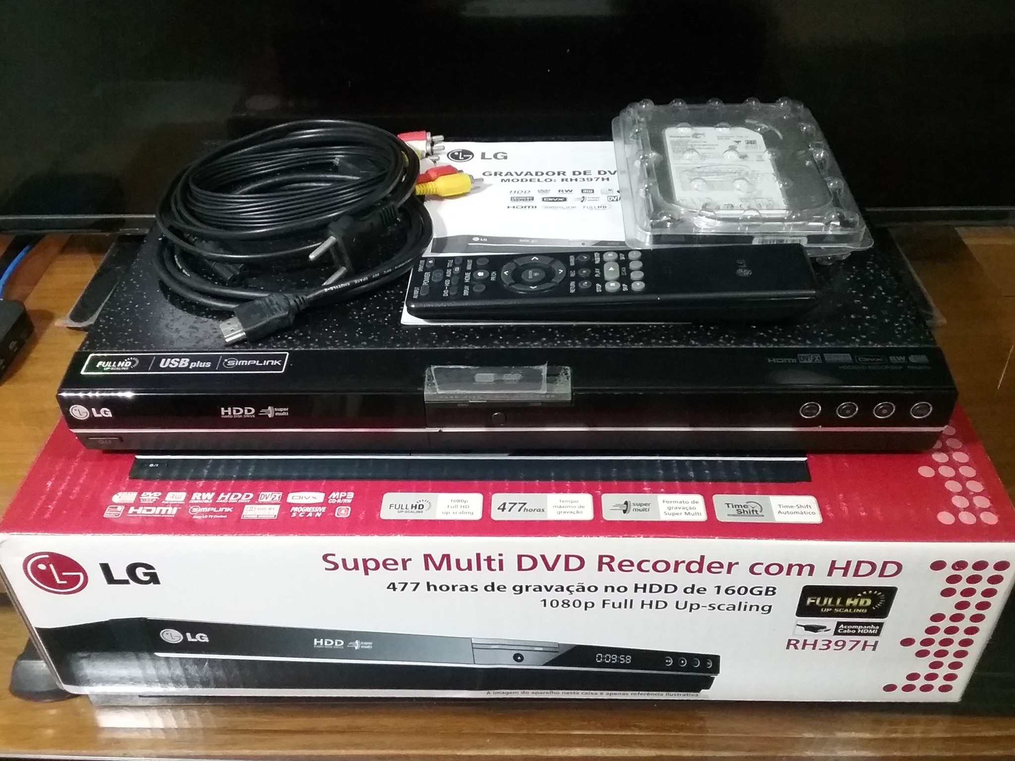

I recently bought this device ''LG RH397H DVD HDD RECORDER'', I would test some VHS captures with it, precisely because it has an internal HD. Well, with the previous owner this had been stopped for about 15 years, testing it, it is not working, the screen does not leave the message ''Hello''. The HD seems to be not working making a latch noise.
Questions. If anyone has or has used this device... 1. Is it possible to replace the HD with any other? Or would it only work with its own.
2. If I manage to fix it, would it be possible to transfer data from the HD to the computer via a USB or Firewire cable?

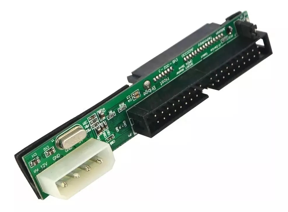

Hello Dears.... I haven't had time to mess with the device yet, change the IDE HD, etc.
Well, I'm thinking about buying an IDE connector for a SATA HD, or SATA SSD, because, as you know, this model uses an IDE HD.
[Attachment 86371 - Click to enlarge]
So, I'm thinking about buying this adapter, like the one in the picture or maybe one that fits better on the device and connecting to a SATA HD or SATA SSD to it.
Would it work? -

I never had success with using such converters. If you are going to try that anyway, I recommend using SATA SSD
Good luck. -

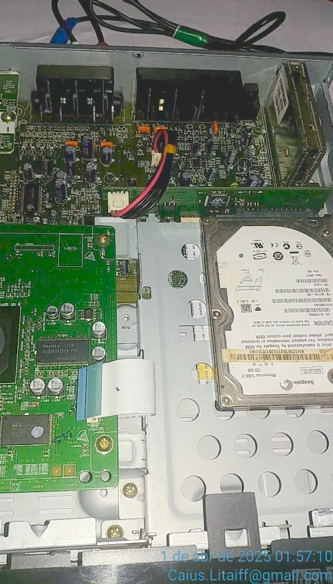

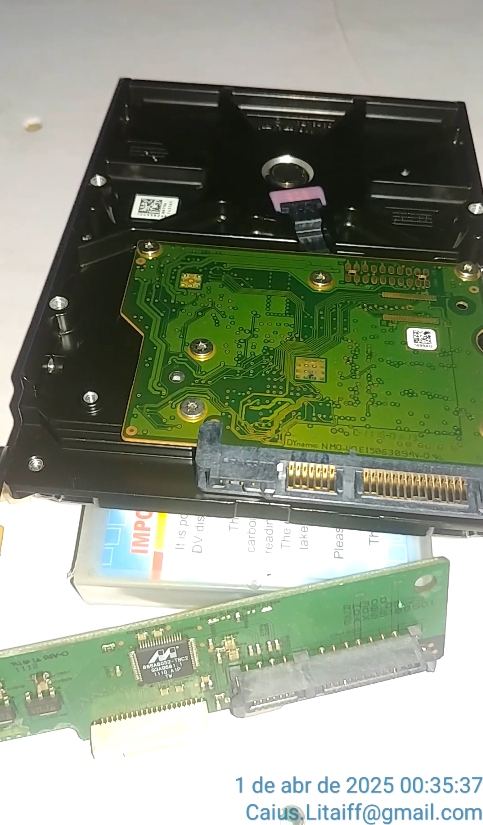

Updating! So, I disassembled it here, very carefully, and managed to remove the HD. To my surprise, it is a SATA HD, I thought it was an IDE HD. Well, Even better then!
I disassembled the HD board, it was a bit oily, I cleaned the connections, put the board back in and tested it on my computer. Again, no sign of life on the HD, just a "crack" sound, it doesn't even appear on the computer.
Back to the recording device, I tested two different notebook SATA HDs on it, both had files and one had a Windows operating system, and the recorder didn't work properly again, it just kept showing the "Hello" sign on the screen and that's all.
I'm going to look into whether if it needs to have some software previously installed on the HD to get it working normally again.
If anyone here has any advice, I thank you.

I suggest that you try to connect the original HDD to your computer using a SATA-USB adapter if you have one and check it. You might not get anything because the OS of the recorder might be a Linux or the recordings encrypted because of copyrights.

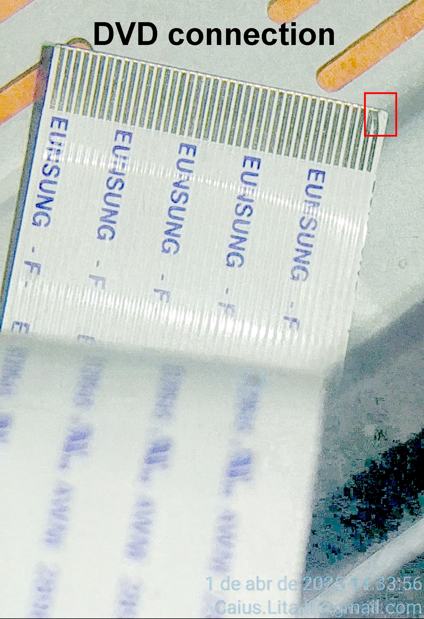

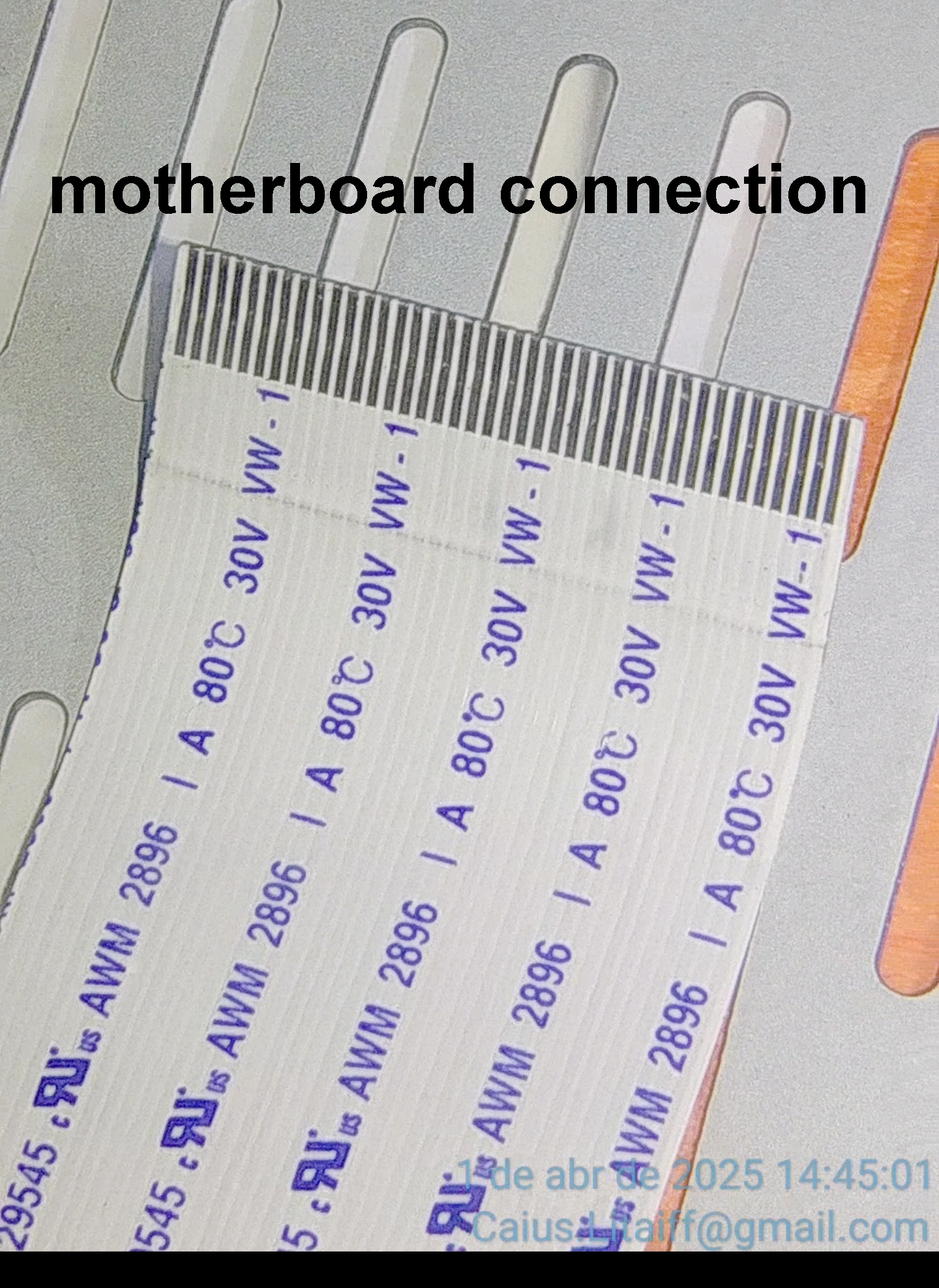

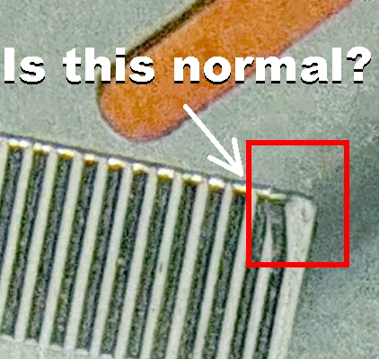

So, moving on here. I have now checked both ends of the flat cable coming out of the DVD part.
Then I found this part of the flat cable that comes out of the DVD unusual, there are two lines that appear to be joined together, (see the picture). Could this be a defect or is this normal?
In the other photo of the other end of the flat cable that connects to the motherboard, everything is fine.
