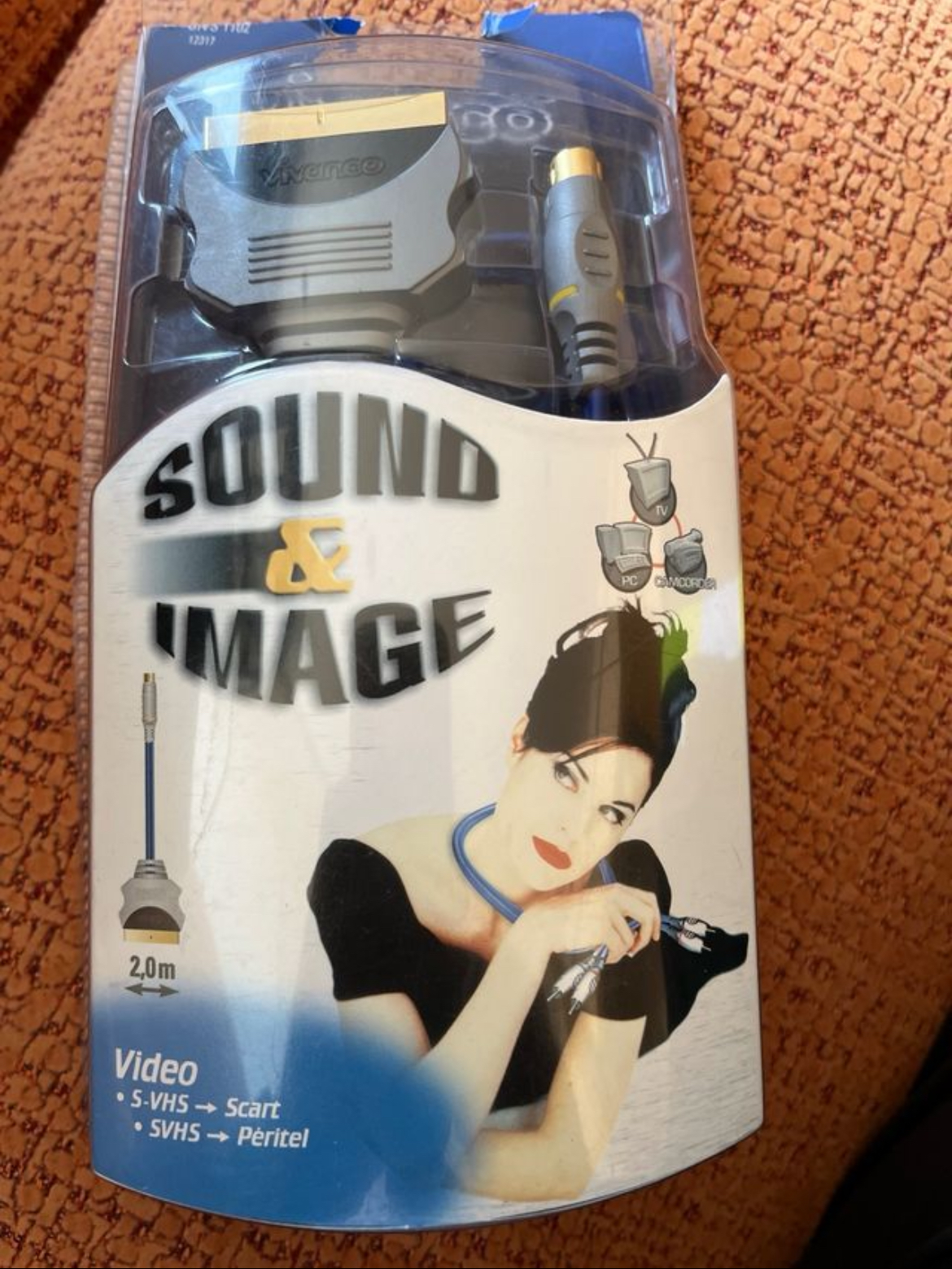

I will definitely buy a s-video to SCART cable since is way more easy than trying to find the right component cable for my camera.
This is the type of cable I’m going to buy:
[Attachment 84211 - Click to enlarge]
