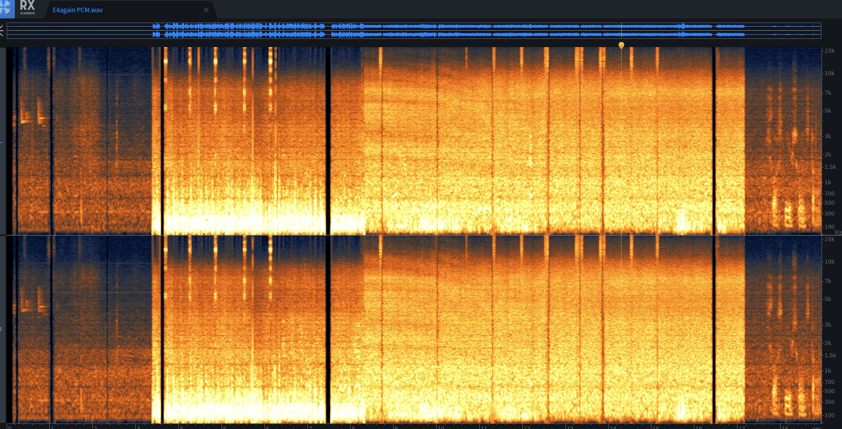

    The avi file's PCM audio is badly clipped (overloaded) in one section due to the low frequency wind noise into the camera mics. See the bright sections a short way into the clip. The squeaks only occur in that clipped section. Possibly any audio conversion at editing has not helped. Audio compression like mp3 doesnt like converting clipped or even close to clipped audio. You could try in your video editor reducing the gain of the original audio by say 3db and see what happens when you render to a new file. Hopefully it will be no worse than in the original camera avi.
Name:	RX screenshot avi audio.jpg
