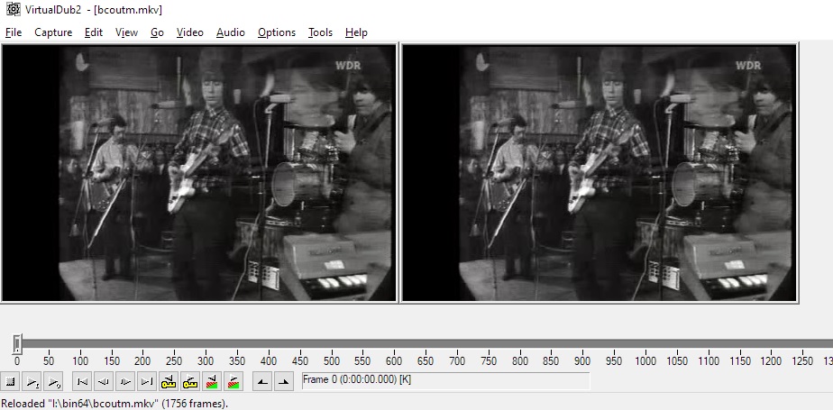

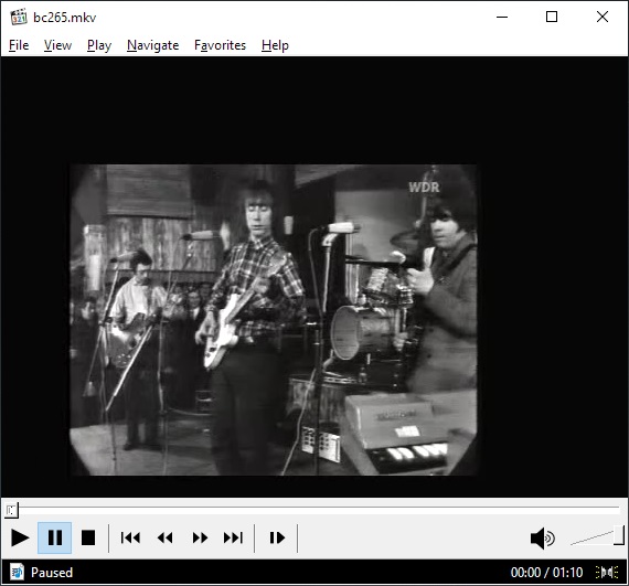

  6. The only players I found that seem to do the cropping correctly are SMPlayer and Windows 10's built in media players.
    Mar 2008
    I couldn't get crop_left to work at all, anything specified other than 0, the output would not open in Vdub2, nor
    display the selected crop in wmplayer - although it played. Top, right and bottom worked OK
    ffmpeg -i "c:\users\davex\desktop\bc265.mkv"  -bsf:v hevc_metadata=crop_left=0:crop_right=132:crop_top=96:crop_bottom=20 -c copy -y  bcoutm.mkv
  8. Originally Posted by davexnet View Post
    Thanks for experimenting. I've tried a dozen script combinations. Can't get anything to really work.
