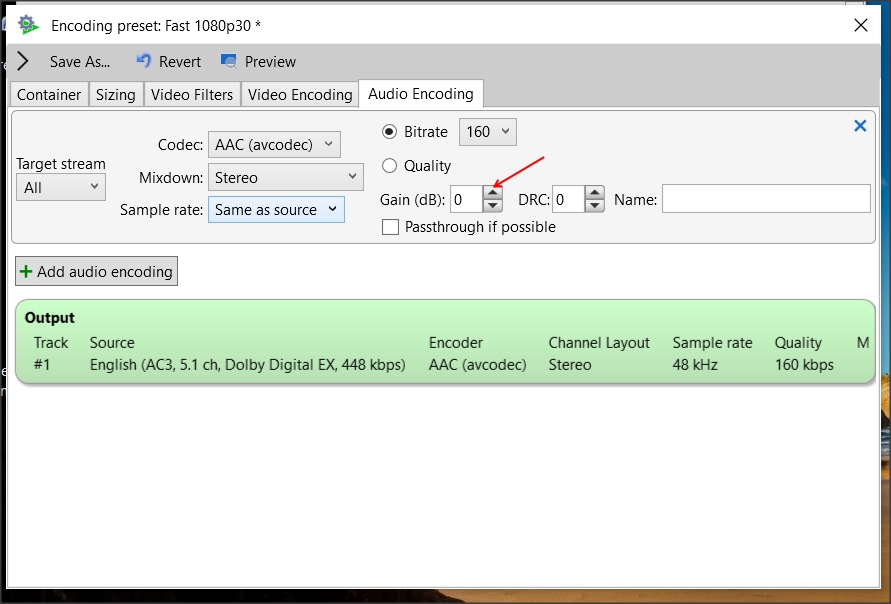

Thanks johnsO, it's a great app! One question (now you knew that was coming, right?
[Attachment 84096 - Click to enlarge]
The audio was so I could only hear it with volume turned up to max on my computer.
The help video was good, I see where the audio gain can be increased [path: Picker Custom / Custom / 1/2 audio track(s): English / Pick the "gear" icon / Gain(dB)
[Attachment 84097 - Click to enlarge]
Can you give me a good setting number that you think is standard for a video? It would save me a lot of encodings to find a good setting.
Thanks for your help, much appreciated. -
I have not used vidcoder.
I did observe this from the image:
You went from AC3 5.1 448 kbps to aac stereo 2 channel 160 kbps.
maybe johns0 can tell you how to keep the original audio with vidcoder.
I believe that will have as good of audio as the video did before the conversion. -
To keep the original audio in the settings panel choose passthrough.
I think,therefore i am a hamster. -
Thanks to all again, appreciated. Passthrough sounds like he easiest way to start.
