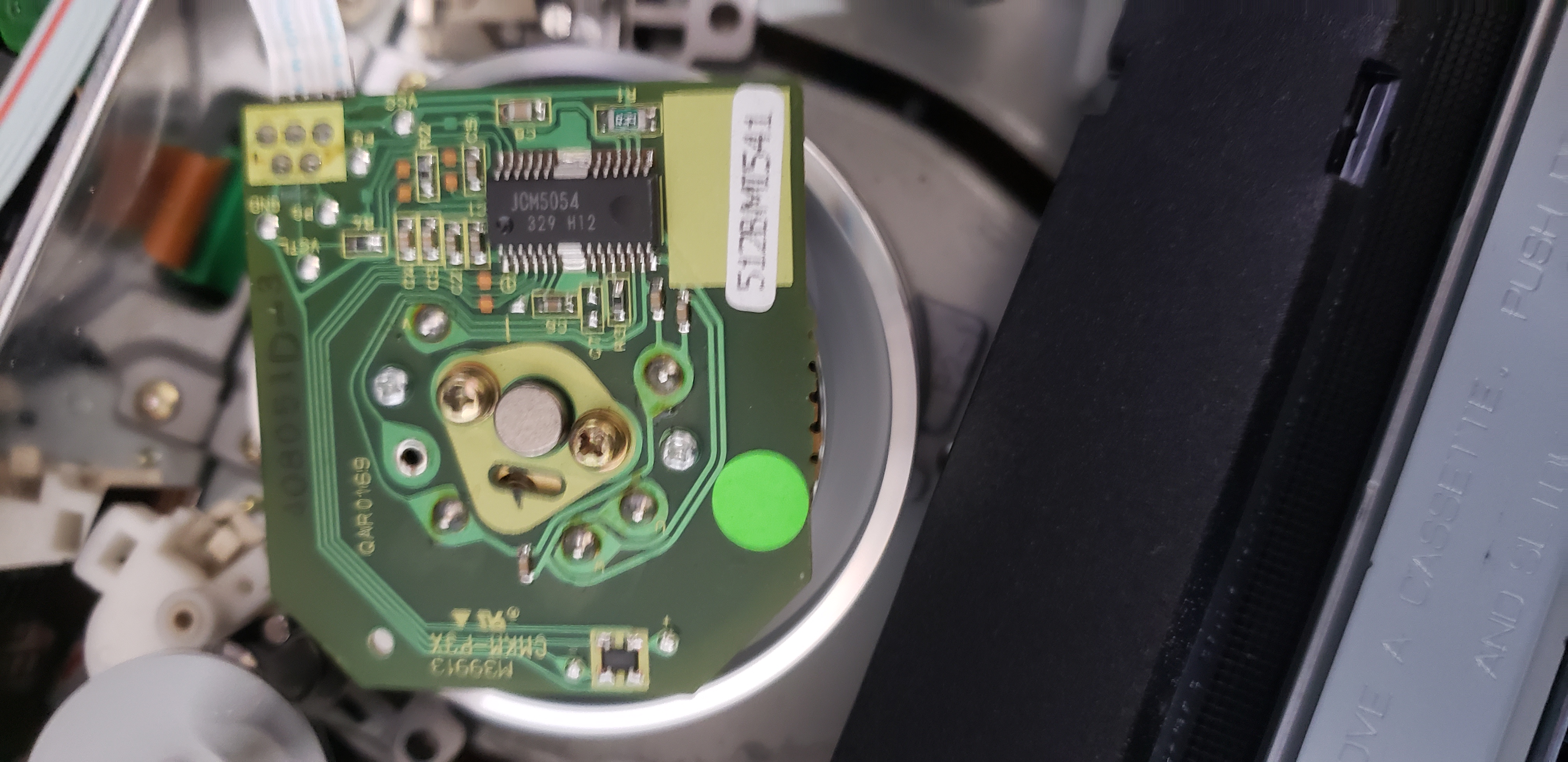

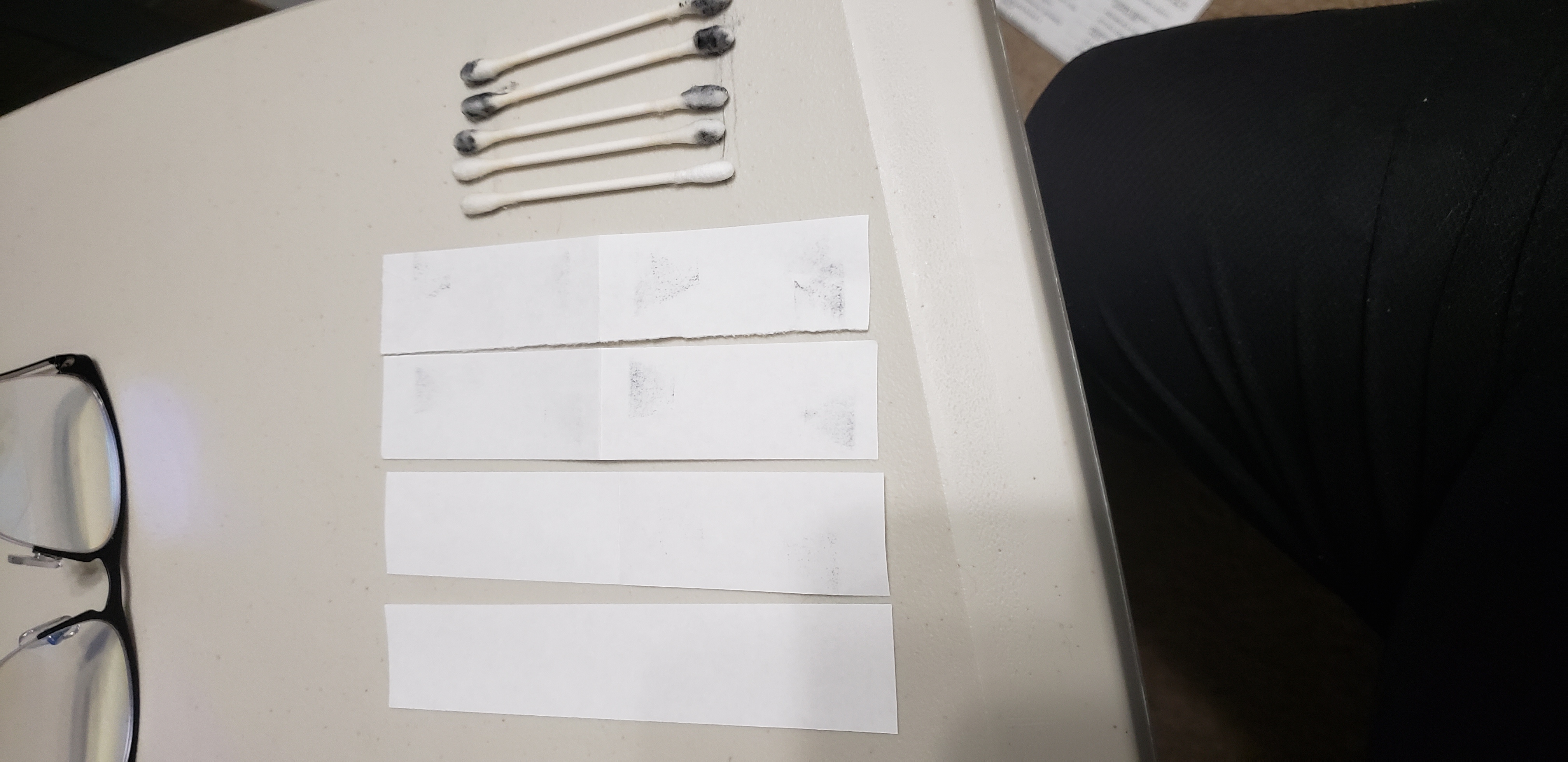

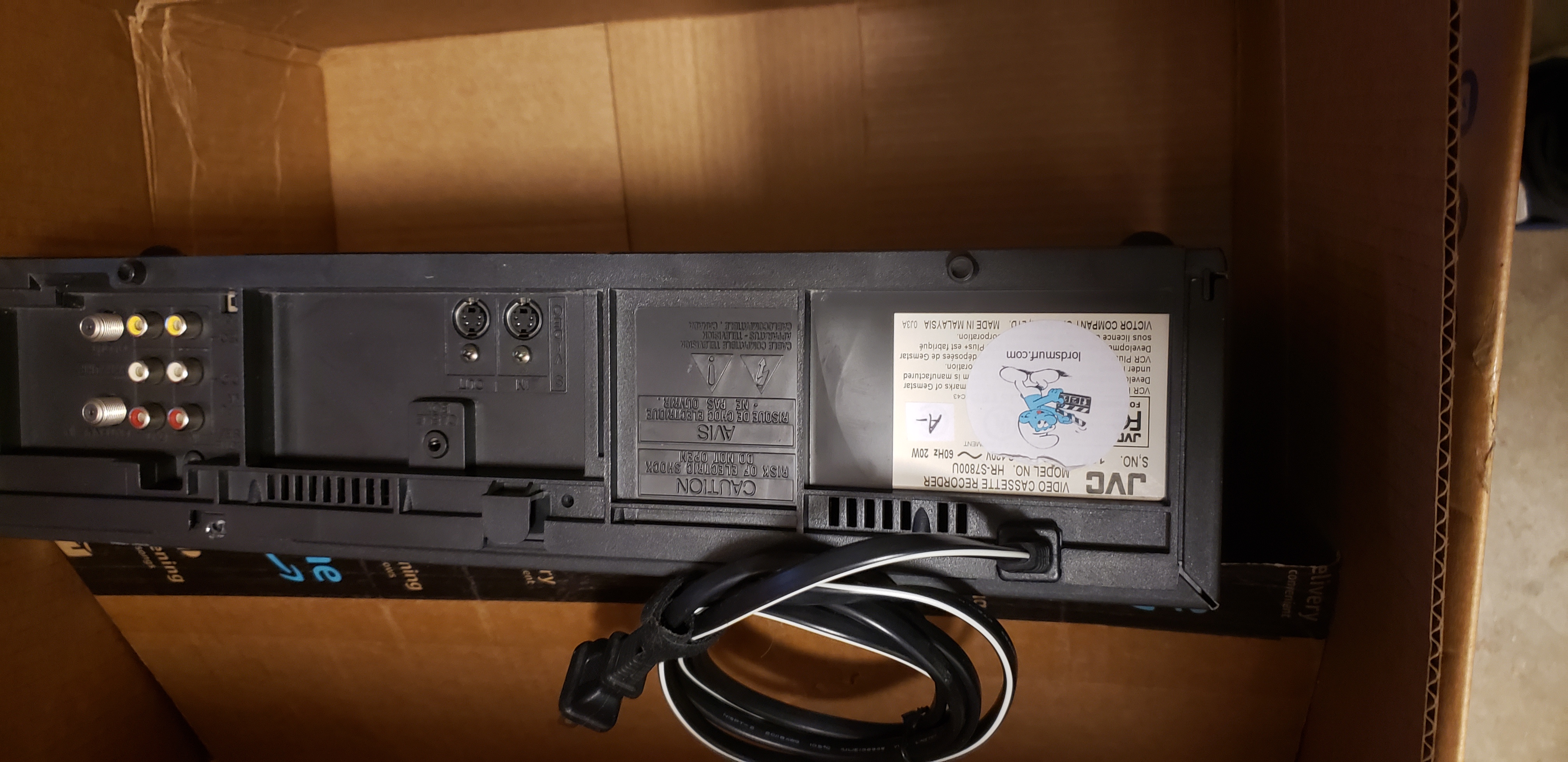

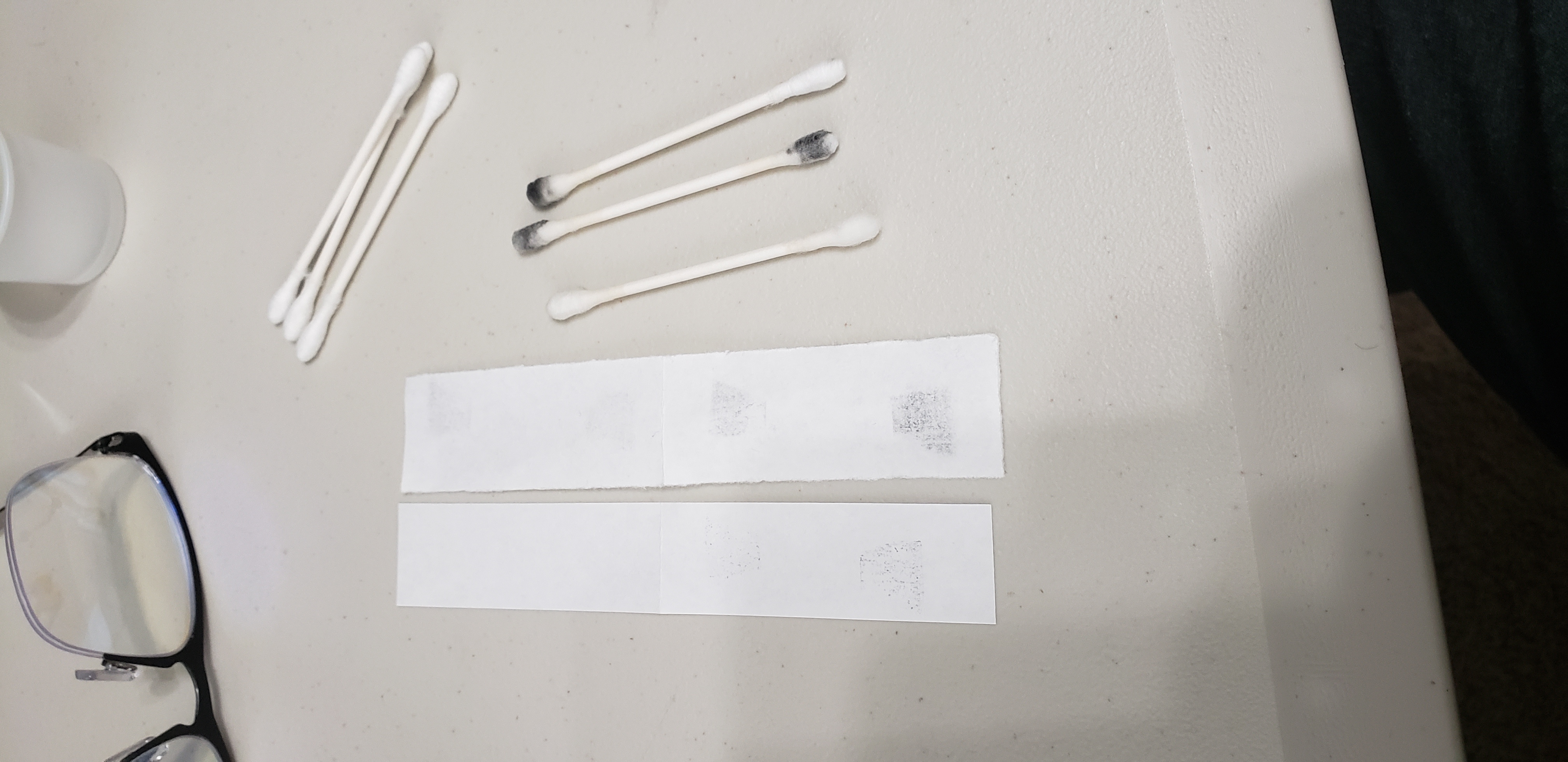

  21. Following up…
    My “parts” (one JVC HR-S4800U) arrived yesterday. Packaging was done with care, I put it through its paces and am very happy with this find.
    Purchased the 4800 for parts for two of my 7800’s.
    VCR #1… I had serviced for a squeaky drum. A non- 7800 drum and stator was used for a replacement. I wanted to get this VCR back to stock. See attached.
    Attached VCR #1 pictures,
    20241210_041716
    20241210_041721
    20241210_042732
    20241210_073901

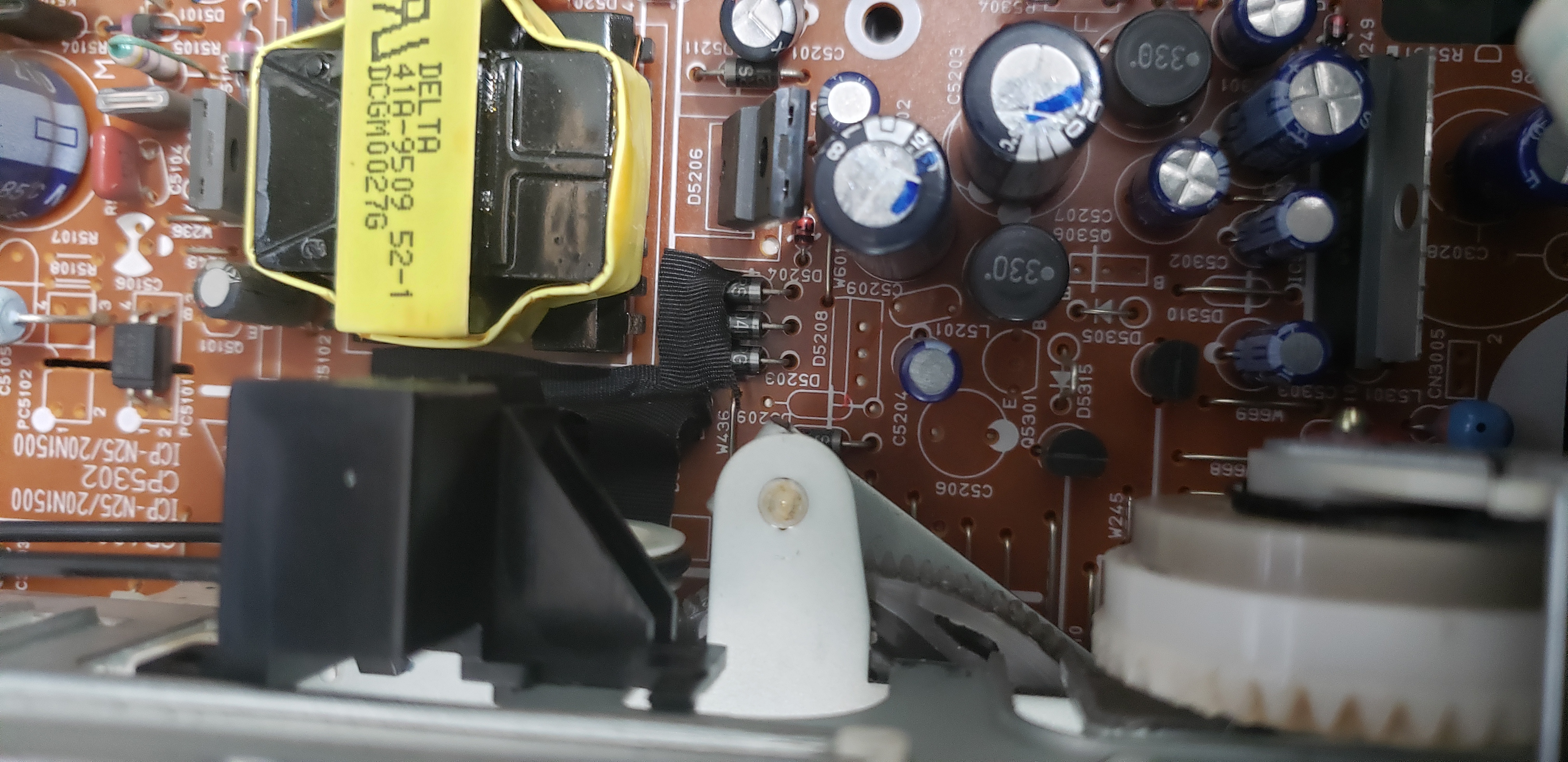

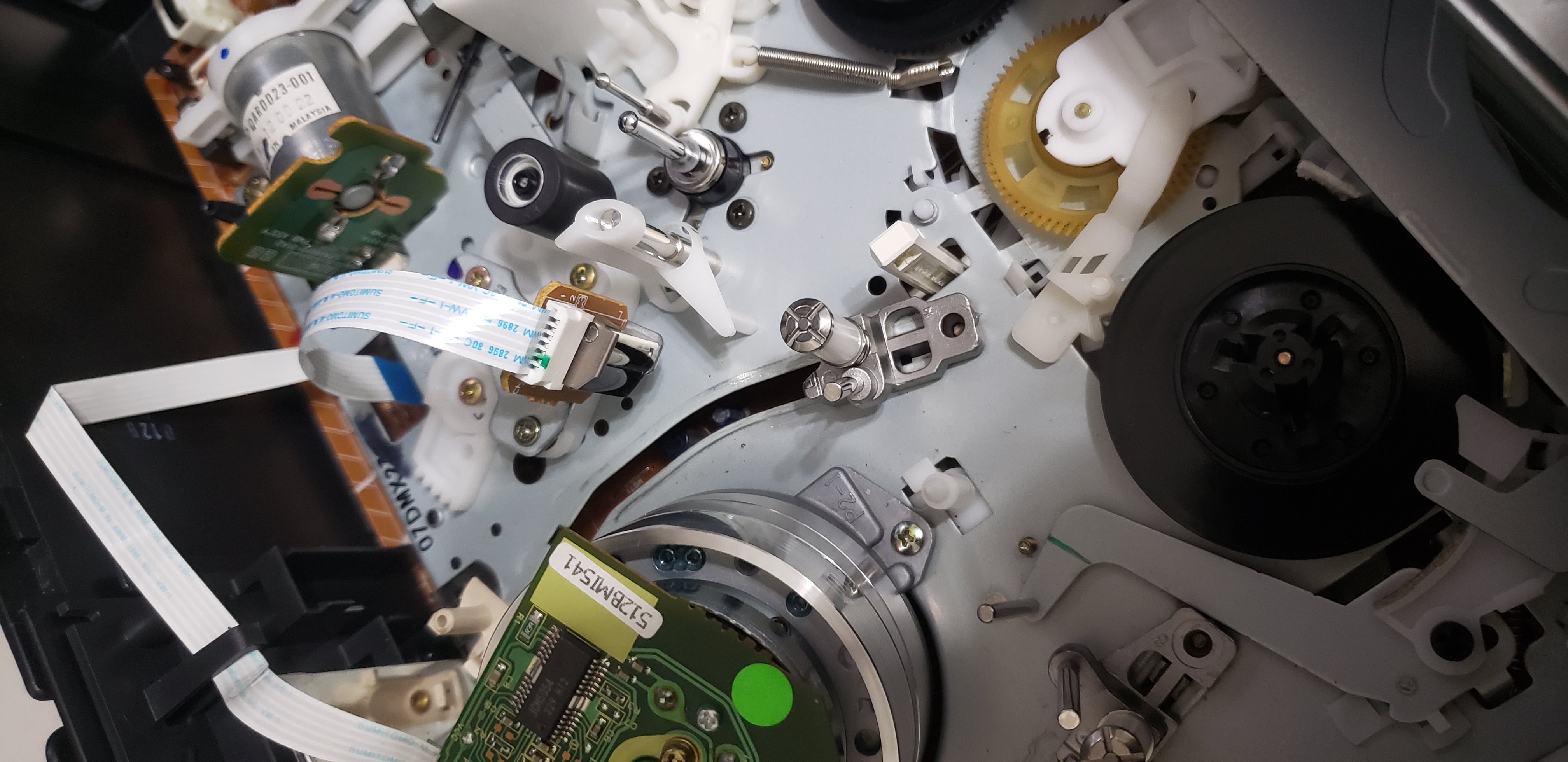

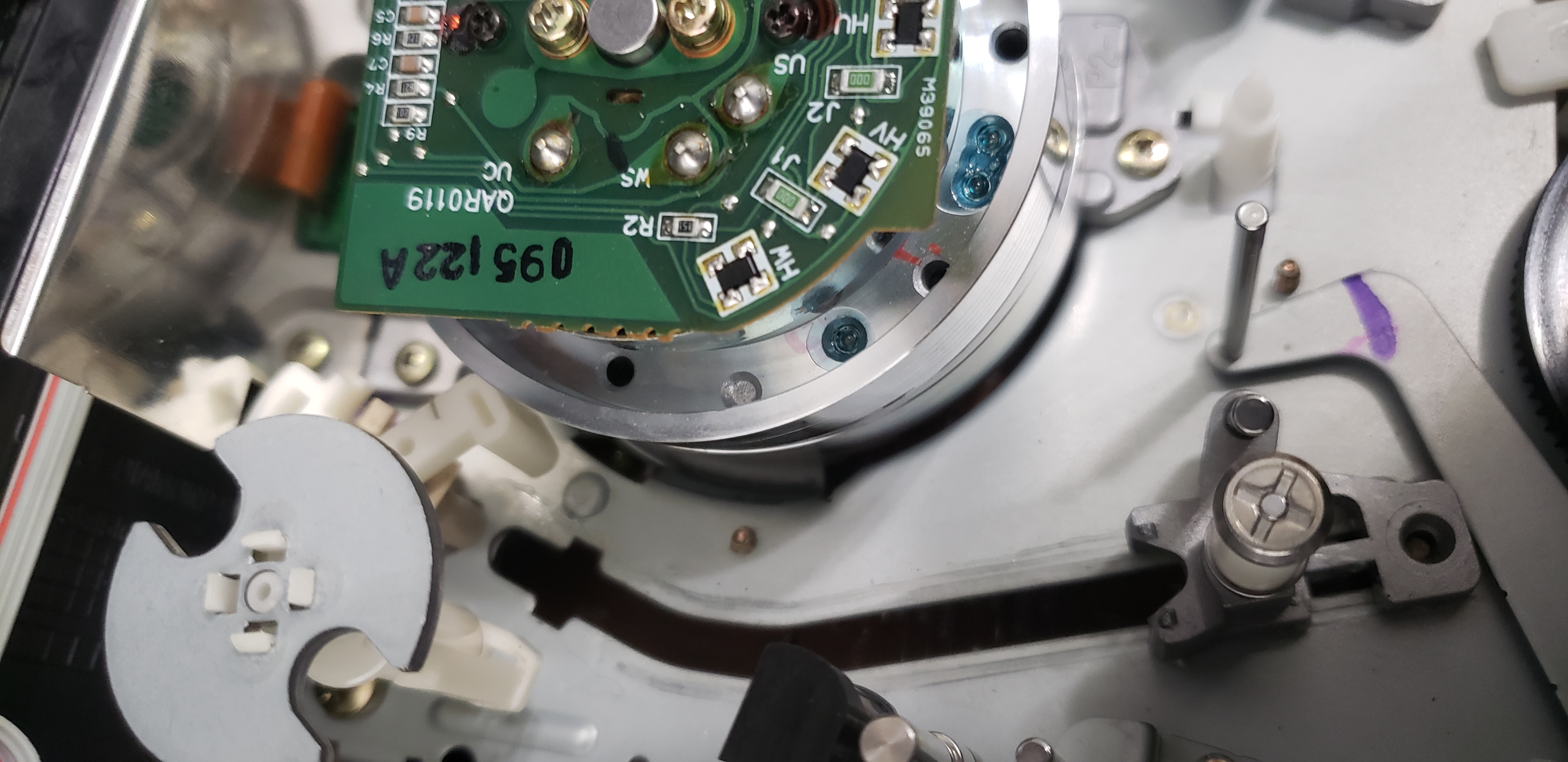

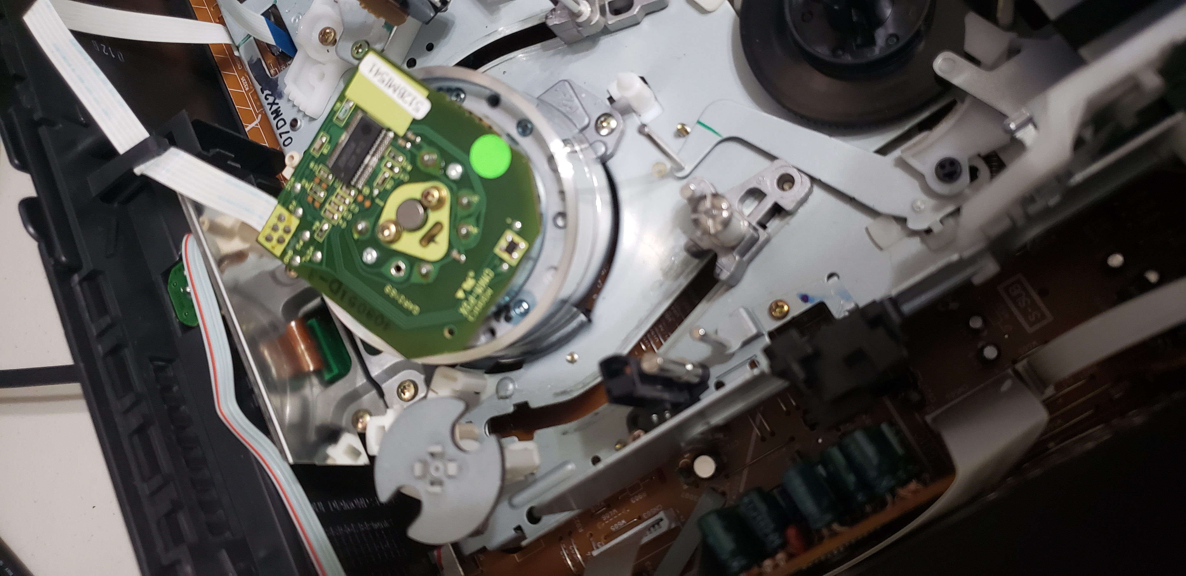

    VCR #3… Was suffering from “ghost loading/ejecting” (not sure if is the tech. description). I had it serviced, according to the tech. found the cassette basket had shifted and was rubbing on the circuit board (don’t know, I’m not a tech.). Repairs were made, all better now. See attached.
    Attached VCR #3 pictures,
    20241210_100509
    20241210_100515
    20241210_100521
    20241210_101948
    20241214_075105
