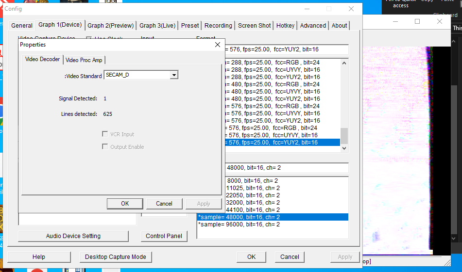

    I have this weird problem after upgrading to WIN10 from WIN7.
    I'm using amarectv with AverMedia C039 capture card.
    The Video Decoder suddenly changes to SECAM instead of PAL.
    The colors are changing from normal to blue-purple lines.
    Even on VirtualDUB when going to Capture Pin I see SECAM, I change it to play, play a tape, then it goes back to SECAM after few min.
    Is there any way to set it up ALWAYS to PAL_B?

  2. Captures & Restoration lollo's Avatar
    Jul 2018
    Italy
    Reinstall the drivers of the card specifying PAL while doing that
  3. I did, Never asked me for PAL or input type.
    Just exe file which installs files.
    May 2005
    Australia-PAL Land
    To confirm, it's changing during a capture?
    You could try setting up the capture settings with GraphStudio (open it after you have AmarecTV or VDub open); it may "hold" the settings.
    Using Graphstudio is a straightforward setup; I have written a guide for it here.
    You can also try a reset of the Amarec settings but I don't think that will help as you're also having trouble with VDub.
  5. Originally Posted by Alwyn View Post
    Yes exactly.
    The video is ok then after some time I see blue-purple colors. I stop the capture and see it's on SECAM settings.
    I will try GraphStudio and update.
    Thanks!

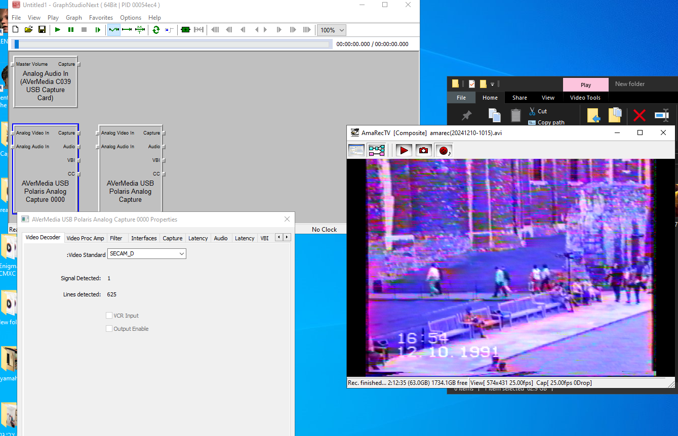

  6. Well
    I left it on, And it was Changed to SECAM again!
    I see the colors, when the GraphStudio was open it showed PAL but when I notice changes in the color, I clicked on properties again and saw it is SECAM.
    I can see it goes like that on some tapes when the signal is lost for 1-2 seconds, Like someone recorded different content on it, or another date. Then it happens.

    May 2005
    Australia-PAL Land
    Hmmm, that's weird. I'm stumped.
  8. As a test force "Secam out" on your vcr rather than auto or pal/secam and see what happen
  9. Capturing Memories dellsam34's Avatar
    Jan 2016
    Are you sure it is not your VCR that is switching format? If you have a multi standard VCR set it manually to a format instead of Auto.
