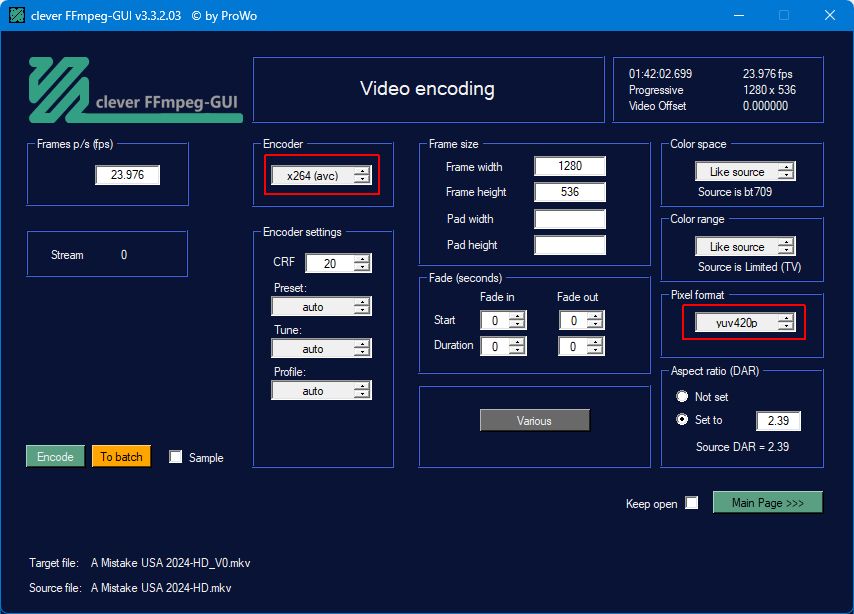

  2. Hi Lathe,
    you could try to render it to h264, 8 bit.
    [Attachment 83967 - Click to enlarge]

    Yessir! That is exactly what I did with your fine program... At least I THINK that is what I did. But, it's not your program that is at fault (at least yours loaded and processed it, BDRB choked on the HEVC file) But yeah, that is pretty much what I did. I guess it has something to do with how VLC Player is interpreting it or something, it's kind of weird. That's why I was hoping that someone like you or other experienced people would see the snapshots and recognize what was going on.
    BTW, since I wasn't doing an HDR-SDR conversion, it didn't offer the 'Various' choices where I would normally select 8-bit. So, I was GUESSING that it must automatically convert it to 8 bit when converting to AVC, is that right? I'm out of my depth here as to why the picture is being rendered that way... Yes, I just checked the resulting MKV file with MediaInfo, and it has an 8-bit depth.

  4. Originally Posted by Lathe View Post
    No, if the source is 10 bit and you leave the pixel format at auto, then the encode ist done with the source bit depth, in this case 10 bit.
    if you want 8 bit, you have to select it explicitly.

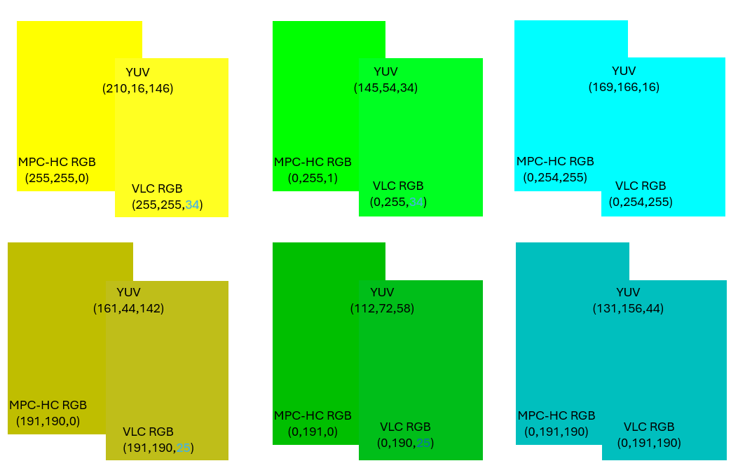

    Once we are at it, here a comparison MPC-HC vs VLC. Scratching my head why VLC outputs different RGB values for certain colors (blue component in the VLC figures). Can't be a 601 vs 709 matrix issue IMO (?). The differences can hardly be spotted by eye though, so it doesn't really hurt. Just wondering.
    Any thoughts?

  17. That's a difference in the rendering device. Different players are using different renderers using different hardware and settings. In VLC go to Tools -> Preferences -> Video -> Output. Try the different renderers. Windows GDI (VLC will do the color conversion in software) should give the correct results. Also use your graphics card's setup applet to check/change video properties. Disable all "enhancements" and "auto adjust" settings.
    Ahhh! The renderers! I totally forgot about this variable in the equation, as with my current setup/configuration MPC-HC always delivered the expected results for various color manipulation tests. Now out of curiosity giving VLC a shot and ugggh ......
    Thanks for pointing this out.
  22. On my computer, the Direct3D11 renderer delivers slightly wrong colors. The Direct3D9, DirectX, Open GL, and Windows GDI renderers are all good. Automatic ends up using Direct3D11.
