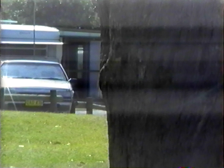

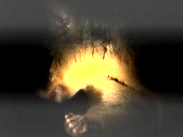

    Is there any way to detect and reduce the brightness of just those areas so they match the average of each frame/consecutive frames? Free software only please.
    I've tried deflicker but that doesn't seem to do anything, because it's not that flickery, more a stable-ish like halo(depending on how much the camera or objects move around) thing in consecutive frames portions of the video.

  2. Are these bars on the original tape when you view it on your monitor, or do they only appear in the captured video?
    Do they roll or move? If they move like hum bars, I was able to devise a way to remove them, as you can see in this before/after, showing how I massively improved an amateur attempt at doing a Kinescope by just pointing a movie camera at a 1950s television set:

    I think they appear on the captured video only, they don't roll or move in a consistent manner, they stay stable as long as what's shown on the screen is stable.
    Yeah I found that post before, because mine wasn't rolling I thought it wouldn't work with that fix.

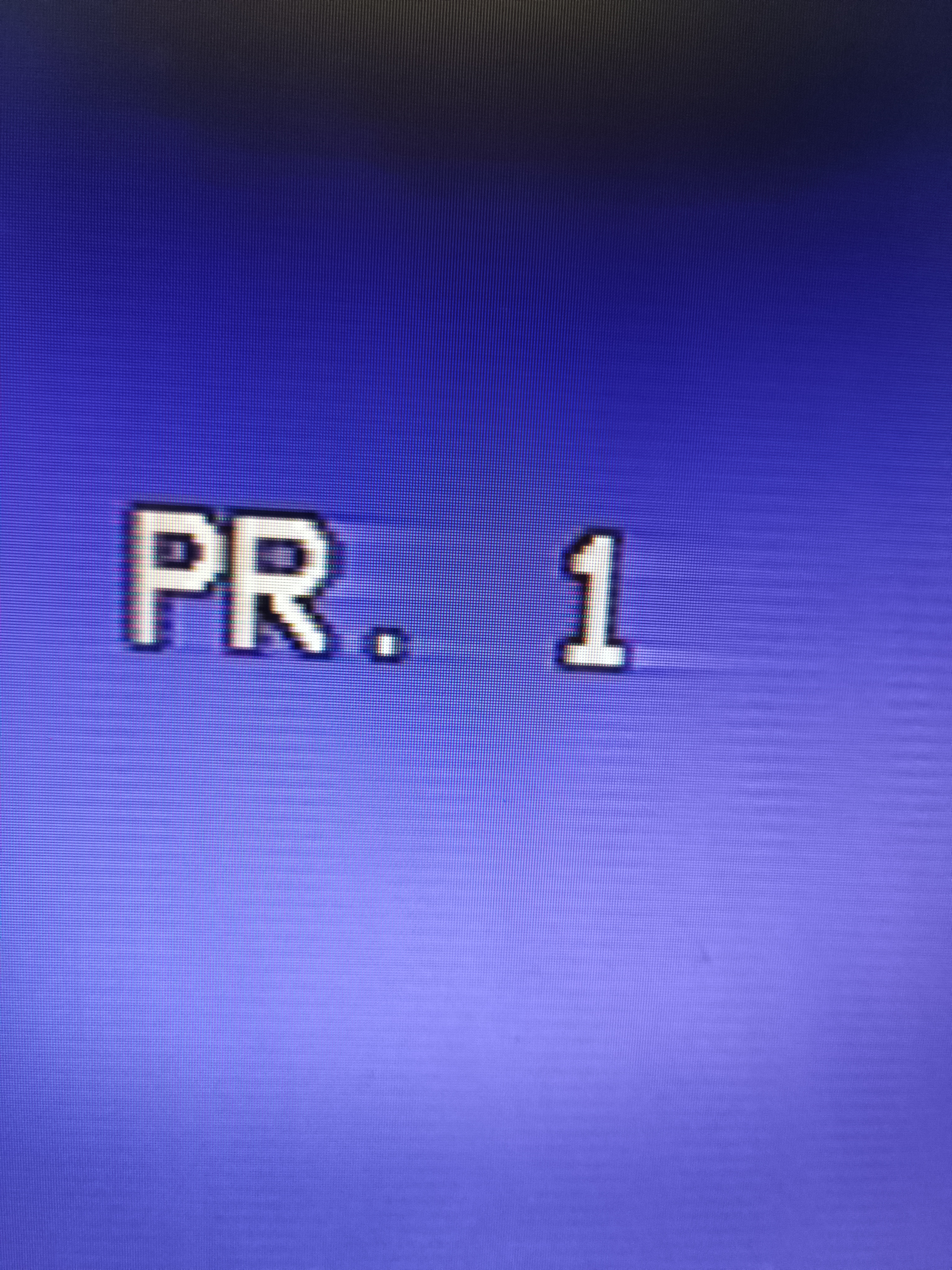

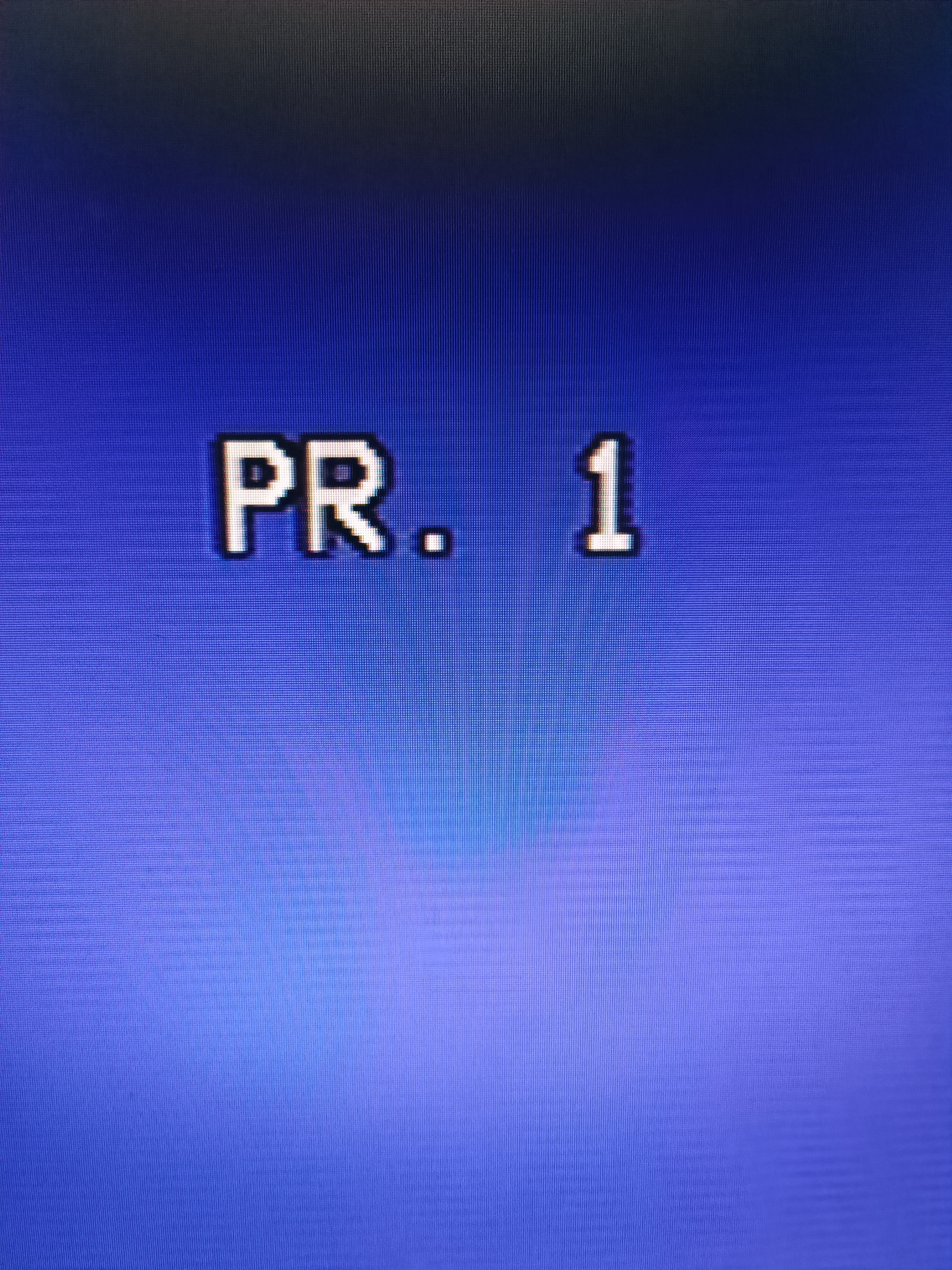

  11. After messing around with ground loops, moving all things over even monitor to one outlet and unplugging non essential USB devices. Tried multiple cables, other VHS player....nothing changed.....until I decided to try out composite plug instead of S-Video. Composite didn't have that smearing at all, so it turns out that S-Video on my Capture device is no good.
    I noticed the smearing on the onscreen white text on the VHS players when not even playing any tape, doesn't occur on composite input.
  12. The artifact in post #12 looks different than the original post #1 artifact. This one shows ringing. It sure looks like a cable issue, but you said you replaced cables, and I assume that included the S-Video cable.
