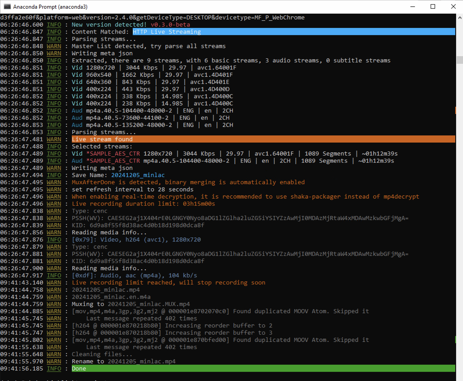

    Here are the terminal outputs of scripts that completed successfully and those that failed:
    Successful:
    [Attachment 83921 - Click to enlarge]

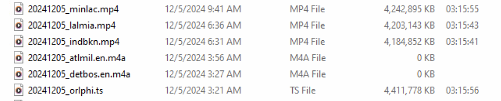

    To better illustrate the timing issue, I am sharing the creation timestamps of both successful and failed stream files:
    [Attachment 83924 - Click to enlarge]
    [Attachment 83925 - Click to enlarge]
    Interestingly, the timestamps of the failed stream files show creation dates from 10 years ago, which surprised me. I wonder if this could be a clue to the issue. Additionally, the MP4 files that yielded by problematic download scripts cannot be played.

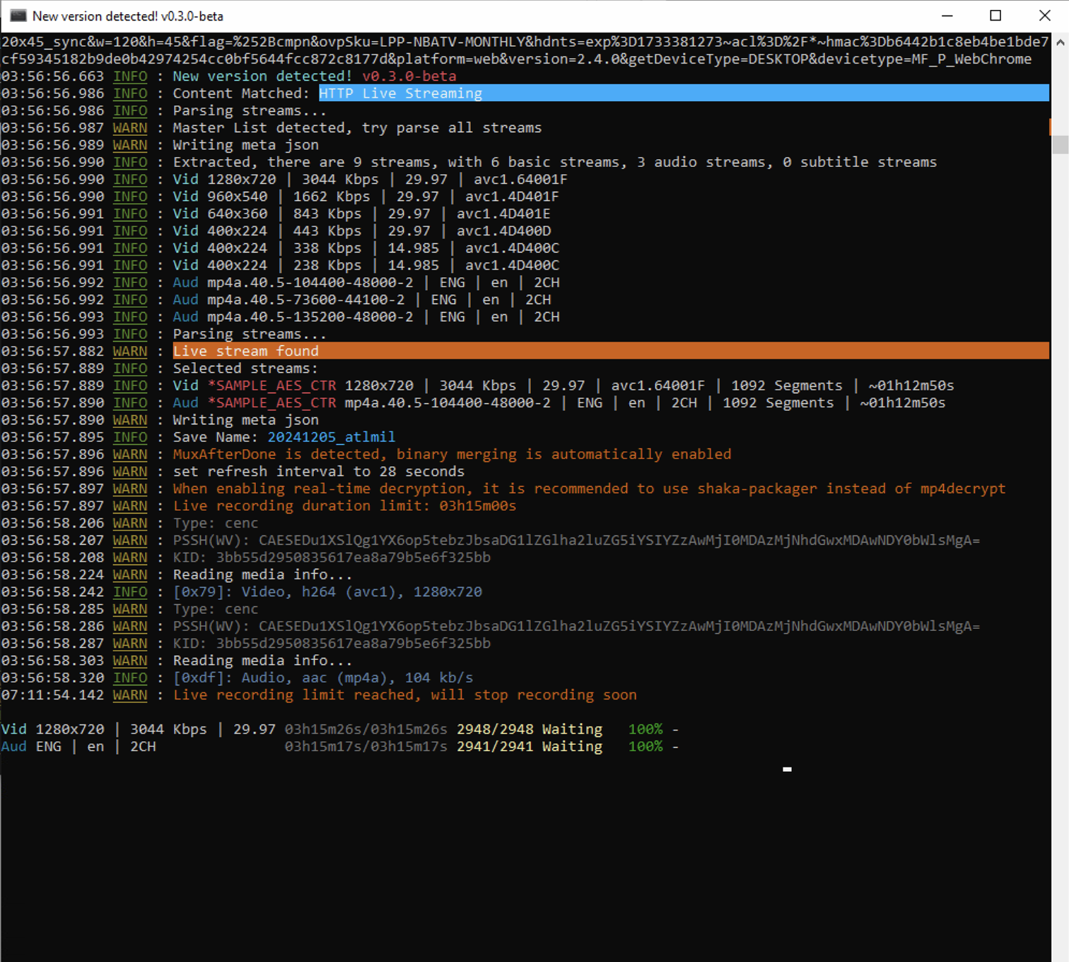

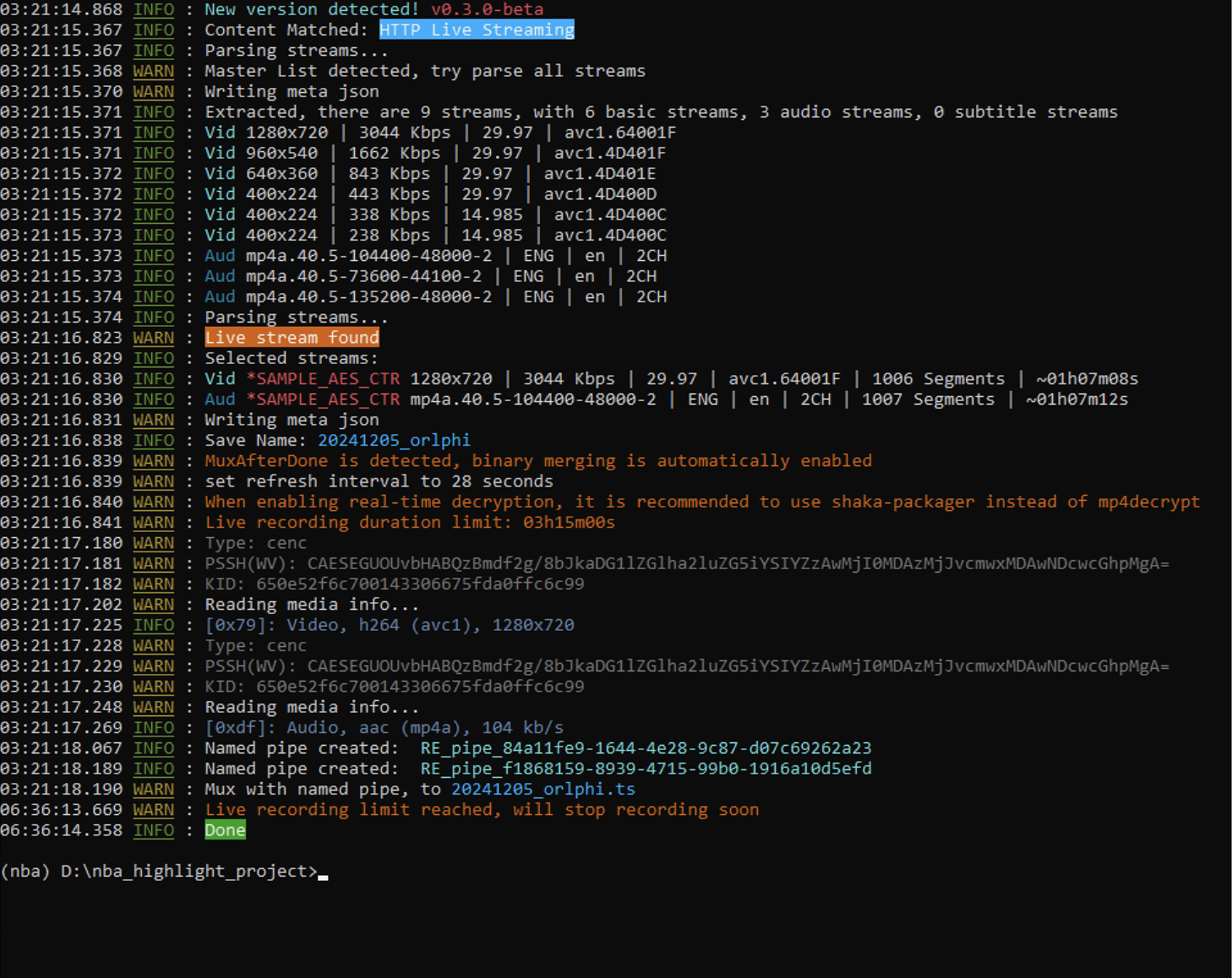

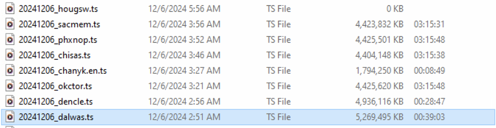

    New Approach:
    I modified my download script as follows, which successfully produced a .ts file for the stream(EVENTHOUGH I TRIED TO FORCE IT TO BE MP4 FILE), which is surprising. However, I haven’t had the chance to test this approach on multiple simultaneous live streams yet.
    def download_m3u8(m3u8_url, key_id, gamename, formatdate):
        n_m3u8dl_path = r"C:/Users/username/Desktop/N_m3u8DL-RE_Beta_win-x64/N_m3u8DL-RE.exe"
        command = [n_m3u8dl_path, m3u8_url, "--save-dir",
                   "2425", "--save-name", formatdate + "_" + gamename,
                   "--append-url-params",
                   "--mp4-real-time-decryption",
                   "--live-pipe-mux",
                   "--key", key_id,
                   "-sv", 'res="1280*":for=best',
                   "-sa", "lang=en:for=best",
                   "-M", "mp4",
                   "--live-record-limit", "03:15:00"
        subprocess.run(command)
    [Attachment 83922 - Click to enlarge]
    If anyone has encountered this issue before, has suggestions for a solution, or can recommend an alternative approach, I would greatly appreciate your insights.

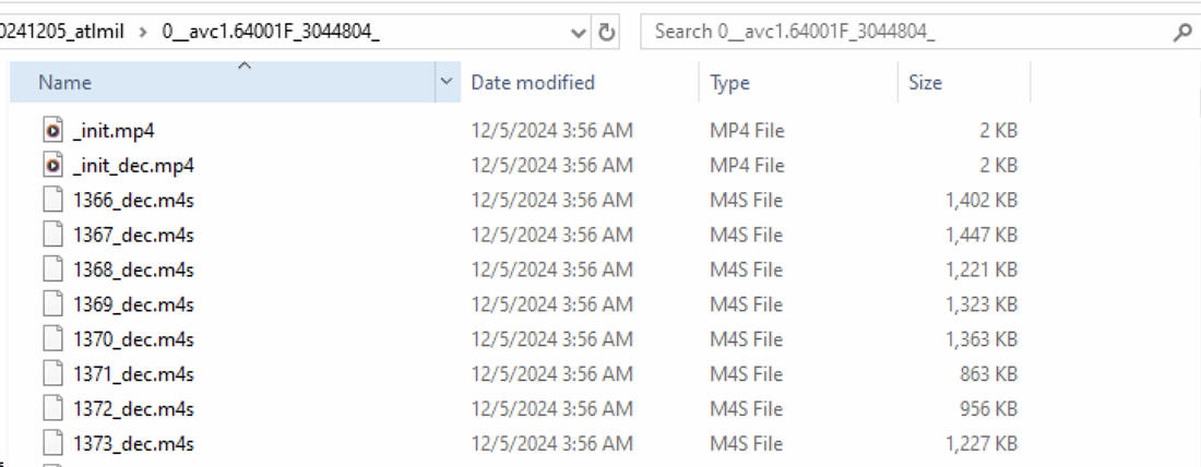

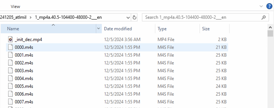

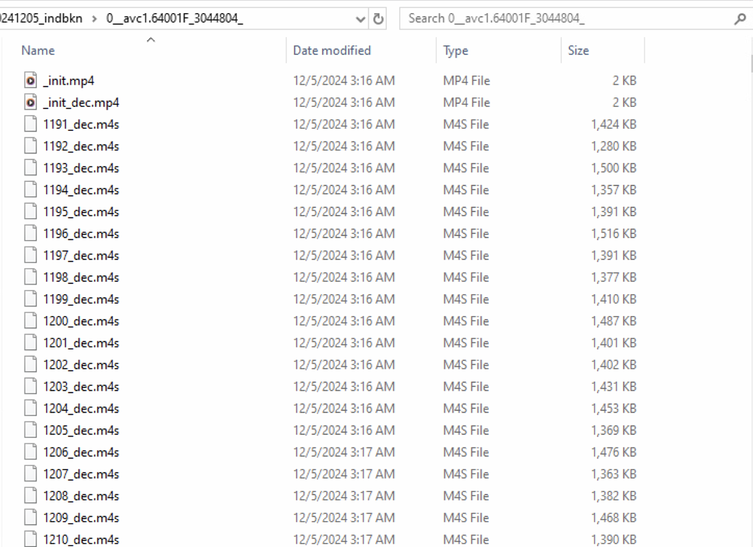

    Let me share some snaps from the stream folders for successful and problematic cases:

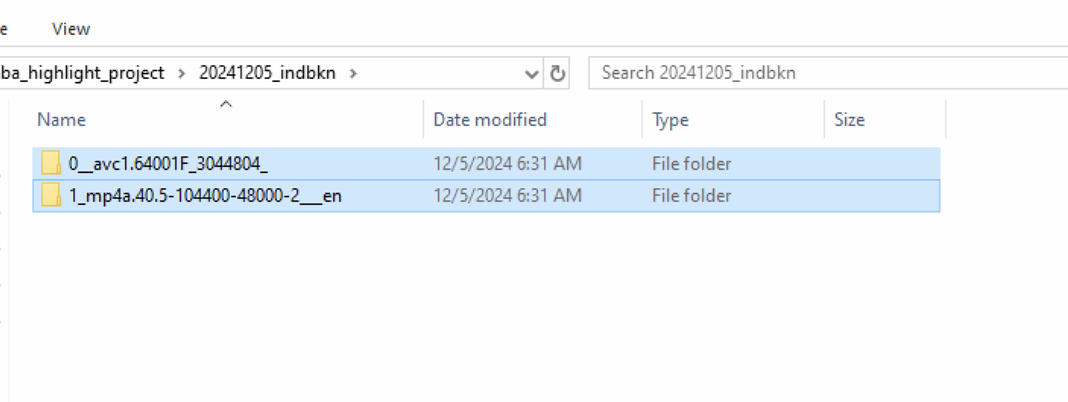

    Successful:
    [Attachment 83952 - Click to enlarge]
    [Attachment 83953 - Click to enlarge]

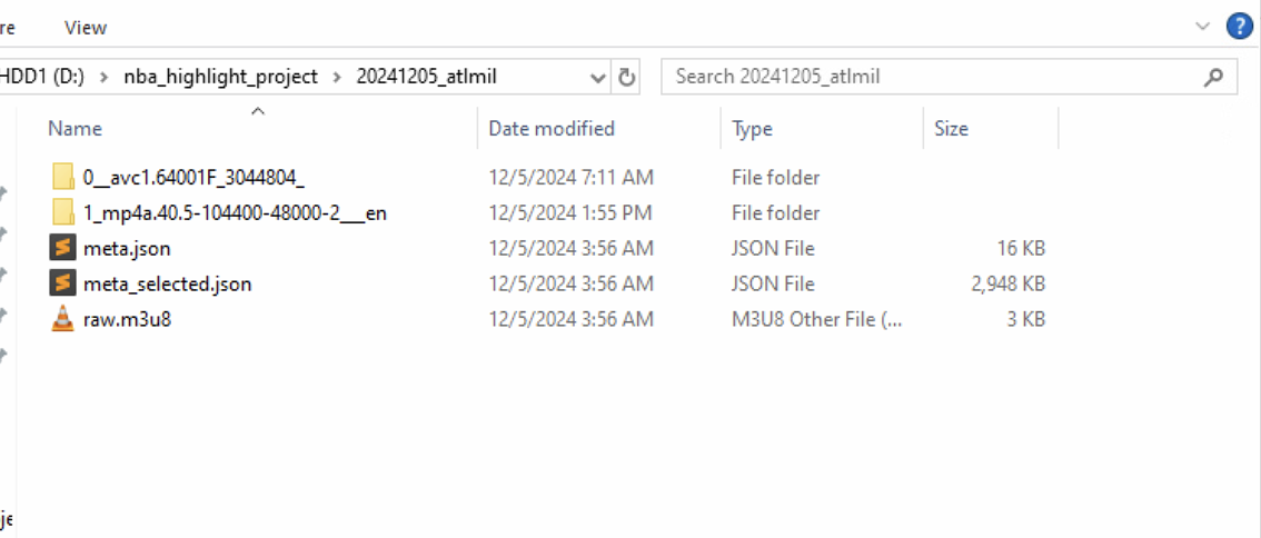

    Problematic:
    [Attachment 83954 - Click to enlarge]
    [Attachment 83955 - Click to enlarge]
    Things getting more interesting in here in my opinion. "_dec" id's seems more reliable for audio segments(folder name: 0__avc1.64001F_3044804_)
    However, .ms4 file id's at video segments folder(1_mp4a.40.5-104400-48000-2___en) are not consistent. Some of them are not decoded(I assume _dec is the abbreviation for "decoded"). Also, it seems like some of the files are decoded twice???(files that end with "_dec_dec")
    [Attachment 83956 - Click to enlarge]

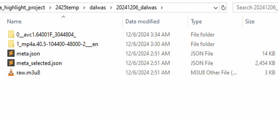

    To be precise, here is the modified version of the function:
        if not os.path.exists(r"2425temp/"+gamename):
            os.makedirs(r"2425temp/"+gamename)
                   "--tmp-dir", "2425temp/"+gamename,
                   "--save-dir", "2425",
                   "--live-pipe-mux",
                   "--key", key_id,
                   "-M", "mp4",
    If I am still missing something please inform me.

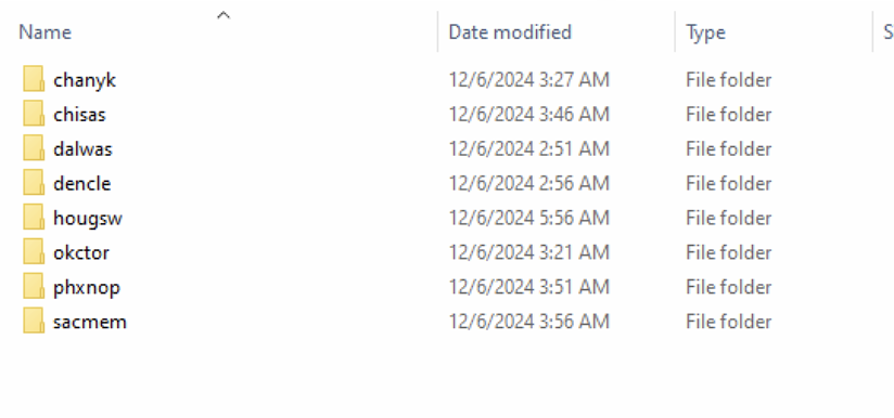

    Nothing changed. Problem occurs as the same as I mentioned above. First three streams are good then extra overlapping ones are problematic. They all have unique temp files.
    [Attachment 83961 - Click to enlarge]
    Actually, this time, first three were defective, then remaining ones good.
    [Attachment 83962 - Click to enlarge]

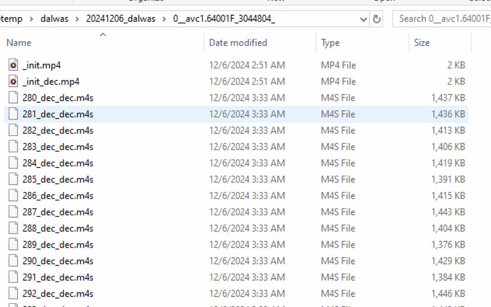

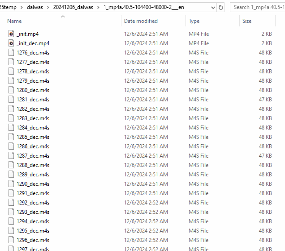

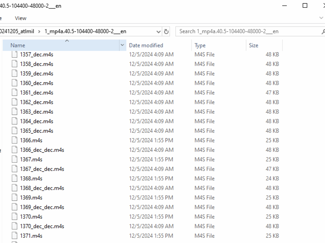

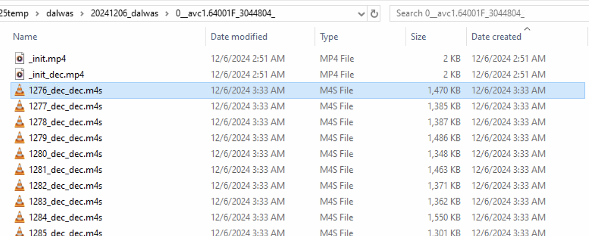

    This is the files in a problematic stream folder.
    [Attachment 83963 - Click to enlarge]
    dec_dec issue in audio folder:
    [Attachment 83964 - Click to enlarge]
    video folder does not include any dec_decs and this time the video can be played(audio is good, too). not fully obviously, just the first 30 mins.
    [Attachment 83965 - Click to enlarge]
    Here is a weird thing. All the audio files seems like created after 42 mins the stream downloading process???(This is not the case for the successful downloads)
    [Attachment 83966 - Click to enlarge]
    I think temp folder idea was a good shot, maybe but just maybe, adding one more subfolder to the path(/2425temp/blabla) collapses the process somehow?
